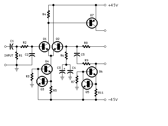

Because it's a rare amp I don't have a schematic. It's hard to guess it by looking at the PCB tracks because there's also a circuit that detects if there's DC at the output. I think the value of the trimpot is too large. The trimpot connects to a transistor. If this doesn't work I'll use a couple diodes.
I replaced a STK3062 in a Marantz PM-52SE power amp with another module. The output DC offset voltage is 0 but the quiscent current in 700mA. :o What should I do to reduce it to 70mA? Here's a list with the values of the components of the replacement module: R1______________47K 1/4W Resistor R2_______________4K7 1/4W Resistor R3______________22K 1/4W Resistor R4_______________1K 1/4W Resistor R5_____________330R 1/4W Resistors R6_______________1K5 1/4W Resistor R7______________15K 1/4W Resistor R8______________33K 1/4W Resistor R9_____________150K 1/4W Resistor R11_____________39R 1/4W Resistor C1_____________470nF 63V Polyester Capacitor C2_____________470pF 63V Polystyrene or ceramic Capacitor C3______________100uF 63V Electrolytic Capacitor C4_____________100nF 63V Polyester Capacitors C5______________10pF 63V Polystyrene or ceramic Capacitor Q1,Q2,Q3,Q4,Q5_____MPSA42 300V 500mA NPN Transistors Q6___________MJE340 200V 500mA NPN Transistor Q7___________MJE350 200V 500mA PNP Transistor STK_3042-3062-3082-3102-3122-3152_III_-_Sanyo.pdf
