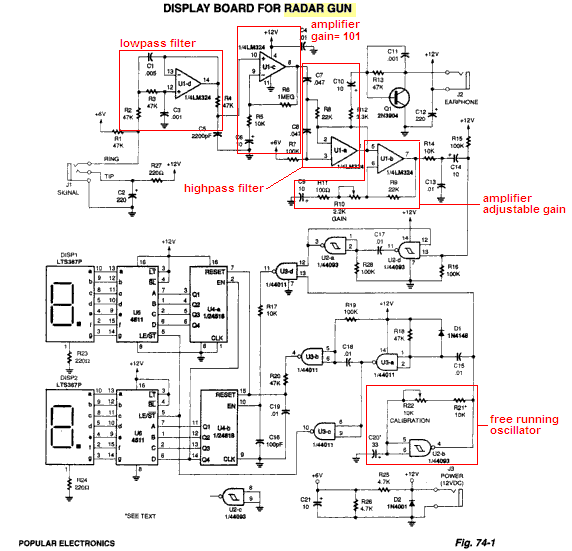

MNA Posted May 27, 2006 Report Share Posted May 27, 2006 7 what's the function of LM324(amplification or comparator or else) and 4093 here ? Quote Link to comment Share on other sites More sharing options...
audioguru Posted May 28, 2006 Report Share Posted May 28, 2006 I know that these crkts can't match with the costly made.......But why....?They are cheap and crude. A free-running oscillator is used in the display circuit and its frequency is adjusted for calibration. A real speedometer uses a very accurate quartz cryatal oscillator. 2 Quote Link to comment Share on other sites More sharing options...
MNA Posted May 28, 2006 Report Share Posted May 28, 2006 (free running oscillator in the display circuit) Can u point me where?the laser diode is receiving only the reflected frequency???? Doesn't it get mix with the transmitted frequency in air? If we have two inputs with different frequncies,is there any way that we get their difference????how can we divide by 7.76 Hz using logic ics?Why LM324 is used?I mean what is it doing? Thanx Quote Link to comment Share on other sites More sharing options...
audioguru Posted May 28, 2006 Report Share Posted May 28, 2006 (free running oscillator in the display circuit) Can u point me where?It is a Cmos Schmitt-trigger oscillator whose frequency changes with supply voltage changes and temperature changes. See my attachment.the laser diode is receiving only the reflected frequency???? Doesn't it get mix with the transmitted frequency in air?The laser doesn't shine on the photodiode. Maybe the laser is modulated with a tone and the doppler shift changes the tone's frequency, then the two tones are mixed in the receiver.If we have two inputs with different frequncies,is there any way that we get their difference????An RF mixer circuit (detector diode) gives their sum and their difference as a beat tone.how can we divide by 7.76 Hz using logic ics?A logic divider divides a frequency by a whole number.Why LM324 is used?I mean what is it doing?The beat tone is weak so is amplified. The weak beat tone has noise so is filtered. See my attachment. Quote Link to comment Share on other sites More sharing options...
