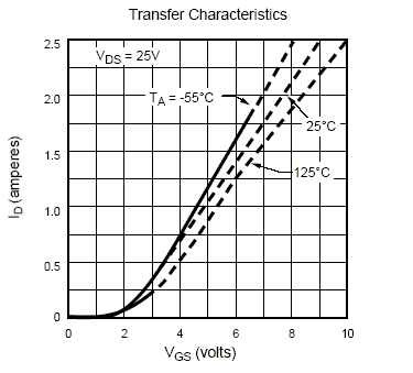

audioguru Posted April 29, 2005 Report Share Posted April 29, 2005 Hi Goatman,Welcome to our forum. ;DI'm looking for an n-chanel enhancement mode power mosfet with a really high input impendance and low turn on voltage.All Mosfets have an extremely high input resistance but a fairly high capacitance. If the input must switch at a high frequency for pulse-width-modulation control of the motor's speed then adequate current must be provided to charge and discharge it. Most Mosfets need a gate voltage of 10V to turn on fully. A few require only 5V.or a nice little non-power mosfet that can turn a relay on for me.A small Mosfet like a 2N7000 also needs a high gate voltage. A relay can't switch quick enough for PWM control of the speed. Why not use a power Mosfet to drive the motor and a transistor or two to amplify the control voltage to feed it?Did you use the double normal voltage (and therefore double the current) with an ordinary RC speed controller? Then the current was much too high for it. Replace the ordinary Mosfet with a more modern one that has a very high current rating. Then the car's motor or drivetrain will blow. :oI've been there, done that! My real car's turbo got stuck for a few days. It produced double the normal power for totally insane speeds. May that car rest in peace. ;D Quote Link to comment Share on other sites More sharing options...
Guest Alun Posted April 29, 2005 Report Share Posted April 29, 2005 audioguru,The 2N2000 only very low gate voltage, 3V is enough to allow an Id > 500mA the maximum pulse current rating.http://www.supertex.com/pdf/datasheets/2N7000.pdf Quote Link to comment Share on other sites More sharing options...

audioguru Posted April 29, 2005 Report Share Posted April 29, 2005 Hi Alun,You're relying on typical values for design spec's.Ron Mancini, a scientist at Texas Instruments agrees with me in his recent article titled, "How to read a semiconductor data sheet" in EDN here: http://www.edn.com/article/CA514964.html?industryid=2281&nid=2433He says, "Typical values can get novice or naive designers in trouble because they show desirable parameter values that the IC cannot dependably deliver. There is a tendency to lust over typical values even when the data sheet gives minimum/maximum values, and this path can lead straight to an unreliable design."The 2N7000 Mosfet actually has a very high maximum gate voltage at a very low output current. The scientist above and I design circuits using the minimum and maximum spec's to be certain that all circuits with them work. Quote Link to comment Share on other sites More sharing options...
audioguru Posted April 29, 2005 Report Share Posted April 29, 2005 The motor is rated at 12V, I used 2x7.2V batteries. 14.4V won't hurt it.44% more than its power rating doesn't sound like it is good for the motor.If i short the drain and source pins the motor will go. so no high speed switching found here.Doesn't it have a variable speed control?I need a mosfet that will turn on with 1 or so volts.Impossible. Most Mosfets are spec'd with a 10V input. I tried a unity gain op-amp cct + BJT. didn't work.I think that the transistor connected to your blown Mosfet is another blown Mosfet that was in parallel with it.I don't have a circuit to show u guys because i didn't design it.I have seen schematics on cheap RC car manufacturer's websites and yours might also be able to be found.AFAIK, there is a 6-7V (off-on) output from an IC which goes to a transistor (totally unknown). That transistor outputs 0.3-1.2 (off-on) to where the gate of the original mosfet used to be.I have never seen a transistor that is off with a 6V input and on with 7V. I think that the voltage goes near 0V for off. Then the unknown transistor is a Mosfet that is also destroyed by your over-current. A Mosfet at the output needs a lot more than only 1.2V on its gate to turn on. Quote Link to comment Share on other sites More sharing options...

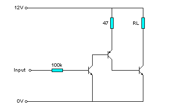

Guest Alun Posted April 30, 2005 Report Share Posted April 30, 2005 This transistor buffer has a very high inpuit impedance, low output impedance and a very high gain. Quote Link to comment Share on other sites More sharing options...
audioguru Posted April 30, 2005 Report Share Posted April 30, 2005 Hi Alun,You circuit has lotsa gain!You could mount a propeller above the hot 47 ohm resistor and use it to propel the car. ;D Quote Link to comment Share on other sites More sharing options...
