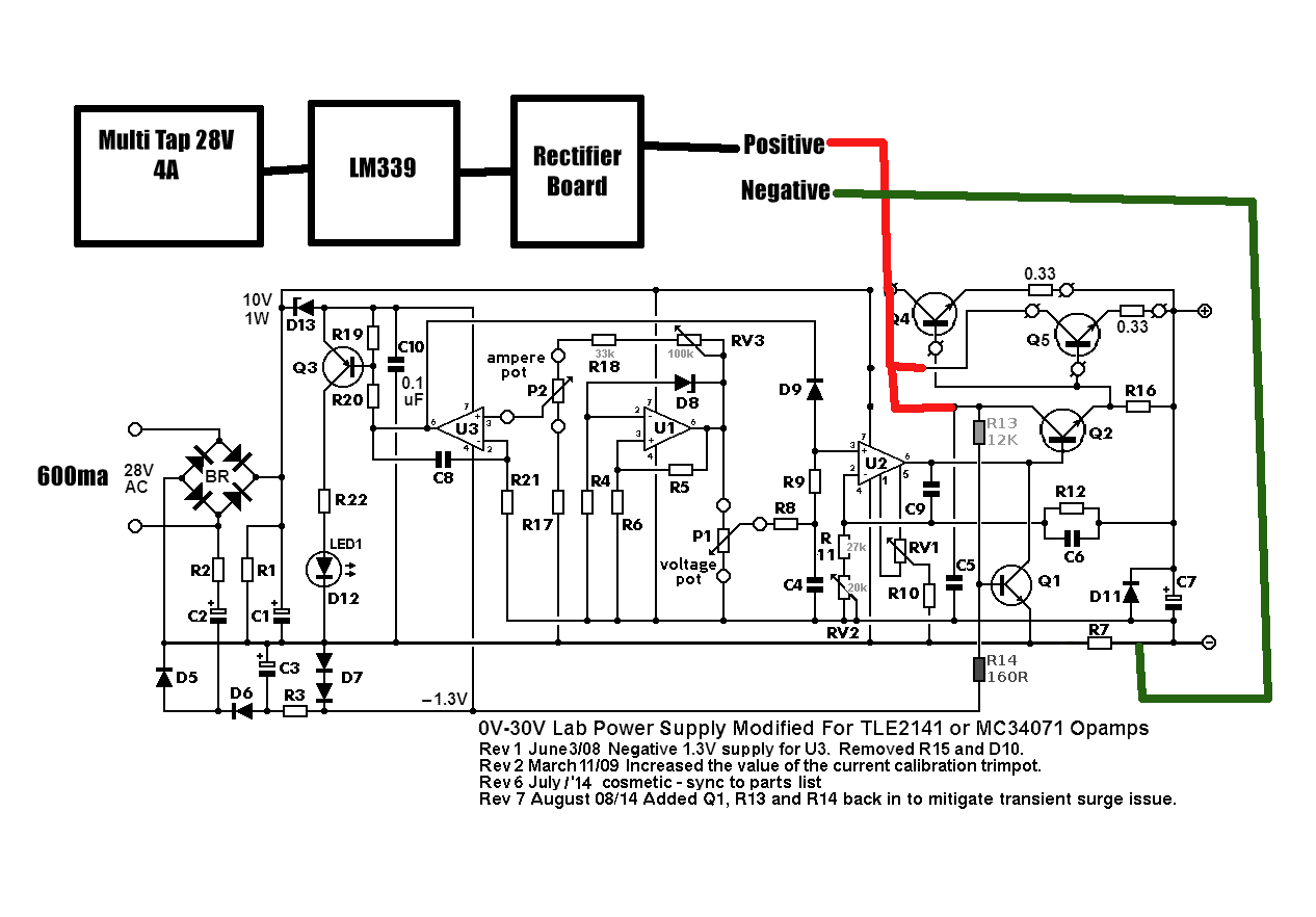

Hello everybody. What modifications should i consider for making this project? My idea is:
1- A huge transformer with two 28v secondarys. One secondary has a low current for only driving the current and power regulation. Another secondary will deliver the high current and has multiples taps. Both have their own rectifier boards.
2- A voltage comparator will take care of the tap selection based on the output voltage of the power supply. A way to reduce power dissipation. I'm thinking about the lm339 or three lm311 and relays.
I already made the transformer and i'm following the guide of a Youtube user who made the same modifications on the tl081 version of this power supply.  This is basically how he explained the concept. This approach is similar to the elektor power supply but without the tap selection circuit.
Share this post
Link to post
Share on other sites
Each comparator in an LM339 has an output current of only 4mA. Relay coils need more current so transistors or Fets must be in between.
Your block diagram is missing the huge filter capacitor needed that might burn out the relay contacts when the relays switch taps.
I
I was thinking about the tap selection circuit being done before the rectifier diodes and filter capacitors. This image relates to a similar aproach using the lm338. Since the mc34071 needs a stable 40v supply and -1,4v. Another 28vac 600ma transformer is used for powering the opamps and generating the negative supply. Most of my concerns are about the right way to connect the second transformer.

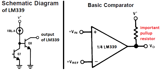

How can you use an LM339 without reading its datasheet? Since its output is "open collector" then it cannot turn on the transistor unless you add a "pullup resistor".
The output of your 10A rectifier does not connect to "regulator in". Instead it has a huge filter capacitor (12000uF) and it powers the driver and output transistors of the regulator circuit.
R13 should connect to the fixed +40V.
When you switch taps then the huge filter capacitor must instantly charge with an enormous current that will burn out or weld the relay contacts.
