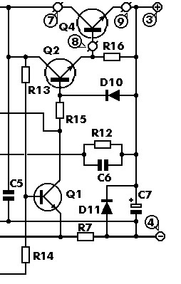

bp25 Posted November 8, 2020 Report Share Posted November 8, 2020 Hello everybody, I studied the schematic and wondered what the function of d10 and d11 is? Thanks for cooperation Quote Link to comment Share on other sites More sharing options...
HarryA Posted November 10, 2020 Report Share Posted November 10, 2020 My guess would be that D!! and C7 are to suppress superfluous outputs on at the power outputs. D10 is part of the biasing for Q2 transistor? Member audioguru is far more knowledgeable of this circuit than I; hopefully he will come by and give an expert input. Quote Link to comment Share on other sites More sharing options...
