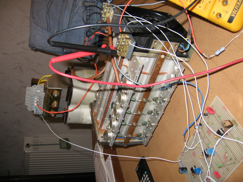

Guest 12345678 Posted September 21, 2006 Report Share Posted September 21, 2006 hello Quote Link to comment Share on other sites More sharing options...
audioguru Posted September 21, 2006 Report Share Posted September 21, 2006 Hi Markus,Welcome to our forum. ;DI think the -5.6V supply in your project is weak. It collapses when the 4mA of current in R20 and in U3 turns on Q3. Check the parts in the negative supply circuit. Quote Link to comment Share on other sites More sharing options...
Guest 12345678 Posted September 22, 2006 Report Share Posted September 22, 2006 thank you for the answer.but i think thats not the problem.i tryed something and i think its an ofset problem with u3.the polarity from u3 pin3 against pin2 turns around if i turn p2 to min. at this point when it turns around the output voltage is negativ.and that should not be.sorry the last time i learned english was in before 20 years ;) Quote Link to comment Share on other sites More sharing options...
audioguru Posted September 22, 2006 Report Share Posted September 22, 2006 I tried something and I think its an offset problem with u3.The polarity from u3 pin3 against pin2 turns around if I turn p2 to min. at this point when it turns around the output voltage is negative.That should not be.Maybe you have a bad opamp. The typical input offset voltage of an OPA445AP opamp is only 1.5mV and only 5mV is its max. The voltage across R17 when P2 is turned all the way down is 5.6mV.Connecting a 1N4148 diode across C8 might fix it, cathode to pin 6 of U3. I still think your negative 5.6V supply is too weak. Quote Link to comment Share on other sites More sharing options...
Guest 12345678 Posted September 22, 2006 Report Share Posted September 22, 2006 U1-U3=UA741CN @41V PIN 4-PIN 7 42V is the max.i will try the 1n4184. Quote Link to comment Share on other sites More sharing options...
Guest 12345678 Posted September 22, 2006 Report Share Posted September 22, 2006 with 1n4148 accross c8 it was a little bit better.not -0,6 at the output but -0,4.now 1n4148 is not over c8 but i changed r17 to 900 ohm.now my min current at output is +2 mA and not - 5 mA.so it works correct but its not perfekt. Quote Link to comment Share on other sites More sharing options...
Guest 12345678 Posted September 22, 2006 Report Share Posted September 22, 2006 these are my parts for my power supplynice and big ;D ;D ;D Quote Link to comment Share on other sites More sharing options...
audioguru Posted September 22, 2006 Report Share Posted September 22, 2006 U1-U3=UA741CN @41V PIN 4-PIN 7 Quote Link to comment Share on other sites More sharing options...
Guest 12345678 Posted September 22, 2006 Report Share Posted September 22, 2006 VCC is +-22 have a look at this datasheet.its a 27V AC transformer handmade by me.we will see what comes out after i test it.now i will go to bed. its 4:52 am.thank you155643-da-01-en-OP-VERST_UA741CD_STM.pdf Quote Link to comment Share on other sites More sharing options...
audioguru Posted September 22, 2006 Report Share Posted September 22, 2006 VCC is +-22 have a look at this datasheet.You are correct. I didn't know the max voltage is different from different manufacturers. It is only 36V max from National Semi and Texas Instruments.its a 27V AC transformer handmade by me.27VAC at full load will rise to about 28.5V without a load.27VAC makes 41.8VDC adding the positive and negative supplies.28.5VAC makes 44.5VDC adding the positive and negative supplies.we will see what comes out after i test it.Other people tested the original project and got a very high ripple at max voltage and max current because it didn't have enough unregulated voltage to regulate. Its max output voltage with good regulation was lower. Quote Link to comment Share on other sites More sharing options...
