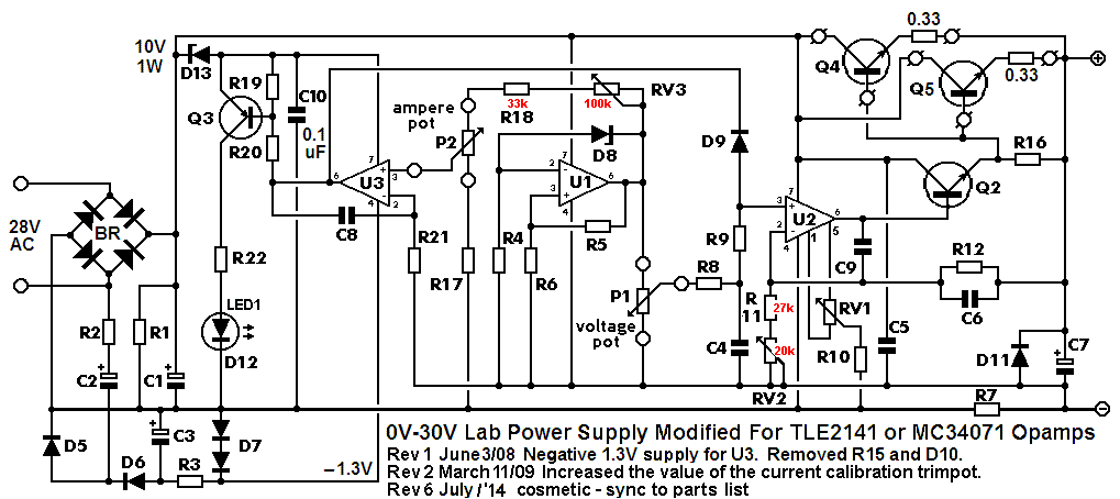

Shall I use TL081 instead of TLE2141 or MC34071
What are the changes need.
The original circuit used TL081 opamps. Its maximum supply voltage is only 36V and it needs a negative supply so it cannot produce +30V without risking damaging it with a supply voltage too high for it. It also has a problem called Opamp Phase Inversion that causes its output to go high when its negative supply voltage drops too low when the power is turned off. So transistor Q1 was added to short its output to ground when the power was turned off.
The MC34071 is not available anymore in a DIP package. It and the TLE2141 have a maximum supply of 44V and they do not need a negative supply so they work fine producing an output of +30V.
If you use TL081 opamps then they need a -5.6V negative supply as shown in the original circuit. But the positive supply in the original circuit was too high for them since it used a 24V AC transformer and without a load the positive supply was about +34V or more, then the opamps are powered with a total of 40V or more. If the transformer is 20V then without a load the positive supply will be about +28 but then the maximum output from the project will be only about +20V if you are lucky.

hello audioguru! i am a newbie in electronics. i want to know that why the opamps like CA3140, CA3240 etc do not work at all in this circuit though they are capable of operating with single supply. i know they have a max operating voltage of only 36 volts but still if i require a low o/p voltage from the supply, the circuit does'nt work at all with these opamps.
Share this post
Link to post
Share on other sites
The circuit might work with CA3140 opamps if the supply voltage is reduced by using a custom made 22V AC transformer but then the maximum output will be only about +22.5V DC at 3A if you are lucky. You might need to re-calculate a lower value many of its resistors so that the currents in the circuit are adequate.

Would NE5532 work in this circuit? I have no LME2141 in my country.
I also simulate the circuit in proteus, and it works, just have to change SPICE options for better convergence.
Share this post
Link to post
The LME2141 is not available anywhere because nobody makes it. You have the wrong letters.
The TLE2141 is made by the world's largest semiconductor manufacturer, Texas Instruments, and should be available everywhere.
It was selected because its maximum supply is 44V, its inputs work at 0V without a negative supply and its output goes down to almost 0V.
The NE5532 also has a maximum 44V supply but its inputs do not work below 3V and its output does not go below 2V so the circuit and spec's for the project must be changed for it to be used.

What are the parameters I should look in the opamp selection? I am a bit confused looking the datasheets.
Now I find MC34074 here, It is good?
Share this post
Link to post
The corrected and improved circuit used MC34071 or uses TLE2141 SINGLE opamps. They have a case that has 8 pins. The single opamps have 2 of the pins for the input offset voltage adjustment trimpot used on opamp U2. The MC34071 single opamp is not available anymore as a through holes type and is now only available as a surface-mount type.
If you use the MC34074 QUAD opamp (it has 4 opamps in its 14 pins case) then all the pins numbers must be changed on the schematic, a different pcb must be designed and it will probably overheat. Its opamps do not have input offset voltage adjustment pins.

I will be using 3 of them, to avoid overheat.
Offset adjustment is something I can live without?
Thanks for the help.
Share this post
Link to post
You must properly disable the opamps you will not be using. Even though they are not used their idle current causes heating in opamp U2 which might be too high.
The opamps in an MC34074 have a maximum input offset voltage of 5mV so when the voltage setting pot of this project is set to zero volts, the gain of opamp U2 will cause the output to be from -15.4mV to +15.4mV.
