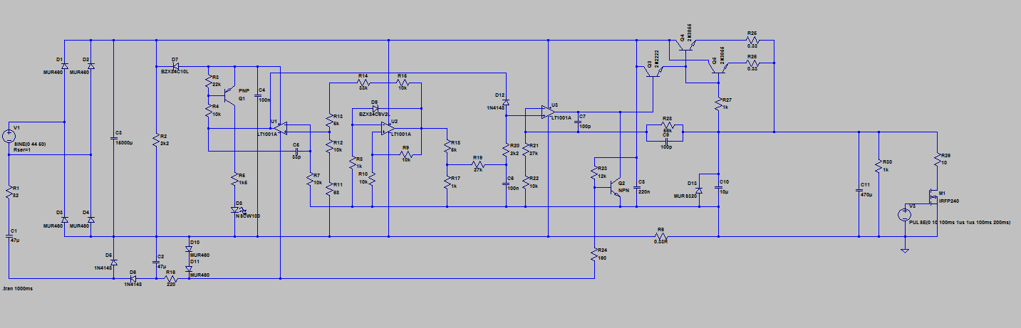

Ha! This is the first time I've been able to get something useful out of LTSpiceIV.  Behold, a simulation of your circuit redwire.

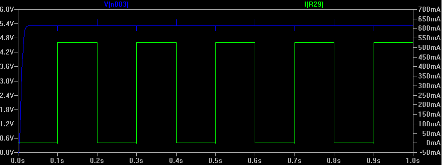

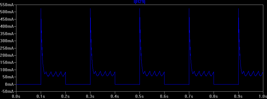

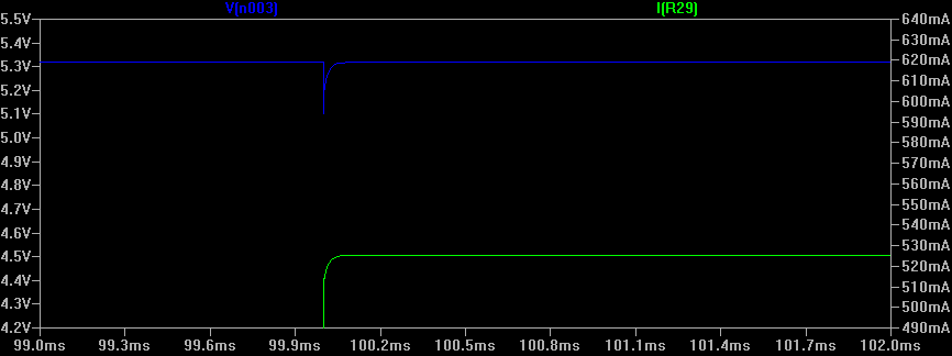

I have no idea if I'm really doing this right but I seem to be getting results from LTSpice.  I was trying to model the spike and then tune the turn on curve of the transistor to fall after that range.  I have no idea if this would work in the real world or not but it sure does look nice.  I've attached the .asc file zipped up if anyone wants to give it a whirl.
