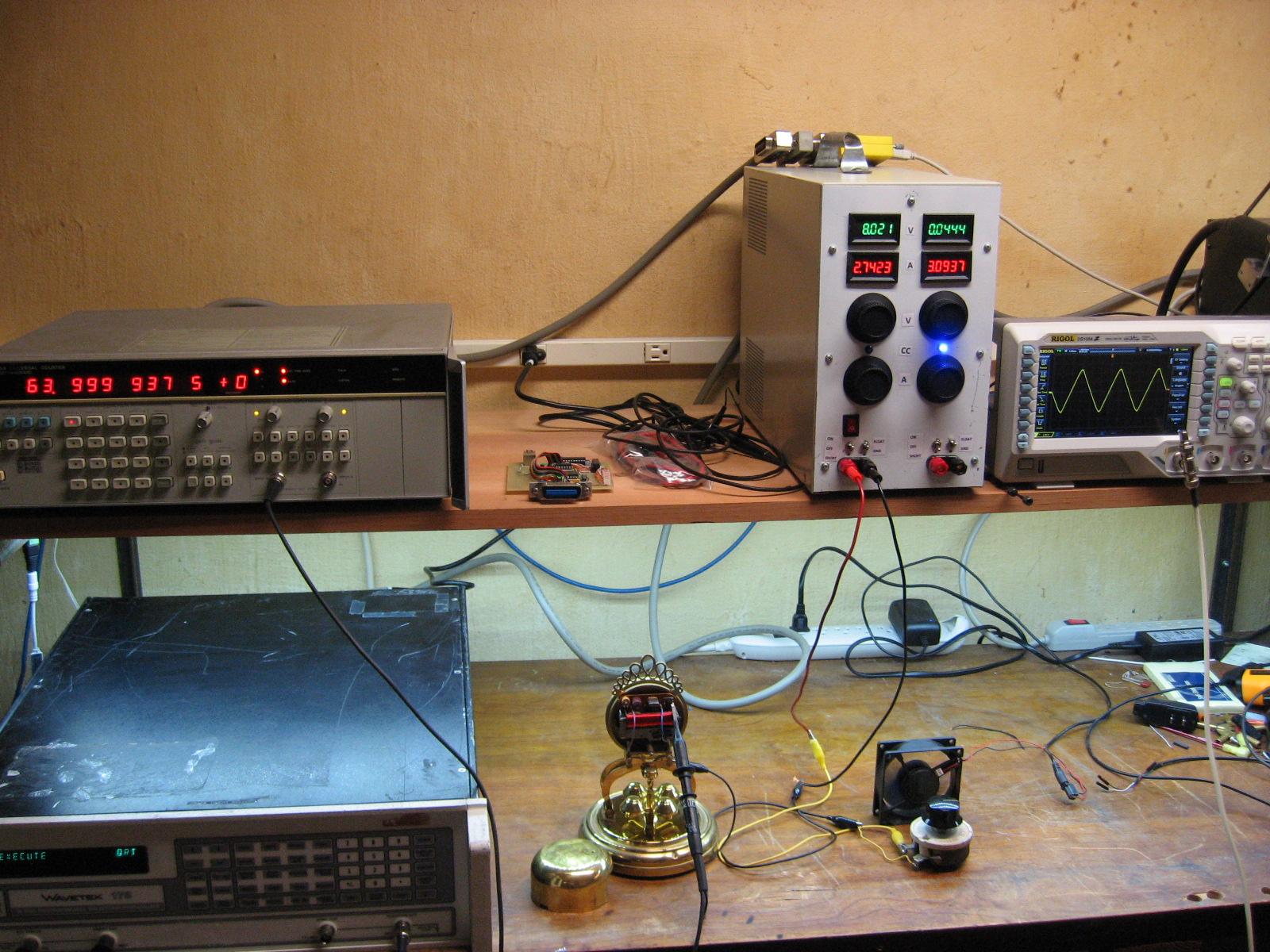

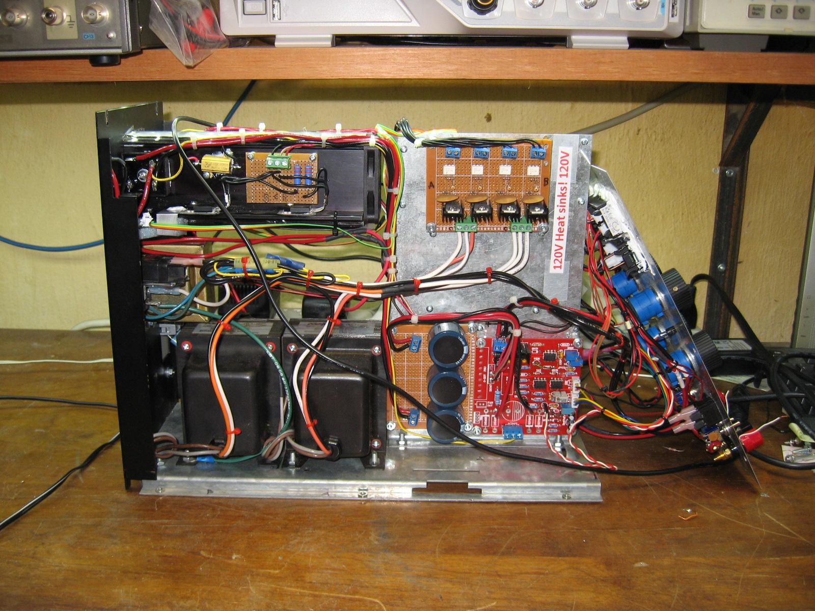

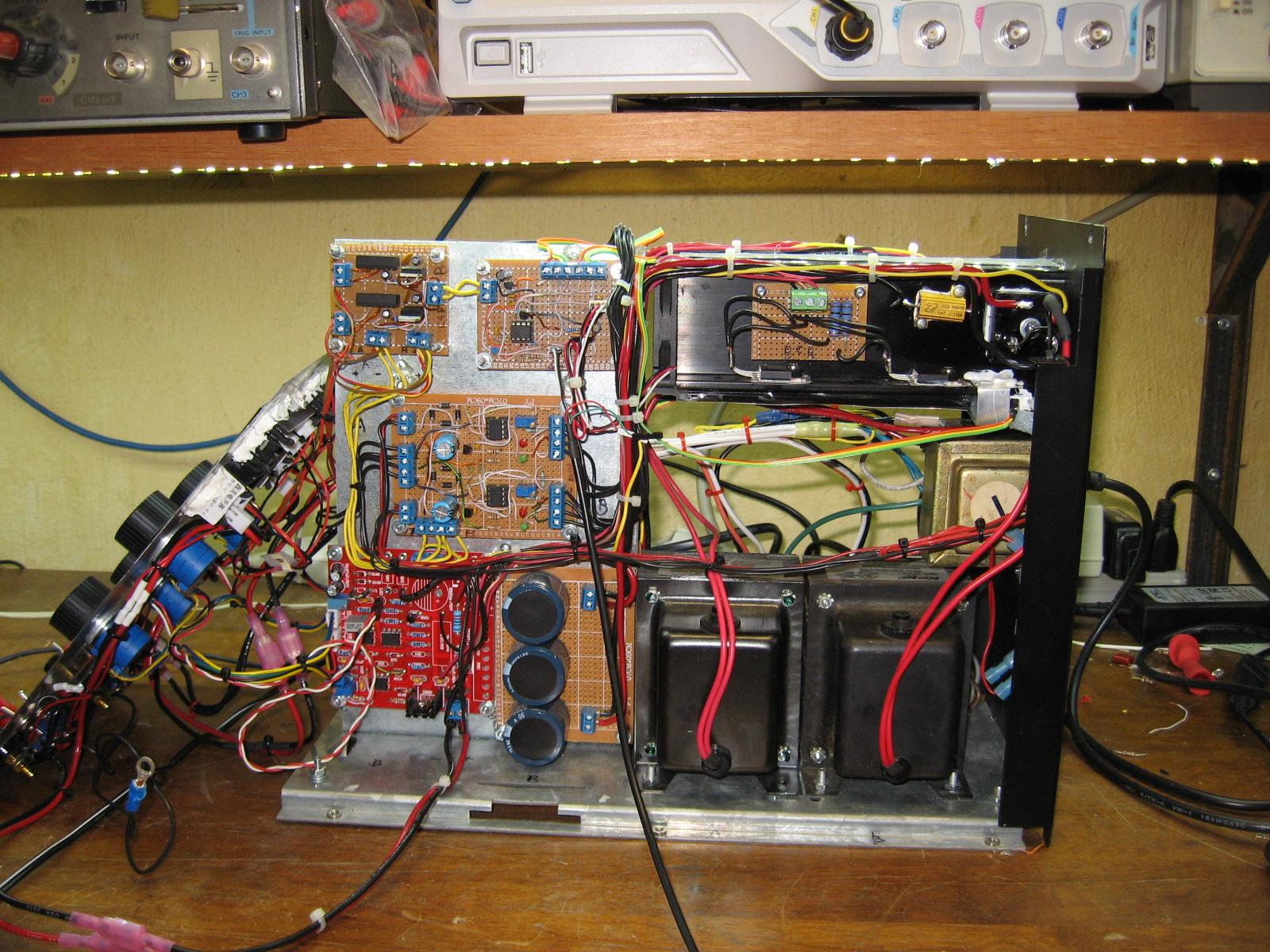

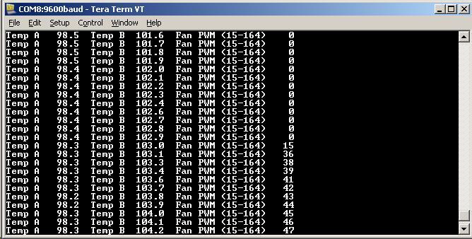

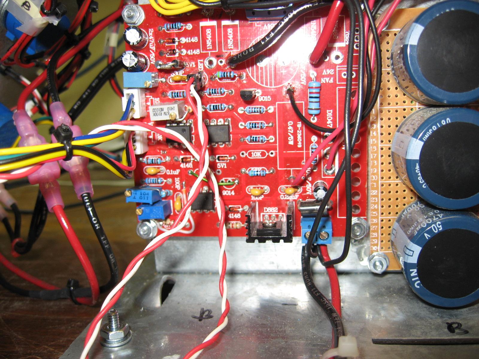

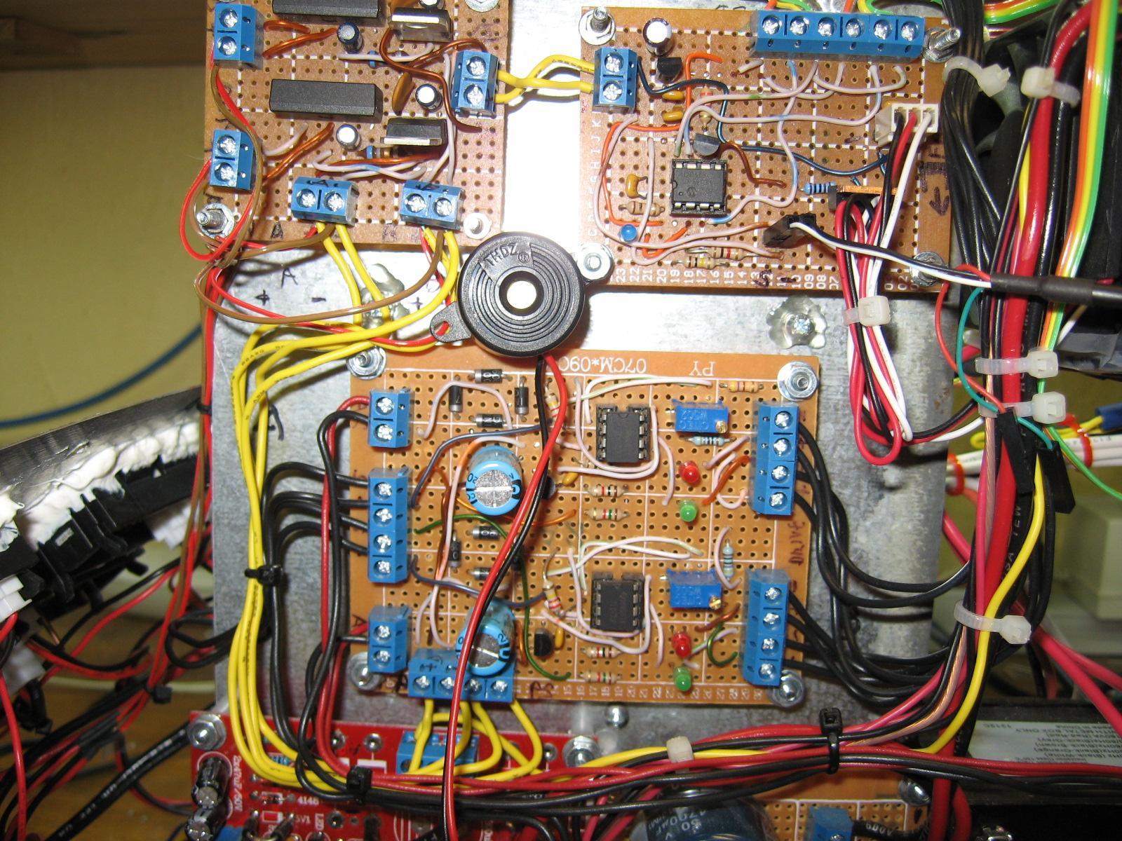

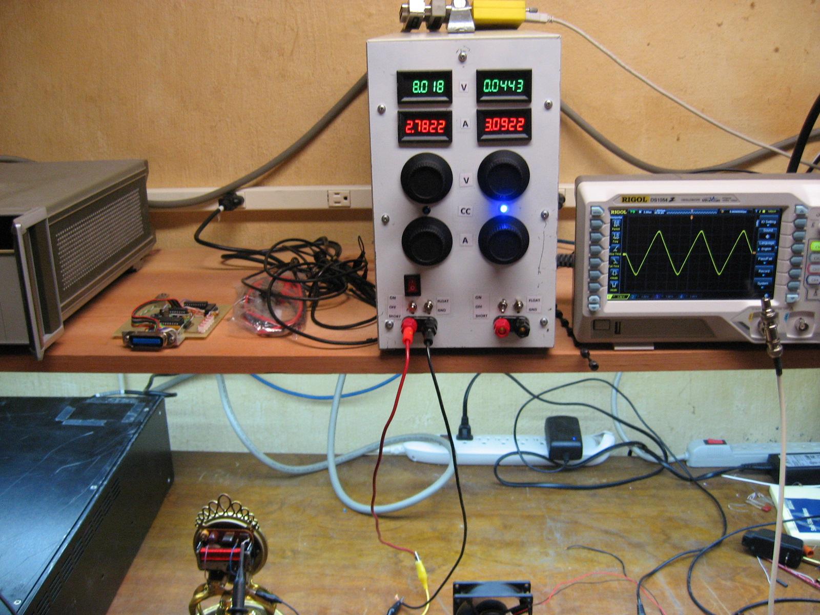

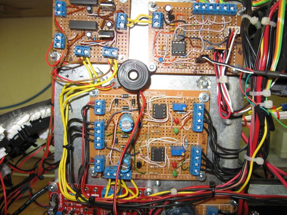

I finally have my power supply finished! It's on the shelf! I'm doing some full power tests.
I Started with a pair of the Chinese circuit board kits.  Lucky that I found this thread. I made the mods to the boards and added higher power components and  PWM fan control.
My transformers have multiple primary voltage taps. I Used a comparator to select a higher transformer input voltage tap when the power supply  output voltage is low. This greatly lowered the power Dissipation. With commercial power supplies this transformer voltage selection is done on the secondary of the transformer.  With the transformers that I got for free, I could only switch primary winding taps. This required triac switching circuits.
Pictures are attached.
