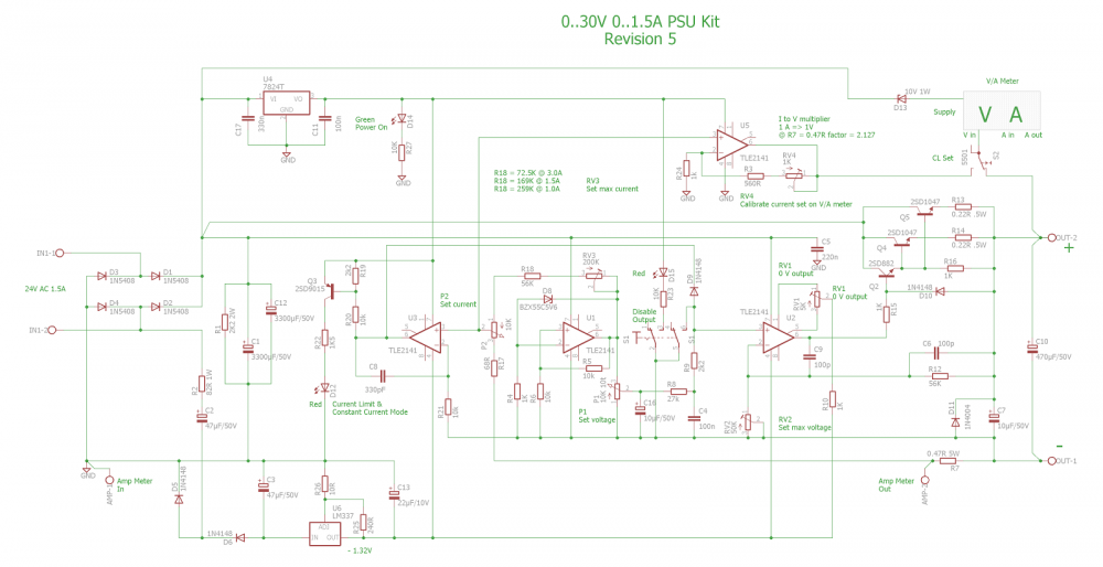

I have bought two of your PCBs from repairman2be (rev. 8.), awaiting them any day now. I have studied the schematic pretty thoroughly and tried to read up on the threads.
Very interesting, and good to have something educating to do with my time :-). So far I have one question that I can't find a comment on in the forums.
First, let me introduce myself. I'm a Swedish 30 year old mmWave/μWave/RF engineer (read: allergic to noise) and I just had a second son so I had to find something to do all the nights I stay up taking care of him. Designing a PSU seems like a good choice!
It started with me realizing that I today financially can handle some of the ideas I had when I was 20, now time is more of an issue instead. But hey, it doesn't matter if it takes time to reach the finish line.
I always wanted to build a boombox. I thought a good place to start was to design a PSU (to not waste battery when a socket is available) and a relay-circuit. I read up a lot on audio PSUs and actually designed a linear 10-18V, 10A supply, and hand drew the breadboard and everything. When I saw the end-price I reconsidered. This PSU is kinda useless for anything but the amplifer, it's better to have a 0-30V supply I can use for lots of things. Especially considering I have no use for or place to store a boombox. The reason I'm saying this is that I might be tainted by audiophiles in my way of thinking :-). That I'm tainted by my RF-world at work I don't see as a problem, RF is probably what I'm going to use it for.
Then I found this design and got interested. But I still wanted it to be able to run the amplifier I had in mind for the boombox, which is something like 14V/6A. I considered paralleling two of these or use a LM723 regulator. I ended up with the idea of two 0-15V LM723 PSUs which I can parallel connect for  0-15V/0-10A or series connect for 0-30V/0-5A. I was pretty happy with this idea and started designing. However, I couldn't get the current limit to work as nicely as I desired for a bench PSU.
Then I came back to this design, and here I am now.
I'll start with building your 3A design pretty much identical to yours. To be able to do some measurements and see how it behaves before I try to improve it :-). After that I will start designing my own board. I'll probably stick to 3A or 5A for a while, if I need an amplifier PSU I'll design it for that purpose.
My ideas for improvements is to reduce the voltage drop a little, have a look at the negative supply (it hurts my eyes that it doesn't load both lines symmetrically). If I reduce the voltage drop and feel that I can't find an optimal transformer I might reduce the output voltage a little. I feel 30VAC is a little too high and 24VAC apparently is not enough so there is some unused power wasted there. We will see how it goes.
For later I might also take up the idea of LT1236 as reference. We will see. First I believe I have some startup transients to deal with!
So, now to my question:
Your R9 (original R17), is 68 Ohm. The original design says 33 Ohm but you changed it to 68 Ohm. Why did you change that? Have you found some issues with stability if it is too small? The reason I'm asking is that if I lower the current sense resistor I might want to increase this. Maybe I'm doing this wrong. I calculate the original design to give a minimum current limit of 10mA (while it says 2mA in the description), and your gives 20 mA.
Edit: I found the change, it was just to get the voltage divider to give the correct minimum voltage. However I'm still confused, but this can probably anyone answer. It should be simple. I don't get the formula for the current limit.

So, I ended up getting the PCB:s from Repairman (great service there) and have put one together, I do have a weird issue someone might be able to help me with:
The circuit the PCB is based on is the Liquidbyte version from the top of page 88 of this thread (http://electronics-lab.com/community/index.php?/topic/29563-0-30v-stabilized-power-supply/&page=88). The things where I deviate a bit are:
  1. The ballast resistors for the 2N3055's are 0.1 Ohm rather than 0.33 since I didn't have those available at sufficient power rating
  2. The sense resistor is 0.46 Ohm: Rather, it's a small network of two 0.56 Resistors in parallell after which there is a single 0.18 one in series, yielding 0.56/2+0.18 = 0.46 Ohms, again for availability
  3. The single 10 uF Polyester cap was also lacking, so it's replaced by two 4.7 uF ones in parallell, they turn out to measure almost exactly 10 uF
  4. My rectifier bridge is only rated at 12 Amps at 250 V, this should be sufficient though
  5. The Transformer is a 30V/4A, yielding the same 120VA
Now, when I fire the thing up, I can adjust voltage fine from about zero (haven't been able to calibrate it yet) but only up to 17.56V (which may not be that exact given it's from my multimeter). Turning the trim pot adjusts down from this fine, but when adjusting up it goes to those 17.56 and stops. Now, if I disconnect the voltage adjust pot entirely the output shoots up to 40V, connecting it back makes things stop at 17.56 again. Have looked things over and can't find anything obviously wrong, maybe someone has an idea to what may be happening would be greatly appreciated!

The middle opamp in Liquibyte's schematic is the 11.2V reference because it uses a 5.6V zener diode and it has a gain of 2 times. The voltage setting pot R27 is simply a voltage divider that feeds 0V to 11.2V to the non-inverting input pin 3 on the opamp on the right side. The gain of this opamp is 1+ (56k/28.8k)= 2.9444 times so that the maximum output of the circuit is 11.2v x 2.9444= 30.0V. Your middle opamp is messed up since its output voltage is too low.

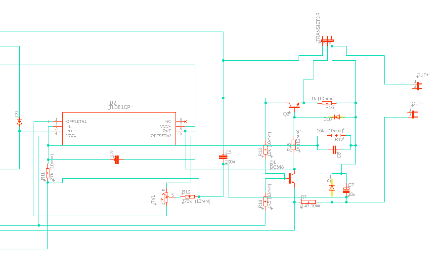

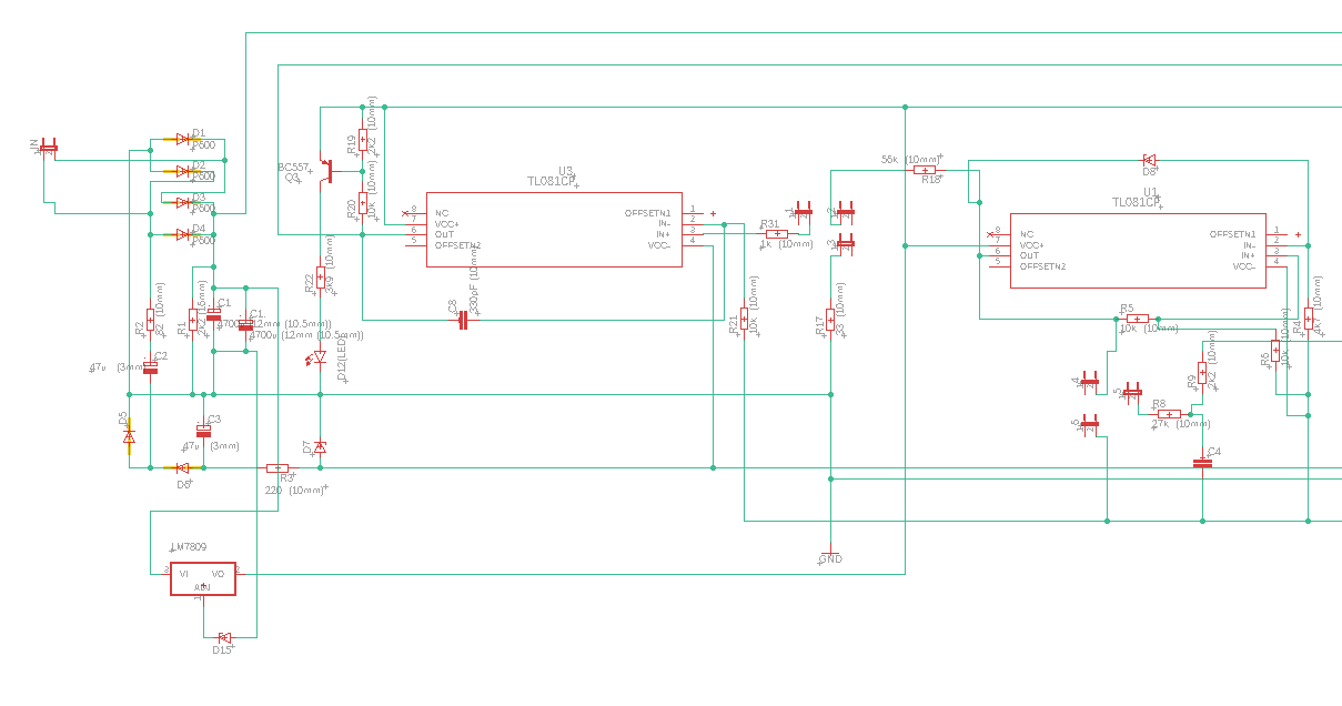

Hi everyone. I've built one of the early 3A versions of this project several years ago. Its has worked very well after making the upgrades recommended by Liquibyte and audioguru (Thanks very much).
I am planning to build a 5A version with a few additions of my own. I have added an arduino NANO which will measure and display AMPS and VOLTS, a cooling fan control which uses 2 CPU fans and heatsinks to cool output transistors, a bar graph display for current limit setting, buzzer for current limit warning and a relay to enable/disable power supply output.
Using the output relay avoids needing the soft start delay to avoid the output transients and can disable outputs with press of a button.
I've attached schematics of my current version for anyone interested.
After seeing design by Imester using 2 transformers to step up or down the output voltage, I would like to integrate something similar into my design using 2 12V center tapped transformers instead of a single 24V. Could easily use arduino and relays to control which transformer secondary windings to use depending on Volt Adj pot setting.
Does the opamps need their own separate supply voltage for this to work properly or could it simply use Vin as it does now?
Any ideas and suggestions for a dual transformer setup or the overall design are welcome.

You'll need to keep the supply voltage high enough so that the zener voltage reference does not drop out. This was not a problem for me as the minimum voltage that I appliy is about 15V.  Also, for input voltage switching to work porperly, you'll want to monitor the supply output voltage and not the volt adjust pot. If the supply is operating in constant current mode the output voltage may not match the pot position.
