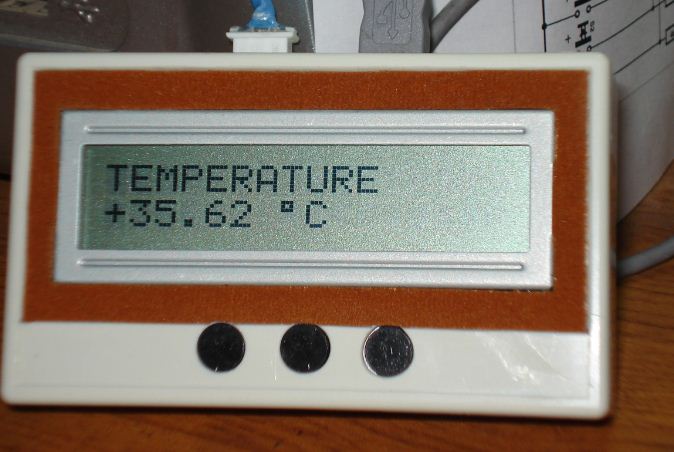

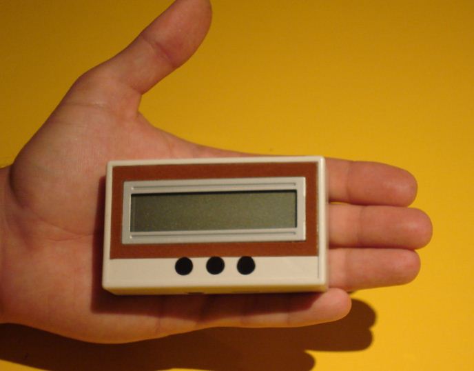

my expert friends I hope you have good day . in some months ago i made a project for sensing ambient  temperature with PIC micro controller and sensor was DS1820 and show at  2*16 character LCD.
you can see scheme in this attachments.
but i now looking for high precise temperature sensor that can sense in thousandth degree in centigrade.
can you introduce me a high precise temperature sensor?? or you think  i should use DS1820 but change program?

A generic platinum RTD with get you a 100th of the way there for about $100.
There are also precision thermistors that are about as accurate for about the same price.
A metrology grade platinum RTD will get you a 10th of the way there for about $600.
I assume you already have signal conditioning hardware that's every bit as accurate?
Your pockets must be deeper than mine. I'd stop at $50 and 0.25

You'll also need to use a much more accurate ADC which will require the software to be modified.
I suggest you look at the schematic, read and understand the code. You probably need to start from scratch but some parts can probably be reused.
