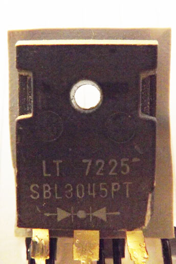

Guest tjeffords Posted March 8, 2013 Report Share Posted March 8, 2013 Any one have a clue what this might be? Quote Link to comment Share on other sites More sharing options...
Hero999 Posted March 8, 2013 Report Share Posted March 8, 2013 The clue lies in the symbol at the bottom of the package. Quote Link to comment Share on other sites More sharing options...
Guest tjeffords Posted March 8, 2013 Report Share Posted March 8, 2013 I thought the symbol was for I diode but I have never seen one that has two of the symbols pointed towards each other with a dot in the center. Quote Link to comment Share on other sites More sharing options...
Hero999 Posted March 10, 2013 Report Share Posted March 10, 2013 You're right, it's a pair of diodes. It's actually quite common to get high power diodes in this kind of configuration. They're commonly used to connect two batteries together or as as a full wave rectifier with a centre tapped transformer in a switched mode power supply.Have you tried typing the part number into a search engine? Quote Link to comment Share on other sites More sharing options...
The Master Posted April 16, 2013 Report Share Posted April 16, 2013 A quick look on Google for SBL 3045-PT led me to Digikey.http://www.digikey.com/product-detail/en/SBL3045PT/SBL3045PT-ND/1935315It is a SCHOTTKY Diode 45V 30A TO3P pkg (dual diode) classed as obsolete. A replacement was suggested as a SBL3030 PT .Cheers, Jeffaka, The Master============== Quote Link to comment Share on other sites More sharing options...
