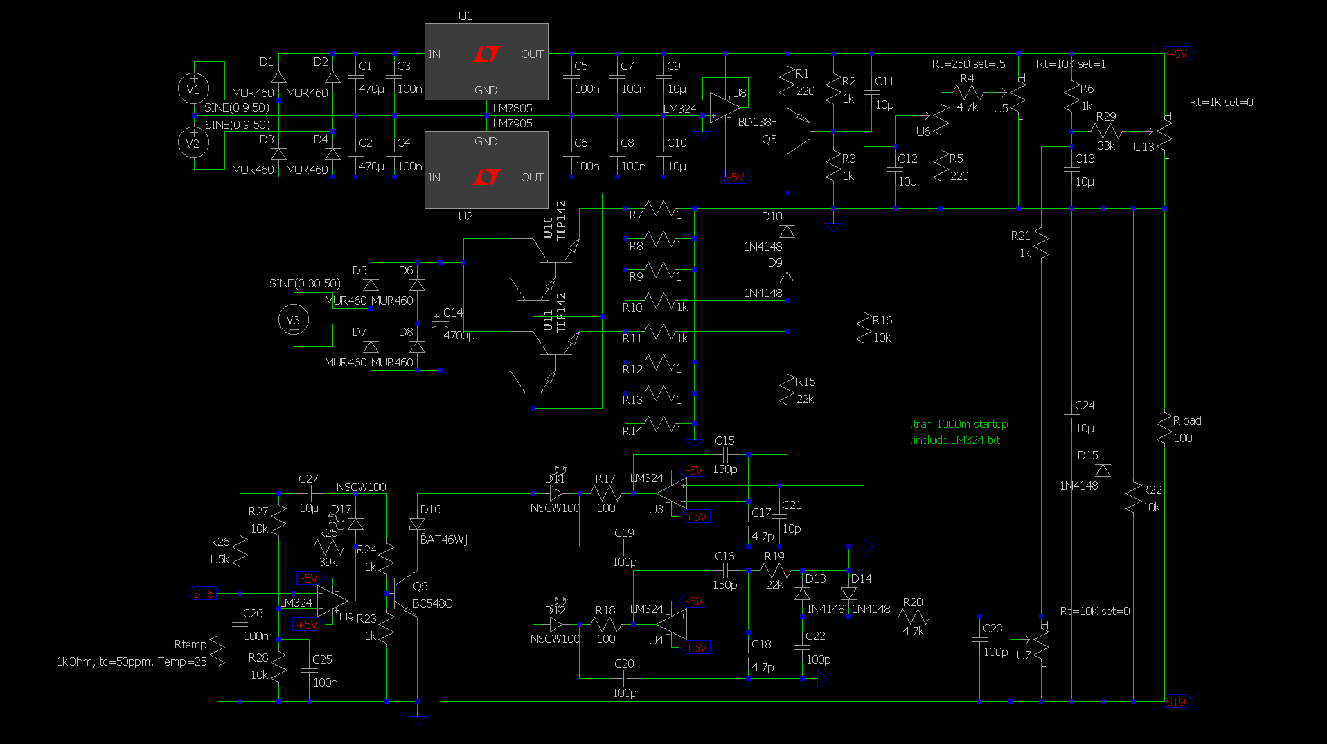

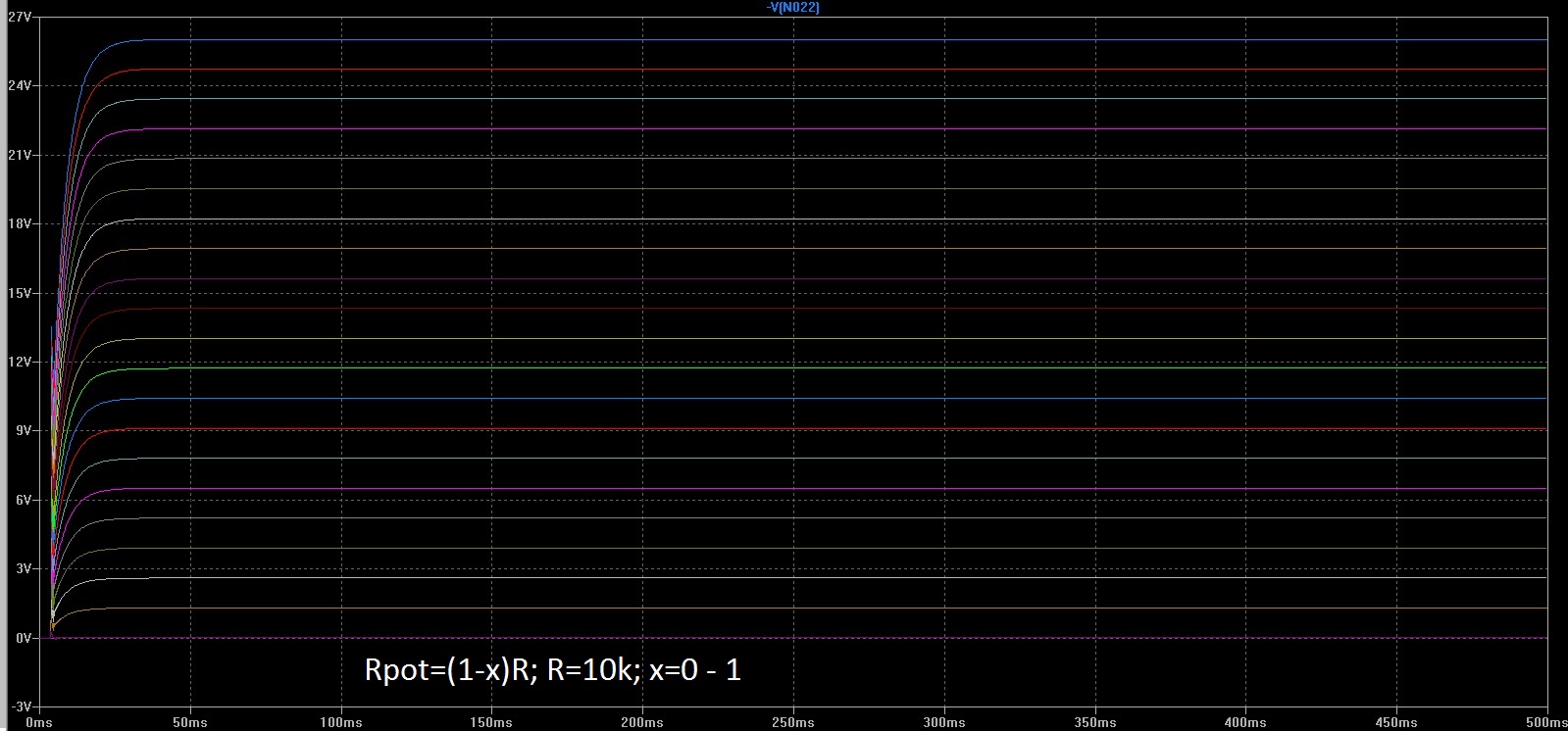

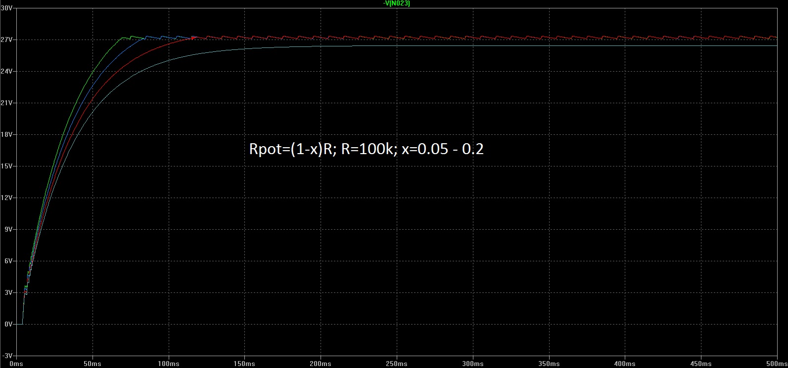

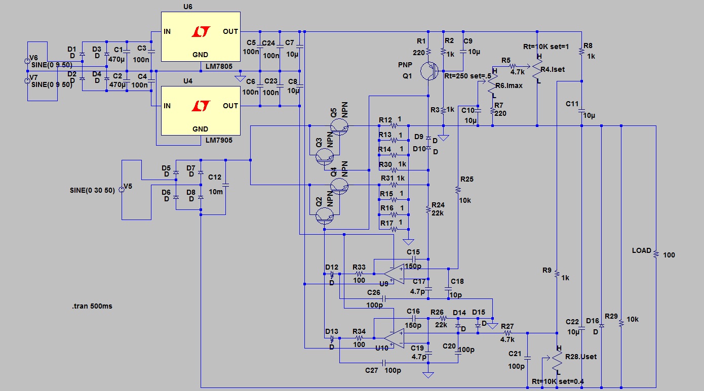

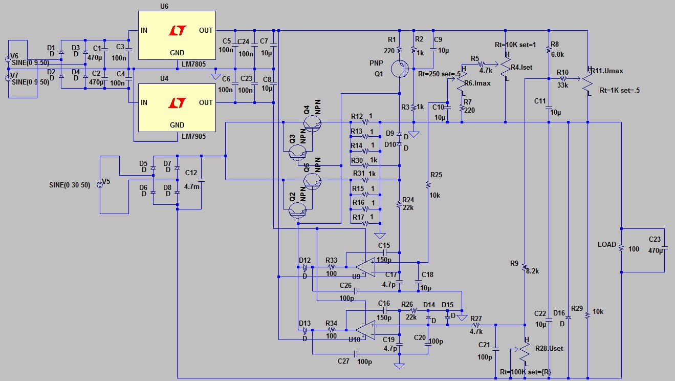

Guest Jaxelo
I've been working on that ELV psu - I haven't actually built anything but I ran lots of simulations and I solved some problems: The old voltage regulation was kind of strange - it was letting too much voltage in and the regulation wasn't even working at one end of the potentiometer. I also changed the pot from 100k to 10k and will probably later be swapping that with 2 pots for coarse/fine adjustment.
One other thing I did was remove the max voltage out set pot since I think I won't really need it.
I think all of these simulations might be a bit inaccurate since I am using a lm7905 model that actually outputs -5.3V. Could that effect my measurements in a way that what I am seeing here is not what I would see if I built this up?
I'm providing some pics (simulation and schematics)
Edit: first two pics are of the changed circuit, the other two are the original circuit in the pdf from ELV

Guest liquibyte
Where are your outputs? The layout of this is very confusing without labels.  Yes, I modelled it but haven't rearranged it yet.

Guest Jaxelo
The output is at the LOAD resistor and the schematic has a similar layout to the original one if that helps

Guest liquibyte
Is it supposed to be a negative supply then because that's what I'm getting?

Guest Jaxelo
I guess it couls be; the + rail is on the circuit gnd, but it's a floating supply. Did you copy the whole thing? I could've uploaded a file...

Guest liquibyte
When it comes to electricity and simulation it doesn't matter what point your ground is referenced at but it makes it hard to get a positive voltage in the sim.  Yeah, I duplicated it from the image.  The folks responsible for LTSpice are wonderfully prescient about keyboard usability so I'm getting quicker as I train my habits that way and enjoy doing it.  I wish there were a translated version of that pdf though, I'd like to read the article.
I meant to ask you if you knew how to add parts from models off the net?  You can actually put the LM324's (or any op amp model you have) in the circuit if you have the spice file for it using opamp and opamp2.

Guest Jaxelo
The + rail is grounded for regulation purposes as I understand. Could I put a "real" earth (from transformer) on the negative rail if I wanted to reference it to ground? Additional green plug would be used for that.
Also the thing I put in instead of the max U set pot might not be optimised, not sure about that.
I also like using the key shortcuts but am not that familiar with the software... I don't really understand how the model/library thing works with LTSpice... do you?

Yep, I do know how most of this program works but there are certain aspects of spice and LTSpice that go way over my head.  All you have to do is be dedicated and do your research and you'll find ways to do things that you didn't think possible for a simulation.
Here's a model I did based off the pdf that has the LM324, TIP142's, and I used a resistor with a temperature variable as the PTC.  I'm still trying to figure out where the startup transient is coming in at but the model is valid.  Read the README because you have to put the stuff for the TIP142's inside your programs folders so they work and you can call them up with your F2 key.

Guest liquibyte
Cool, I need to get a better understanding of the program :D
How do you link the +-5V down to the opamps?
F4 > Label net > Choose output for the output voltage (i.e. the net at the output of the LM7805) you want input at the op amps and attach that label there.  Then do the same for the input of the op amps but choose input and name the label the same thing you did at the output.  To summarize, you're naming the net for the output voltage at the voltage regulators +5V and -5V and the net at the input of the op amps +5V and -5V.
Btw what's the output of your lm7905? I have a model that outputs -5.3V
-5.3086687V
Also - this thing is supposed to go 0-30V but it couldn't ever do that with a 30V transformer, so I'm probably gonna make it go to 25V or use a 34V transformer or something like that.
I get -25.357171V from ST9 to GND.  I'm still playing around with it to see if I can stabilize the input and I'll have to translate the pdf to see if I can understand the circuit a little better to make it output what It's supposed to be doing.  Changing the input voltage to 34-35V won't change the output so the issue lies elsewhere.

Guest Jaxelo
Thanks for the info!
I can get steady 30V if I put 34 sine input - I think only the voltage divider that feeds into the opamp needs correction. I talked to a guy at our university which is "specialized" in electronics and he said (after a short inspection) it should be fine. There might be an error with the resistors, though.
