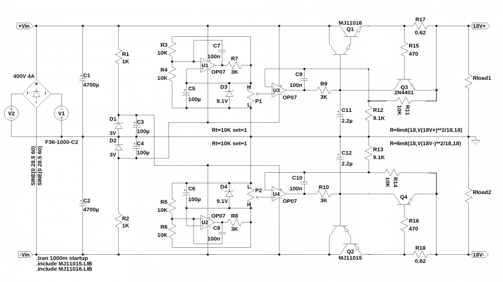

I have come up with what seems a fairly decent power supply using a minimal of parts that are easily obtainable and cheap.  The idea is to have a power supply for working with dual supply op amps.  The schematic in the picture differs from the LTSpiceIV simulation file for clarity.  I've got this sitting on a breadboard and it works but I've only loaded it down to 200mA so far due to my not having had boards made yet and the transistors not being on heatsinks.  Once I've got this completed I'll put up a BOM with everything I've used including the case, meters, heatsinks etc.
Updated to reflect reality.  I'm probably going to just put in analog meters for this project.

You guys are late to the conversation.  I've had the boards made and from my testing things work rather nicely.  I did make a mistake on the gerbers and forgot to connect D2 to R2 but since it was a short hop, I left the lead on the zener long, folded it over and soldered it to the lead of the resistor on the bottom.
I have no way to vary the current dynamically and I'd not imagine anyone doing that so I'd say, all in all, things work as expected with no oscillation at all.  I've got less than 20mV ripple at full load on the output.  For what I designed this for, I'd say it works nicely.

I am glad you are happy with what has been achieved. I did not mean to criticize, simply insignificant change without complicating the circuit can eliminate the fall of 0.62v when consumption is 1A. The audioguru also right, C11 and C12 better be around 0.XXXuF.

Your change adds significant oscillations to my simulation output on the positive side of things.
C11 and C12 slow down the outputs too much, causing poor voltage regulation if the load current changes of if the load current is modulated. The circuit will have serious overshoots and might oscillate.
As for the 2.2u cap, it could have just as well been 1uF but 2.2uF is what I had on hand that solved the issue I was working on also in regards to oscillations.  I got the value from doing some research into problems I was having and this was a recommended solution and, no offence, it worked.  I'd link what I was reading but I can't find it again.  Suffice to say that it was from a reputable source and not instructables or the like.  I think it was actually an ap note and I'll link it if I find it.
The bottom line is that while math and theory can go a long way, up until you build something you never know what you're going to get.  Oh, and always run board checks.  The missing trace was a dumb mistake on my part.  The pic of the board shows the fix I had to do.
This is a redesign of something I found online and wanted to see if I could simulate it an manipulate it to do what I wanted.  My changes worked so well that I wanted to put it on a manufactured board so I did.

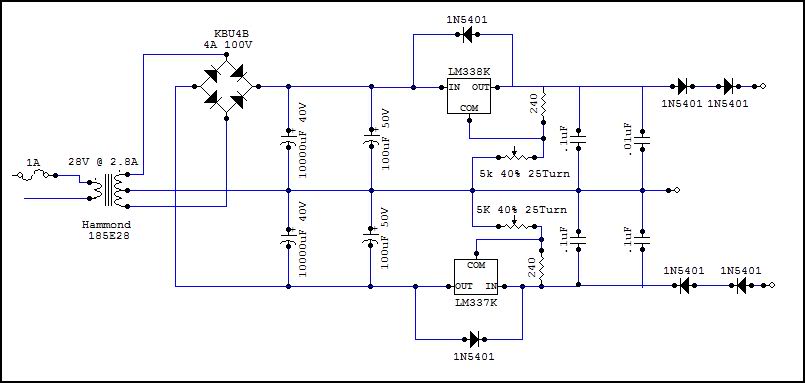

If you like to experiment try This0-18V-Independently3-Variable.thumb.png.
"I have come up with what seems a fairly decent power supply using a minimal of parts that are easily obtainable and cheap.  The idea is to have a power supply for working with dual supply op amps."
A very basic and stable example. The op-amp burn equal to 1A or 5A.ejemplo.thumb.jpg.c8f2c4d9438234c457e6fb
Very good work
Edited by CBETO3AP
Link to comment
Share on other sites
The two series diodes at the outputs of the regulators RUINS their excellent voltage regulation. Why two diodes, why not just one diode, it will also ruin the voltage regulation but not as much as two diodes?
The sliders on your 5k pots are shown disconnected.
The 240 ohm resistors are for the more expensive LM138 and LM137. LM338 AND LM337 need 120 ohms (and the pot value also halved) to prevent the output voltages from rising if the load current is low.

The fact that you even suggested that circuit tells me that you either know nothing and are trying to fake it or that what you think you know is entirely wrong.  Linear regulators as a lab supply is just stupid and I'm tired of seeing that dumbass circuit all over the net being suggested as so.

You can do a search for output decoupling caps to ground and you will find several references to 1uF to 2.2uF for the values in an effort to solve oscillation.  I used these because of that actual problem I was having.  I do understand each component in the circuit having studied it extensively and having modelled it in LTSpiceIV extensively to arrive at the circuit that I posted.  Bringing in linear regulators to the circuit added nothing to the conversation whatsoever.  I did not copy that other circuit, I based mine off of that configuration.  By the way, the 0-30V circuit uses the same principles and quite a bit of the same configuration.  I don't know if you've noticed but I posted a modified version of that circuit that I'm working on as well.  I removed the part of the circuit that was the negative regulator because it really added nothing to the circuit and introduced issues that has made it hard to fix.  We now have a 10V reference and a 0.1 ohm current sense resistor that suffers from much less heat than before.  Still think I don't understand what's going on?

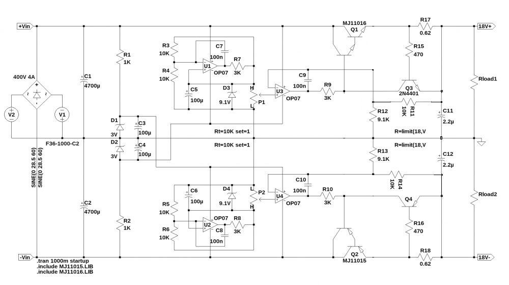

I am glad that the value of the R7 heater has been reduced to 0.1 ohm. The original was 0.47 ohm which heated with (3A squared x 0.47 ohm=) 4.23W. The TL081 opamps that were used had a maximum input offset voltage of 15mV (!) so the minimum regulated current with an accuracy of 20% was 15mV/0.47 ohm x 1/5= 6mA but they claimed 2mA.
I do not think anybody needs current regulation less than 20mA (for an LED?).

I tried my best to fix a few of the more glaring issues that I had while I was testing.  The one thing that always bothered me was the current sense heater.  I felt like I should be using this as an on demand water heater.  I'm actively working on prototyping out the changes to see what works and what doesn't.  The one thing we lose is getting voltages close to 0V but I don't think anyone really needs that either.  I haven't looked at different op amp solutions yet because the TLE214x family worked so well but my guess is that a nice rail-to-rail could go in there now without issues due to the 36V regulator circuit and come close to addressing that issue.  My focus was on the transient issues and a better current sensing scheme.  I'm planning a voltmeter/ammeter for this using modern parts.  12bit ADC, Atmel microcontroller (up for debate but I've got some blank 328P-PU's), and a MAX7219 to drive the displays, and a 4-wire sense resistor.  Doing the meter is more for the educational value than anything else for me but some folks might find it useful so I plan on releasing everything all at once when testing is complete.
