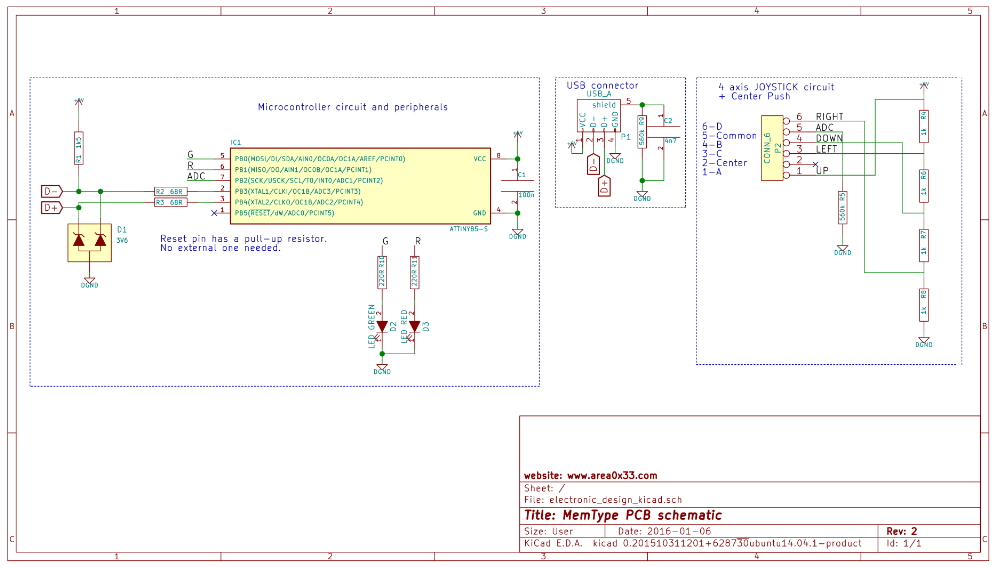

Noela and Miguel from Area0x33 made a really helpful tool on hackaday.io. They designed a fully open source hardware USB stick to store your username/password pairs on.
MemType uses Atmel ATtiny85 MCU and V-USB to do the communication over USB. V-USB is software-only implementation of a low-speed USB device for Atmel’s AVR microcontrollers.
Memtype Schematic
Memtype Schematic
Memtype uses [NOEKEON] to encrypt the stored values with 2K flash reserved for storage, and a PIN number, settable by user, to protect your information if your stick was lost. There is no need for any drivers, because Memtype is numerated as a keyboard. You just need to plug it in usb, enter the PIN code, and then choose your username/password. It uses 5-way tactile switch as user input.
