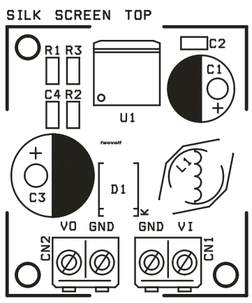

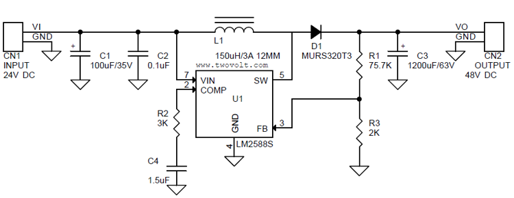

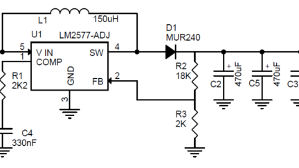

This is another boost DC-DC Converter that provides 48V DC output from 24V DC input with a load current of up to 1.5A. The board is very small. Booster is based on LM2588 IC from Texas Instruments. The LM2588 regulator integrated circuit is specifically designed for fly-back, step-up (Boost), and forward converter. Board has minimum components, screw terminal is provided for input & outputs.
- Input Supply 24V DC
- Output 48V 1.5A
Schematic
Parts List
SR. | QNTY. | REF. | DESC. |
1 | 1 | CN1 | 2 PIN SCREW TERMINAL - 5 mm pitch |
2 | 1 | CN2 | 2 PIN SCREW TERMINAL - 5mm pitch |
3 | 1 | C1 | 100uF/35V |
4 | 1 | C2 | 0.1uF - 0805 |
5 | 1 | C3 | 1000uF/63V |
6 | 1 | C4 | 1.5uF - 0805 |
7 | 1 | D1 | MURS320T3 |
8 | 1 | L1 | 150uH/3A |
9 | 1 | R1 | 75.7K - 0805 |
10 | 1 | R2 | 3K - 0805 |
11 | 1 | R3 | 2K - 0805 |
12 | 1 | U1 | LM2588S-ADJ - Package: TO-263 |

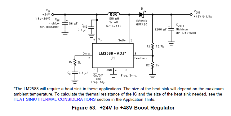

Reference Design
