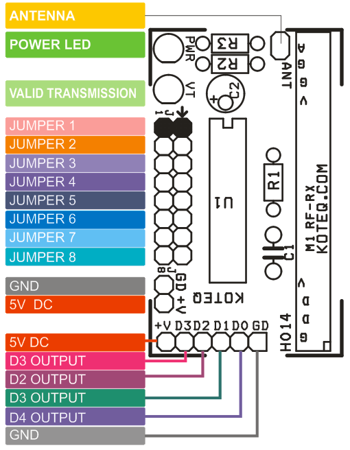

NOTE : Jumper J1 to J8, To set High Jumper provided at Bottom layer of PCB, Jumpers and closure provide to set low, don’t use any of these for floating.

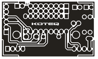

  • PCB Dimensions Transmitter 36MM X 26.67MM

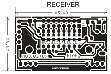

  • PCB Dimensions Receiver 45.40 MM X 26.67

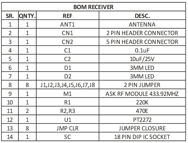

4-Channel-RF-Remote-Controller-BOM-RX

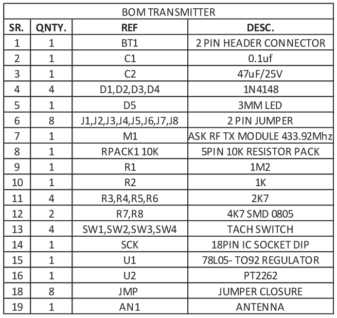

4-Channel-RF-Remote-Controller-BOM-TX

4-Channel-RF-Remote-Controller-WIRING-RX

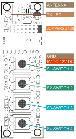

4-Channel-RF-Remote-Controller-WIRING-TX

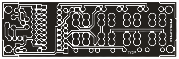

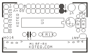

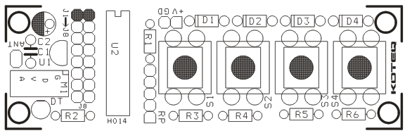

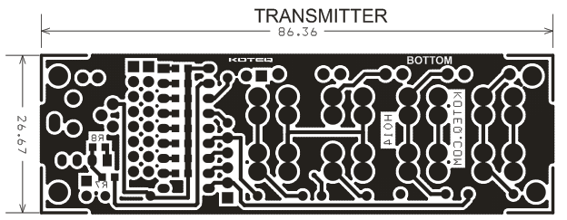

PCB

Where are R7 and R8 on the PCB layout ?
Rajesh Thakur
Ok. Can i use normal 4.7 K resistor instead ?
