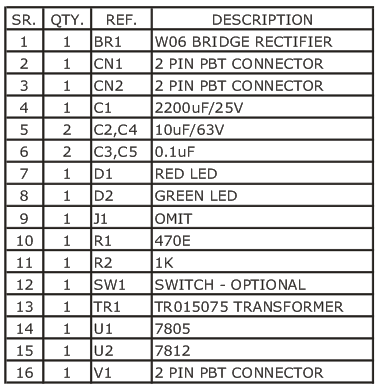

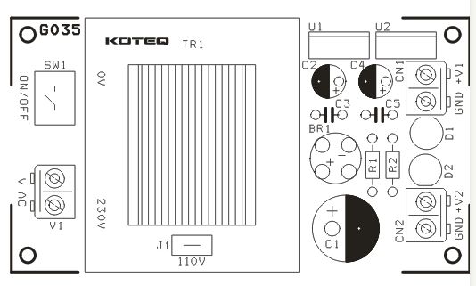

what is j1 OMIT i cant understand
It means not to be used.

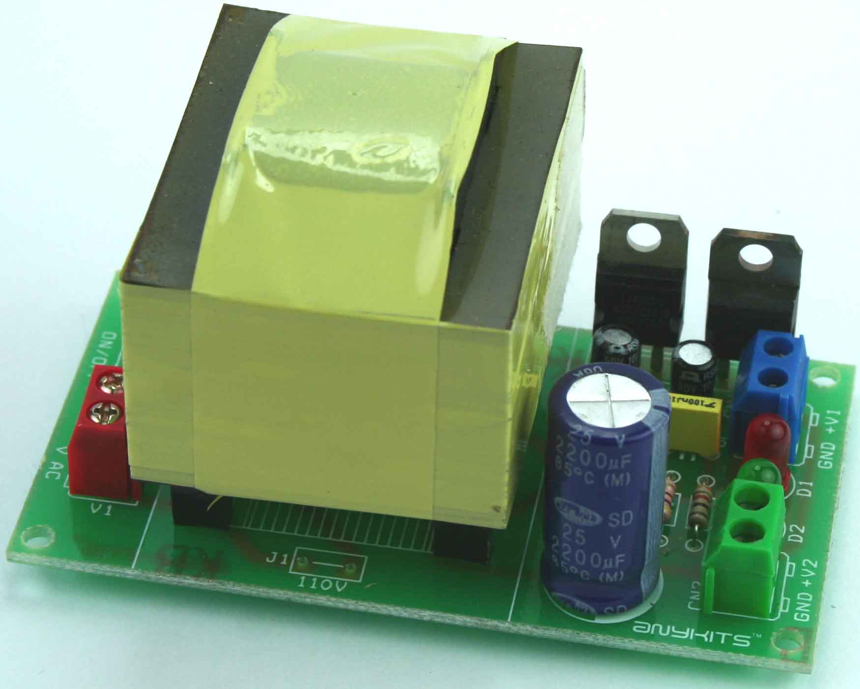

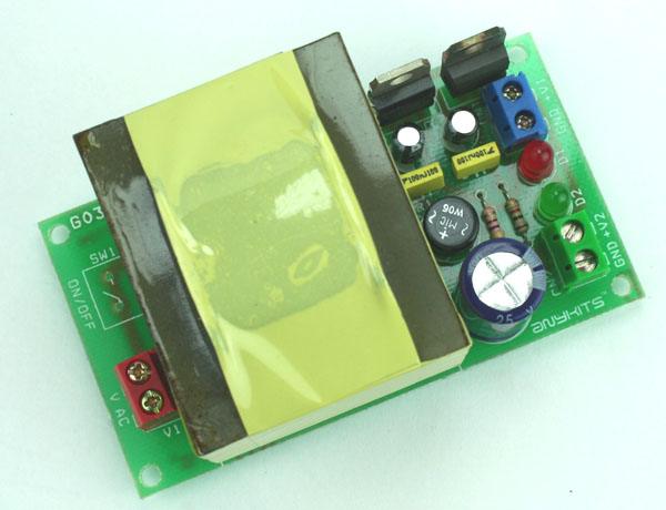

Regulator ICs without heatsinks? For 600mA itsok but what component will limit the current not to be exceeded?for 7805 … input voltage is already much greater than the output 5volts… the more that difference…IC needs to be heatsinked… how is this circuit tested?
Yes, this board requires a heatsink to deliver the full output power. It’s just not present on the photos.
