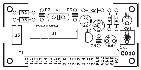

  1. Power input to the board is applied at Pin #1 and #2
  2. Regulated power is available at Pin# 4 of Connector J1
  3. An Onboard Reset Switch offers a easy way to reset the Microcontroller
  4. LED D1 indicates power on board

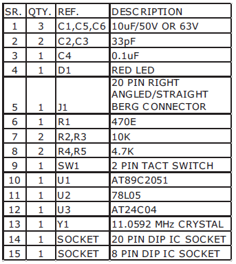

  5. Optionally, a 24C04 EEPROM on the module can help you store valuable data on it for your project
  6. If you don’t wish to use the EEPROM you can omit to assemble R4, R5 and U3
  7. If you plan to power this module from your Project PCB then you can omit to assemble U2, C6
  8. Crystal supplied with this kit is 11.0592 MHz. If you intend to use other frequency crystal, please replace Y1, C2 and C3 components as per specification mentioned in the data sheet of the Microcontroller

Parts List
AT89C2051_DEV_STICK_BOM

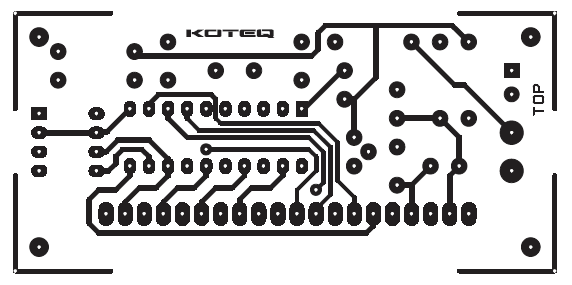

PCB

Looks like this page is a full schematic, parts list, and circuit board. You cut the board, get the parts, and assemble it.
