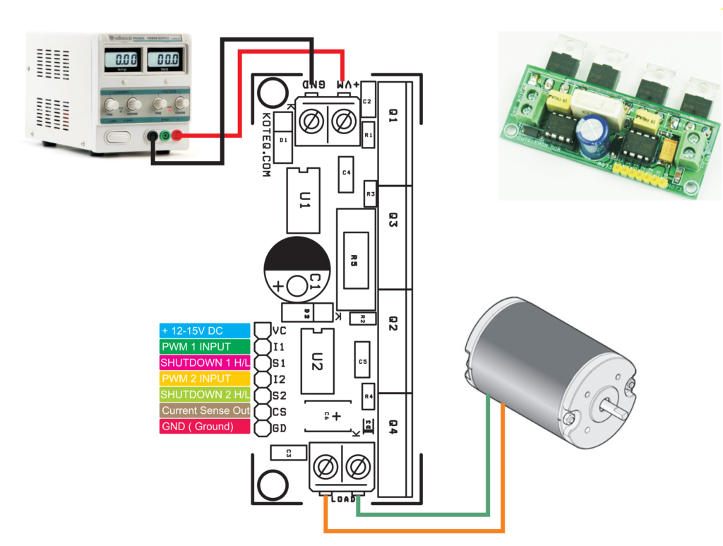

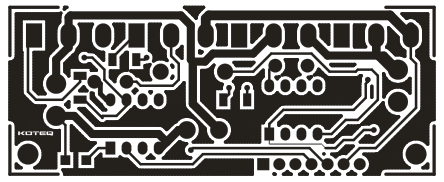

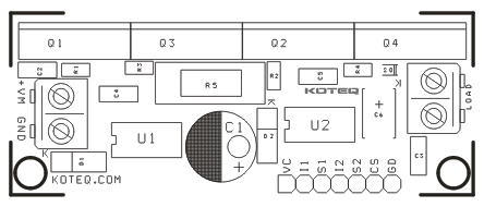

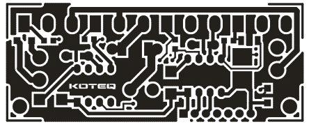

H-Bridge has been designed around IR2104 IC from International Rectifier. The board has been made mainly for DC-Motor applications. The driver can handle a load up to 8-10Amps. I have tested this board with 36V DC supply . The circuit also uses N Channel IR540 MOSFETS from International rectifier. IR540 requires large heat sink for 10Amps load. Board has shunt resistor to provide voltage proportional to current flowing through load. This can be later amplified and read from microcontroller ADC. This H-bridge can be used to control DC Motor speed and direction, DC-DC Converters, HMI lamp driver etc.
- Motor DC Supply 36V DC (Screw Terminal Connector)
- Logic Supply 12V DC
- Load 8-10Amps (Screw Terminal Connector)
- Header Connector for Inputs (7 Pin Header Connector)
- On Board Shunt Resistor for Current feedback
- PWM Frequency 10 to 20 KHz
- Duty Cycle 0-99%
- Logic Pins support 3.3V, 5V, 12V (Inputs and PWM)

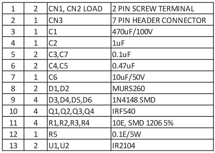

Parts List

To drive the H-Bridge you will need a microcontroller or Arduino board to produce a PWM wave with frequency 20Khz and adjustable 0-99% Duty Cycle.
For Forwarding Direction Operation:
- IN1 Requires High PWM
- IN2 Requires Low PWM
For Reverse Direction Operation:
- IN1 Requires Low PWM
- IN2 Requires High PWM

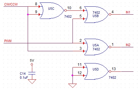

For Standalone use you will need a PWM Generator and pulse sequencer circuit, please find attached sequencer circuit.

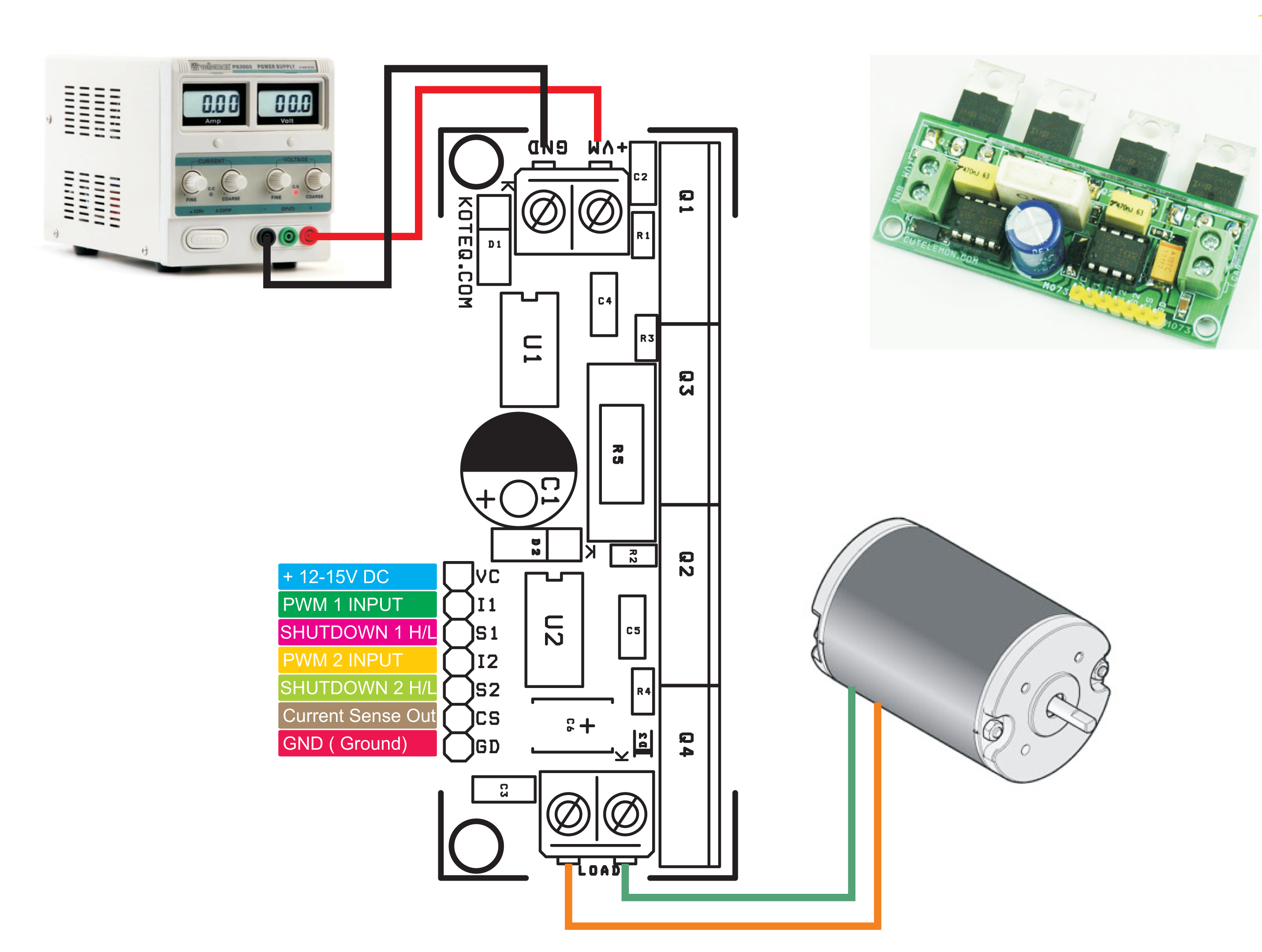

Hello,
Can you please tell what is the driving principle?
Hi, I have uploaded the waveforms needed to be present in IN1 and IN2 to control the motor in forward and reverse operation. In general an H-bridge can be used to control the direction and speed of a motor and this particular one need 2x PWM signals 20KHz with adjustable duty cycle.
How can I increase the load that their drivers can handle?
This motor driver can output a maximum of 8-10A current. Unfortunately this is the maximum output power. For more power you will need a different circuit.
