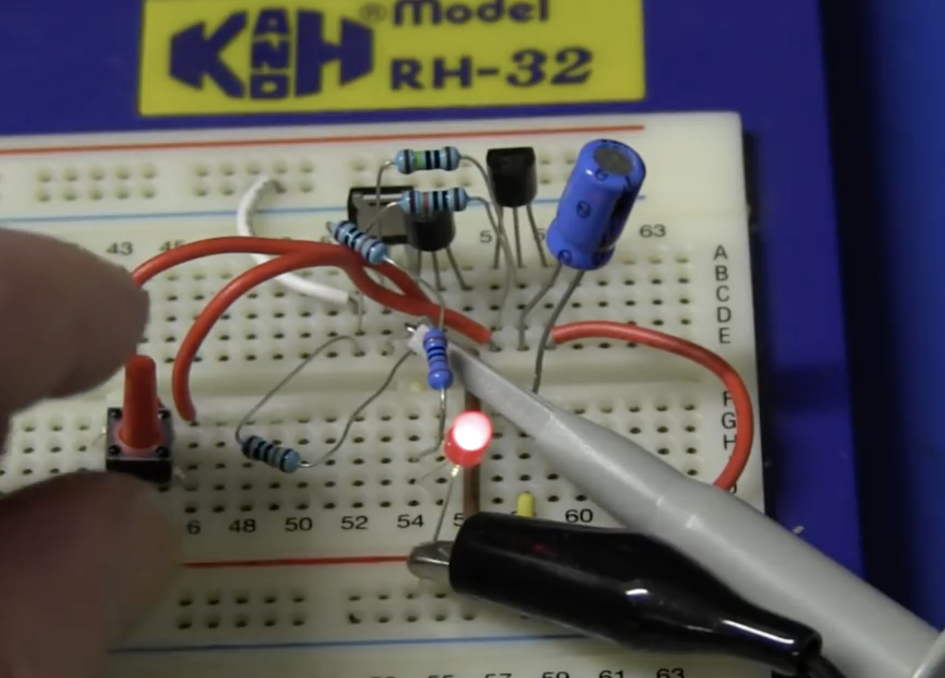

With the design done, its time to test things out. Connect the components as shown in the main schematics. You should see the LED go on and off in line with the switch press.
![](https://www.electronics-lab.com/wp-content/uploads/2019/05/Screen-Shot-2019-05-11-at-3.06.46-AM-e1557540673835.png)
That’s it, this could easily replace mechanical latching toggle switch in your project. Try experimenting with the resistor and capacitor values to observe performance under different conditions.
