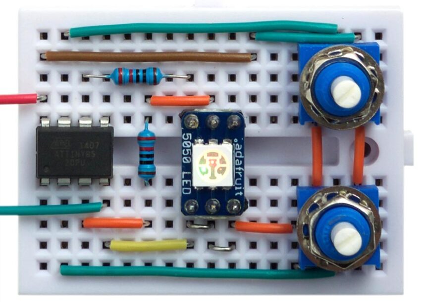

10 or 12-bit DAC from the ATtiny85
David Johnson-Davies @ technoblogy.com writes: This article describes how to get up to two 10 or 12-bit digital-to-analogue outputs from an 8-bit Timer/Counter, such as in the ATtiny85. To test the routine I built a circuit which allows you to vary the brightness of two LEDs with two potentiome... Read More
