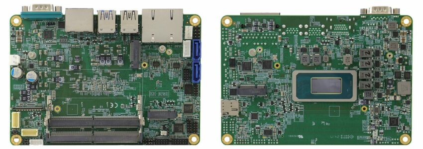

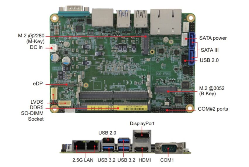

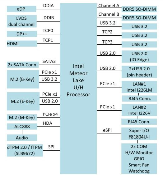

The iBASE Technology IB962 is a 3.5-inch SBC built on 14th Gen Intel Core Ultra 7/5 processors from the 100 series (formerly Meteor Lake U/H). It features Intel’s 3D hybrid architecture for advanced AI and computing performance and integrates an Intel Arc GPU for efficient AI graphics processing. The SBC is designed for applications such as industrial automation, retail, manufacturing, healthcare, and edge AI.
The IB962 supports up to 64GB of DDR5 RAM through two SO-DIMM slots and provides versatile display options, including HDMI, DP++, LVDS, and eDP interfaces, enabling multiple high-resolution display connections. Networking capabilities are enhanced by dual Intel Ethernet ports (I226LM and I226V, both 2.5Gbps), ensuring high-speed and reliable connectivity. Expansion is facilitated by three M.2 slots (M-Key, E-Key, B-Key), accommodating additional storage, wireless modules, and 5G connectivity. Multiple I/O interfaces, including USB 3.2, USB 2.0, and COM ports, enhance device compatibility.
The SBC operates with a wide 12V to 24V DC input range, making it suitable for various environments. It includes features like 5G support, digital I/O, dTPM/fTPM for secure operations, and a watchdog timer for system reliability. Compatibility with AI frameworks like OpenVINO, WindowsML, DirectML, and ONNX Runtime enables efficient AI and ML task processing without overloading CPU or GPU cores.

The iBASE IB962 Specifications:
  • SoC: 14th Gen Intel Core Ultra 7/5 100 Series processors
    • Intel Core Ultra 7 165H 16-core processor @ 5.0 GHz, 24 MB L3 cache, Intel Arc graphics (8 cores) @ 2.3 GHz; TDP: 28W
    • Intel Core Ultra 7 165U 12-core processor @ 4.9 GHz with 12MB cache, Intel 4Xe LPG graphics @ 2.0 GHz; TDP: 15W
    • Intel Core Ultra 5 135H 14-core processor @ 4.6 GHz with 18 MB L3 cache, Intel Arc graphics (8 cores) @ 2.3 GHz; TDP: 28W
    • Intel Core Ultra 5 135U 12-core processor @ 4.4 GHz with 12MB cache, Intel 4Xe LPG graphics @ 1.9 GHz; TDP: 15W
  • GPU: Intel 14th Gen. Core series built-in Iris Xe Graphics
  • BIOS: AMI
  • Memory: 2x Up to 64GB DDR5 SO-DIMM, 5600MT/s, Non-ECC
  • Storage
    • 2x SATA III ports
    • M.2 2280 M-Key socket for NVMe SSD
  • Video
    • eDP: Resolution up to 7680 x 4320 @ 30Hz
    • LVDS: Resolution up to 1920 x 1200 @ 60 Hz
    • DisplayPort 1.4a: 1x (DP++) @ edge connector – Resolution up to 7680 x 4320 @ 30Hz
    • HDMI 2.0: 1x @ edge connector – Resolution up to 3840 x 2160 @ 60Hz
  • Audio: 14th Gen Intel Core Ultra Series processor built-in HD audio + Realtek ALC888S codec
  • Networking
    • 2x RJ45 port for 2.5 Gigabit Ethernet (Intel I226LM as 1st LAN, I226V as 2nd LAN )
    • Optional M.2 socket for 5G/LTE
  • USB
    • 3x USB 2.0 (1x Type-A, 2x via pin header)
    • 3x USB 3.2
  • Serial: 2x RS232/422/485
  • Security: Discrete TPM
  • Expansions
    • 1x M.2 (M-Key, Type:2280, supports NVMe with PCl-E(4x) signal only)
    • 1x M.2 (E-Key, Type:2230, supports CNVi)
    • 1x M.2 (B-Key, Type:3052, supports 5G/LTE)
    • Digital IO: 4-In & 4-Out
  • Misc
    • 266 levels of Watchdog Timer
    • H/W Monitor
    • Fintek F81804U-I I/O chipset on board
  • Power supply: +12V (-10% tolerance) ~ +24V (+10% tolerance) DC-in
  • Dimensions (L x W): 102.22 mm x 147.01 mm (3.5-inch form factor)
  • Operating Temperature: 0°C~60°C (32°F~140°F)
  • Storage Temperature: -20°C~80°C (-4°F~176°F)
  • Relative Humidity: 10% ~ 90% (non-condensing)
  • Certification: CE, FCC Class B
3.5-inch iBASE IB962 SBC specifications
Although the IB962 is not a true single-board computer (SBC) due to its lack of integrated memory—it requires the installation of DDR5 SO-DIMMs, supporting up to 64GB—it is designed to fit into applications similar to those of fully integrated SBCs. A key feature of the IB962 is Intel AI Boost, an embedded neural coprocessor that accelerates on-device machine learning, computer vision, and AI workloads.
The IB962 serves as a larger alternative to AAEON’s PICO-MTU4 Pico-ITX SBC. It offers compatibility with the Windows 10 operating system and Ubuntu/Fedora Linux distributions. While the user manual includes instructions for installing drivers and software, the product page does not currently provide driver download links.
The IB962 3.5-inch Intel Core Ultra “Meteor Lake” SBC is available for purchase through iBASE, Fortec Integrated, and Mouser Electronics. Detailed information about the board can be found on the iBASE website. Pricing has not been publicly disclosed, so interested buyers are encouraged to request a price quote directly.
