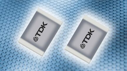

IXYS Integrated Circuits has a PLA172P series 800 V normally-open solid state relay with 105°C specs and 5000 VRMS input-to-output isolation. It is offered in a single-pole, normally open (1 Form A) configuration with a unique device pinout. This provides more than 6.8 mm of pad-to-pad separation between the high voltage output pins that can accommodate peak load voltage of 800 V. It features a rugged design built from UL 94 V-0 materials with a guaranteed operating temperature range of -40°C to +105°C.
  • Guaranteed specifications at +105°C
  • Operational temperature range: -40°C to +105°C
  • 5 mA input control current over operating temperature range
  • 800 VP blocking voltage
  • 6.8 mm pad-to-pad separation of output pins
  • 5,000 VRMS input/output isolation
  • Small surface-mount package
  • Arc-free with no snubbing circuits
  • No EMI/RFI generation
  • Flammability rating UL 94 V-0
