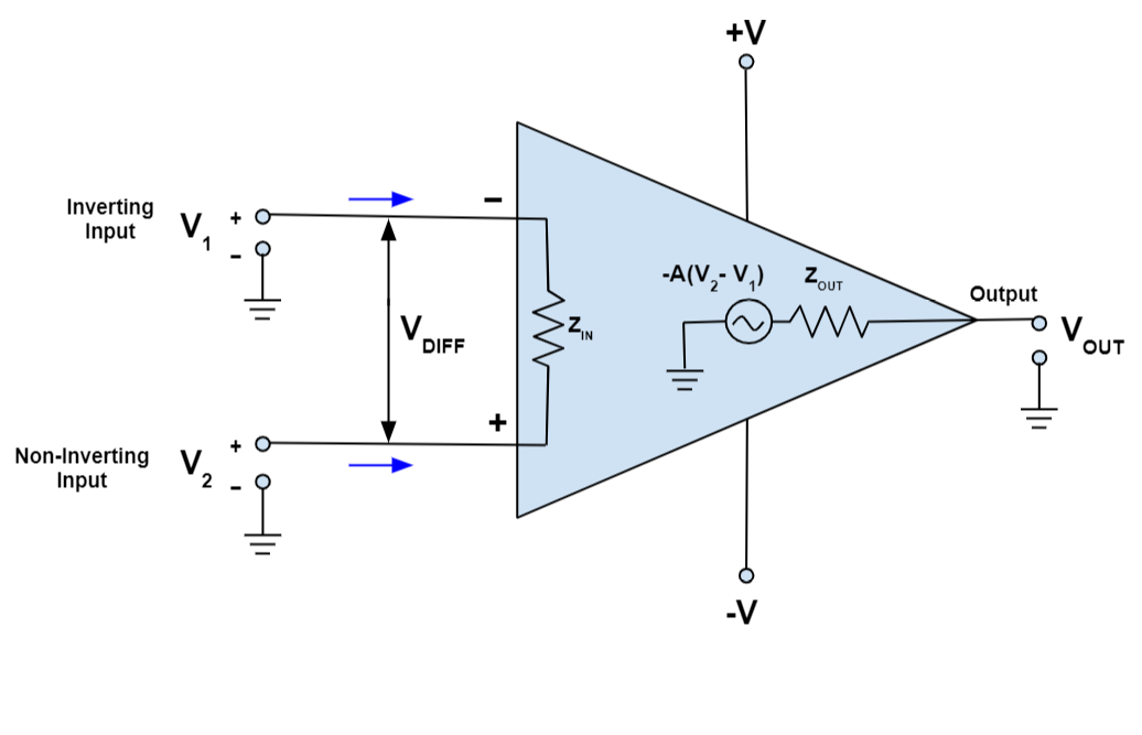

What is an operational amplifier (op-amp), and how does it function within electronic circuits? Also what are the key components of an OPAMP ?

An OPAMP (Operational Amplifier) is a type of electronic amplifier with a high gain, high input impedance, and low output impedance. It is typically implemented as an integrated circuit (IC) and is widely used in various electronic circuits and systems.
The basic function of an op-amp is to amplify an input signal. It takes an input voltage and produces an output voltage that is a scaled version of the input voltage. The amplification factor, known as the gain, can be very high, ranging from thousands to millions.

In more details, it is an electronic device that amplifies the difference between two input voltages and produces an output voltage that is a scaled version of this difference. It consists of a differential amplifier stage followed by additional circuitry to provide high gain, high input impedance, low output impedance, and other desirable characteristics.
Here are the key components and features of an op-amp:
  • Differential Amplifier: The heart of an op-amp is the differential amplifier, which amplifies the voltage difference between its two input terminals (inverting and non-inverting). The amplified difference is referred to as the differential voltage or voltage gain (A_d).
  • High Gain: Op-amps are designed to have very high open-loop voltage gain (A_ol), typically in the range of tens of thousands to millions. This allows them to amplify small input signals significantly.
  • Input Impedance: Op-amps have extremely high input impedance, often in the range of megaohms to gigaohms. This means that they draw negligible current from the input source, minimizing loading effects and ensuring that the input signal is not significantly affected.
  • Output Impedance: The output impedance of an op-amp is typically very low, often in the range of tens of ohms or less. This allows the op-amp to drive loads without introducing significant voltage drop or distortion.
  • Power Supply: Op-amps require a power supply to operate. They usually have dual power supply pins (positive and negative) or a single supply pin (positive) with a ground reference. The power supply voltages determine the maximum output swing and influence the op-amp’s operating range.
  • Feedback: Op-amps are often used in feedback configurations, where a fraction of the output voltage is fed back to the input. Feedback enables precise control of gain, stability, linearity, and other characteristics of the op-amp circuit.
  • Op-Amp Parameters: Op-amps have various parameters that define their performance, such as gain bandwidth product (GBW), slew rate, input offset voltage, input bias current, and common-mode rejection ratio (CMRR). These parameters impact the op-amp’s behavior and suitability for specific applications.
  • Package Types: Op-amps are available in different package types, such as dual in-line package (DIP), small outline integrated circuit (SOIC), and surface-mount technology (SMT) packages. The package type determines the physical dimensions and pin configuration of the op-amp.
It’s important to note that while op-amps are designed for amplification, their actual function depends on how they are used in a circuit. By configuring external resistors, capacitors, and feedback networks, op-amps can perform a wide variety of tasks, including amplification, filtering, signal conditioning, and more.
