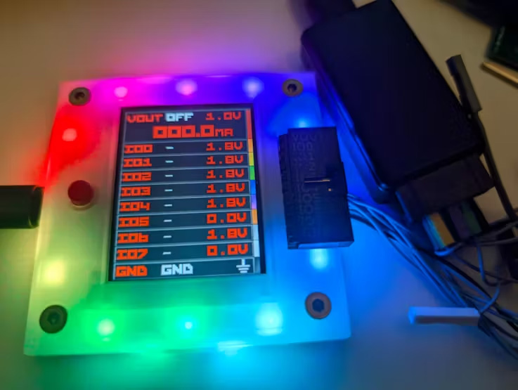

Dangerous Prototypes’ Ian Lesnet first found the bug, he explains the issue was confirmed as an erratum in Raspberry Pi’s official documentation for the newly-launched dual-architecture RP2350 microcontroller family.
“When a GPIO pin is an input with the pull-down resistor enabled, it acts like a bus hold. We use the pull-down on the button, which connects to 3.3V when pressed. During the self-test pressing the button works, but then it never goes low again, it sits at 2.15V…”

But there’s a simpler solution if you have more flexibility with your design that is to use a different part of the pin (the “pull-up resistor”) instead. This part isn’t affected by the bug. This bug was first discovered by Ian Lesnet, who was working on debugging tools for Bus Pirate 5XL and Bus Pirate 6. He had to find creative ways to work around the problem in his designs. He ended up using the “pull-up resistors” for buttons and also made some changes to other parts of the circuit to make things work correctly.
