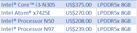

The AQ7-ADN is available for order via the eShop, priced as follows:
