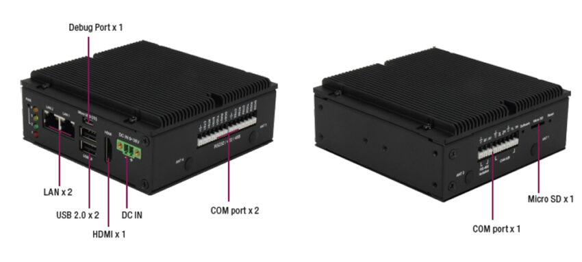

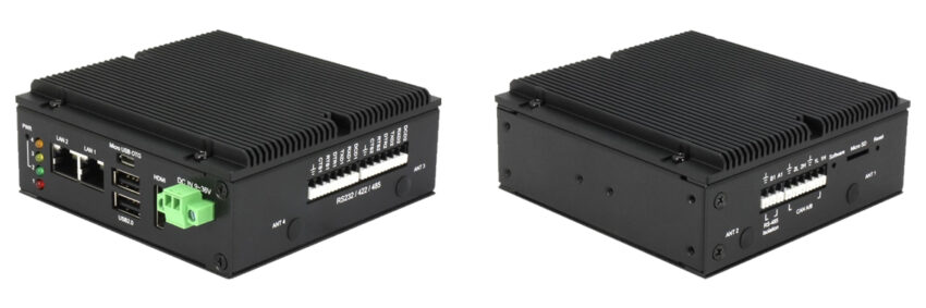

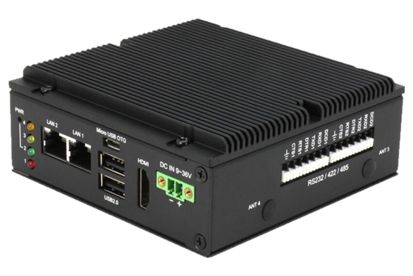

AAEON has recently launched the SRG-CM4, a RISC gateway board featuring a Broadcom BCM2711 quad-core Cortex-A72 SoC running at 1.5 GHz. This compute module 4 (CM4) is specially designed for industrial and IoT applications, offering high-performance and flexible connectivity options. The board supports up to 8 GB of LPDDR4 memory, eMMC 5.1 storage (8 GB to 16 GB), and provides dual Gigabit Ethernet ports, multiple USB 2.0 ports, and RS-232/422/485 serial interfaces, with RS-485 featuring isolation. Additional interfaces with isolation include HDMI, CAN 2.0 A/B, TPM 2.0, and DI/DO. It has a wide operating temperature range of -20°C to 70°C, supports a 9V to 36V power input, and can be mounted using wall or DIN rail kits. It supports the Raspberry Pi Desktop OS and Debian 11, making it a flexible and reliable choice for embedded systems and edge computing deployments.

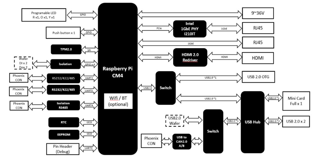

SRG-CM4 RISC Gateway Board Specifications:
  • SoC: Broadcom BCM2711 quad-core Cortex-A72 @ 1.5GHz
  • Memory: Up to 8GB LPDDR4 (onboard)
  • Storage:
    • eMMC 5.1 (8GB/16GB/32GB options)
    • MicroSD card slot (optional, without eMMC)
  • Networking:
    • 2x Gigabit Ethernet (RJ45)
  • Display:
    • 1x HDMI 1.4 (up to 4K @ 30fps or 1080p with SD card storage)
  • USB:
    • 2x USB 2.0
    • 1x USB 2.0 OTG
  • Serial Interfaces:
    • 2x RS-232/422/485 switchable
    • 1x RS-485 with isolation (optional)
  • Expansion:
    • 1x Full-sized mini PCIe card slot (USB signal)
  • GPIO:
    • 2x DI / 2x DO with isolation
  • CAN Bus:
    • 2x CAN 2.0 A/B
  • Misclenious:
    • 1x RTC with 3V CR2032H Lithium battery
    • 3x Programmable LED control
    • Power LED indicator
  • Buttons:
    • Software button x 1
    • Power button x 1
    • Reset button x 1
  • Debug: 1x UART (internal wafer box)
  • Security: TPM 2.0 (optional)
  • Power:
    • 9V to 36V DC input via 2-pin Phoenix connector
    • Power consumption: 12.6W
    • MTBF: 1,311,814 Hours
  • Dimensions: 104.4 x 105 x 41 mm
  • Weight: 490 gm
  • Mounting Options: Wall mount, DIN rail (optional)
  • Environmental:
    • Operating temperature: -20°C to 70°C
    • Storage temperature: -40°C to 80°C
    • Humidity: 10% to 90% relative humidity, non-condensing
  • Operating System: Raspberry Pi OS (Desktop), Debian 11
  • Certifications: CE/FCC Class A

SRG-CM4 block diagram
