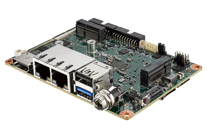

Advantech, a leading industrial embedded AI solution provider, is pleased to release the RSB-3810. A 2.5” Pico-ITX SBC that adopts MediaTek’s flagship chipset Genio 1200. This solution enables responsive AI inference capabilities up to 4.8 TOPS with 8-watt power efficiency. It also integrates MediaTek’s 5G and Wi-Fi 6 connectivity to empower IoT applications at the edge including robotics, and industrial IoT.
Powerful and Efficient with Multitasking Performance for IoT Applications
MediaTek’s Genio 1200 chipset is at the core of the RSB-3810 and boasts a robust octa-core CPU configuration. It features 4 x premium Arm Cortex-A78 and 4 x Cortex-A55 processors, all integrated into an advanced 6nm-class chip. The result is exceptional power efficiency, with the RSB-3810 consuming a mere 8 watts while effortlessly handling compute-intensive workloads. To enable seamless on-device AI processing for deep learning, Neural Network (NN) acceleration, and machine vision applications, the Genio 1200 chipset incorporates a dedicated dual-core AI processing unit (APU). This specialized unit delivers an impressive 4.8 TOPS of performance, enhancing the RSB-3810’s capabilities in AI-driven tasks. By effectively offloading tasks from the host CPU, this intelligent architecture achieves an optimal balance between system performance and power consumption.
RSB-3810 Key Features
- MediaTek Genio 1200 with 4 cores A78 & 4 cores A55, onboard 8GB LPDDR4
- HDMI 4k60fps, 1 x Dual Channel 24 bit LVDS
- 1 x 4-wire RS-232/422/485, 2 x USB3.2 Gen1 By 1
- 1 x M.2 3052 Key B for 5G, 1 x M.2 2230 Key E Slot for Wi-Fi 6/BT
- Rugged design: 0 ~ 60 °C / -40 ~ 85 °C / 3.5Grms
- Rear I/O expandable with UIO40-Express I/O boards
- Supports Ubuntu, Android, and ROS2 Suite
Seamless Image Processing with Ultra-Low Latency Transmission
The RSB-3810 offers exceptional camera input capabilities via 3 x MIPI-CSI and USB 3.0 ports, featuring an embedded starlight-grade ISP. This enables intelligent vision-based systems to operate effectively even in extremely low-light conditions. With the incorporation of the Mali-G57 chipset, the RSB-3810 supports H265 4K60 video capture and 4K90 image processing to accommodate a wide range of AI applications. Additionally, it facilitates multi-display setups with 1 x 4Kp60 HDMI, and 1 x dual-channel LVDS.
In terms of connectivity, the RSB-3810 provides the necessary I/O interfaces for advanced network and peripheral connections, including 1 x M.2 3052 Key B, and 1 x M.2 2230 Key E Slot. This allows seamless integration with MediaTek’s 5G and Wi-Fi 6/BT networking modules. Furthermore, GbE TSN (Time-Sensitive Networking) is supported as an application protocol for efficient data transmission in monitoring systems and equipment. These features make the RSB-3810 an ideal solution for edge computing applications in industrial IoT and surveillance domains.
