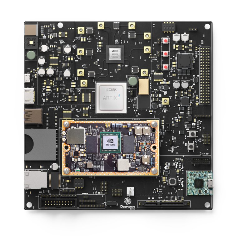

While we have seen Artificial Intelligence already been implemented in a host of applications like speech recognition, gaming and autonomous vehicles, we are yet to see it being adapted for software-defined radio or incorporated into an RF hardware solution. This is why Deepwave Digital, a hardware and software solutions provider, has taken it upon themselves to come up with a Software-defined Radio with deep-learning muscle, called AIR-T.
AIR-T is a board that combines both high-end hardware and RF deep learning for SDR. AIR-T is equipped with three signal processors: a NVIDIA Jetson TX2 for signal processing and deep learning applications, a Xilinx Artix 7 FPGA for real-time operations and integrated CPUs for I/O, hardware, and software applications. The system also has a dual-channel MIMO transceiver with two 100MHz RX channels and two 250MHz TX channels, along with a rich set of connecting options including GPS Sync via 1 PPS and 10MHz, Ethernet, Wi-Fi, Bluetooth, HDMI, USB 2.0/3.0, SATA, and high-speed digital I/O.
“This versatile system can function as a highly parallel SDR, data recorder, or inference engine for deep learning algorithms. The embedded GPU allows for SDR applications to process bandwidths greater than 200 MHz in real-time.” says Deepwave. “The AIR-T also uses zero copy memory access to overcome the data transfer overhead typically associated with GPU processing.”

  • Dual Channel MIMO Transceiver with:
    • 300 MHz to 6 GHz
    • A pair of 100 MHz bandwidth Rx channels, and,
    • Two 250 MHz bandwidth Tx channels
  • Xilinx Artix 7 FPGA
  • NVIDIA Jetson TX2
  • Quad-core ARM Cortex-A57 CPU
  • Dual-core NVIDIA Denver2 CPU
  • 256-core NVIDIA Pascal GPU
  • 8 GB of memory
  • USB 3.0, USB 2.0/3.0,
  • 1x SATA port
  • High-speed digital GPIO/UART
  • 1 Gbps Ethernet
  • WiFi
  • Bluetooth
  • GPS Sync via 1 PPS and 10 MHz
  • Dual Power Mode: 22/14 W
  • Dimensions: 17.0 cm x 17.0 cm x 3.5 cm
  • Weight: 0.35 kg
  • Operating System: Ubuntu 16.04
AIR-T is mentioned to be Ubuntu 16.04 along with a custom GNURadio block, with an option of programming the GPU using Python or C++.
