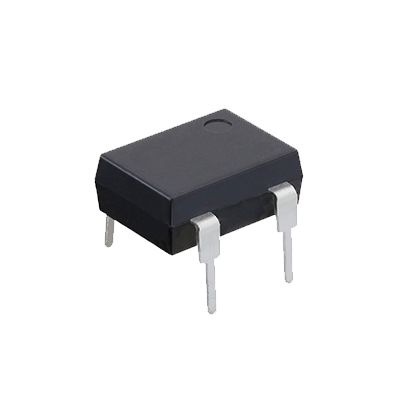

Panasonic’s relays come in a DIP6 package for high-voltage control and are ideal for industrial battery monitoring systems (BMS)
Panasonic’s AQV258H5 series HE 1 Form A Type PhotoMOS® relays offer 1,500 V high-voltage. These relays provide high voltage switching reliability and application safety in BMS. The AQV258H5 series can be utilized in applications where traditional electromechanical relays are already being used. Replacing a standard electromechanical relay with PhotoMOS can provide benefits such as better resistance to shock and vibration, low on-resistance, and a theoretically infinite life cycle. This makes PhotoMOS relays a very good solution for BMS, test and measurement, electrical power, and industrial markets. Panasonic PhotoMOS relays are suitable in the measurement market, security equipment, fire prevention systems, and industrial machines.
  • High capacity
  • Load current: 20 mA
  • Load voltage: 1,500 V
  • I/O isolation voltage: 5,000 VRMS
  • Distance between output terminals expanded to cater to a 6-pin DIP package:
    • Higher factor of safety when operating battery monitoring applications
  • Packaging options: tube and tape/reel
  • UL recognized and C-UL certified
  • RoHS/REACH compliant
  • Able to switch high voltage load
  • Suitable for battery monitoring and low signal controls
