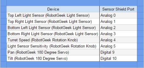

Place the light sensors in correct position and wire them to Arduino accordingly. Any wrong positioning can generate strange behavior of the system. Jumpers for the servos (pin 9, 10, and 11) are set to VIN, so that your servos function properly.
(NOTE: A 6V power supply will work just fine, and RoboTurret Kit includes one). Here is the chart of wiring:
![Wiring list of servo and Arduino : Sun tracker](https://www.electronics-lab.com/wp-content/uploads/2016/11/Wiring-list-of-Servo-and-Arduino-Sun-tracker.jpg)
There are two potentiometers. One is for controlling the speed of servos, and another is for controlling the sensitivity of sensors.

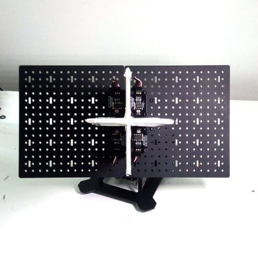

You should follow Desktop RoboTurret Assembly Guide to build the turret. After building, attach your sensors to the top plates as close to center as possible. Look at the picture:
![Sensor Positions On Turret](https://www.electronics-lab.com/wp-content/uploads/2016/11/Sensor-Positions-On-Turret.jpg)
The “+” shaped fins cast shadow on sensors. So, position of sensors should be correct else fins can’t cast shadow on them accurately. Have a close view on sensor’s position:
![Sensor position on turret : close lookup](https://www.electronics-lab.com/wp-content/uploads/2016/11/Sensor-position-on-turret-close-lookup.jpg)

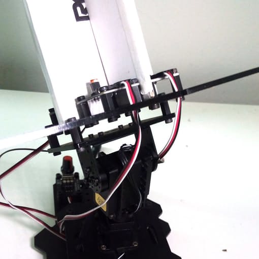

While wiring through the plate, keep wires loose enough so that turret can move freely to aim at the Sun. At the back of the turret base, there is plenty of room to mount the two potentiometers.
The fins are 8 inches tall, which should be plenty to cast shadow on the sensors. I’ve used scrap cardboard for the fins, but you can use whatever material suits you best, so long as it is opaque and can throw a shadow.
