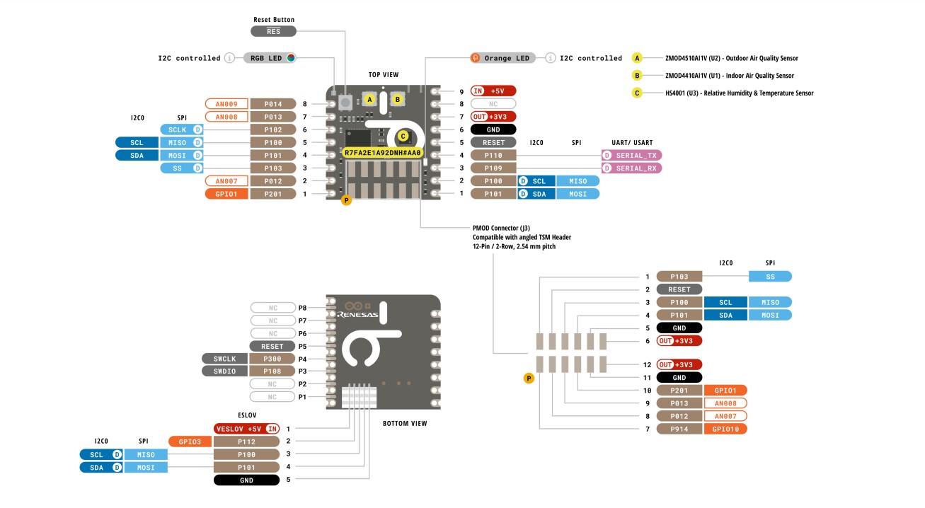

The Nicla Sense Env is equipped with a 48 MHz Arm Cortex M23 microcontroller, which cannot be accessed or programmed by the user. Additionally, it features 128 kB of Flash memory and 16 kB of SRAM. The analog peripherals include two 12-bit ADCs while the digital interfaces are provided through UART, I2C, and SPI connections. The board includes onboard sensors for monitoring environmental conditions:
  • A Renesas HS4001 humidity and temperature sensor
  • A Renesas  ZMOD4410AI1V sensor for indoor air quality (detecting volatile organic compounds, CO₂, and general air quality)
  • A Renesas ZMOD4510AI1V sensor for outdoor air quality (monitoring nitrogen dioxide, ozone, and other pollutants).
As mentioned earlier It has small dimensions of 22.86 mm x 22.86 mm and weighs only 2 grams. It has castellated pins for easy mounting on custom boards. It can be powered either by a connected Portenta, MKR, or Nano board or through an external supply via VCC pins. The board integrates smoothly with Portenta boards using ESLOV (I2C) or header pins. It also supports programming with both Arduino IDE and MicroPython, making it easy to set up and customize. The board’s compatibility with Arduino libraries and tutorials helps users quickly implement environmental monitoring in their projects.
