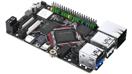

Introduction

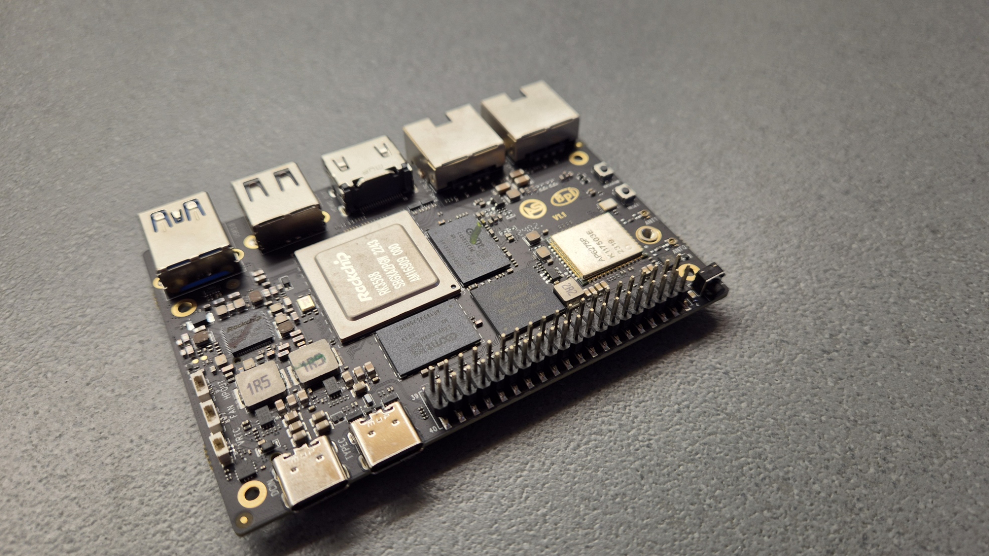

The ArmSoM Sige7 is a compact single-board computer (SBC) powered by the RK3588, an octa-core 64-bit SoC clocked at 2.4 GHz. The SoC features a 6TOPS NPU for AI tasks and supports up to 32GB of LPDDR4x RAM and 128GB of eMMC flash storage. It includes an M.2 2280 socket for NVMe SSDs. It offers three display interfaces (HDMI, USB-C, MIPI DSI) and two camera connectors. Connectivity options include dual 2.5GbE, WiFi 6, and Bluetooth 5.2, plus multiple USB ports and a 40-pin GPIO header for expansion.
The SoC features the ARM Mali-G610 MP4 GPU clocked at 1GHz, which delivers high-performance graphic capabilities so much that it can play or stream 4K very smoothly. This GPU also features enhanced 3D rendering which allows for lag-free gameplay in major open-world online games, console games, and even some AAA titles, this feature makes this device suitable for a broad spectrum of gaming enthusiasts looking for a powerful, compact computing solution.

Triple Display Interface
The most interesting feature for me is the triple display interface, When you think about applications where you will need a triple display like video editing graphic design 3d modeling, the board is not powerful enough to run that application. But it will shine when it comes to Trading, you can just use this device as a multiple equities monitoring device.

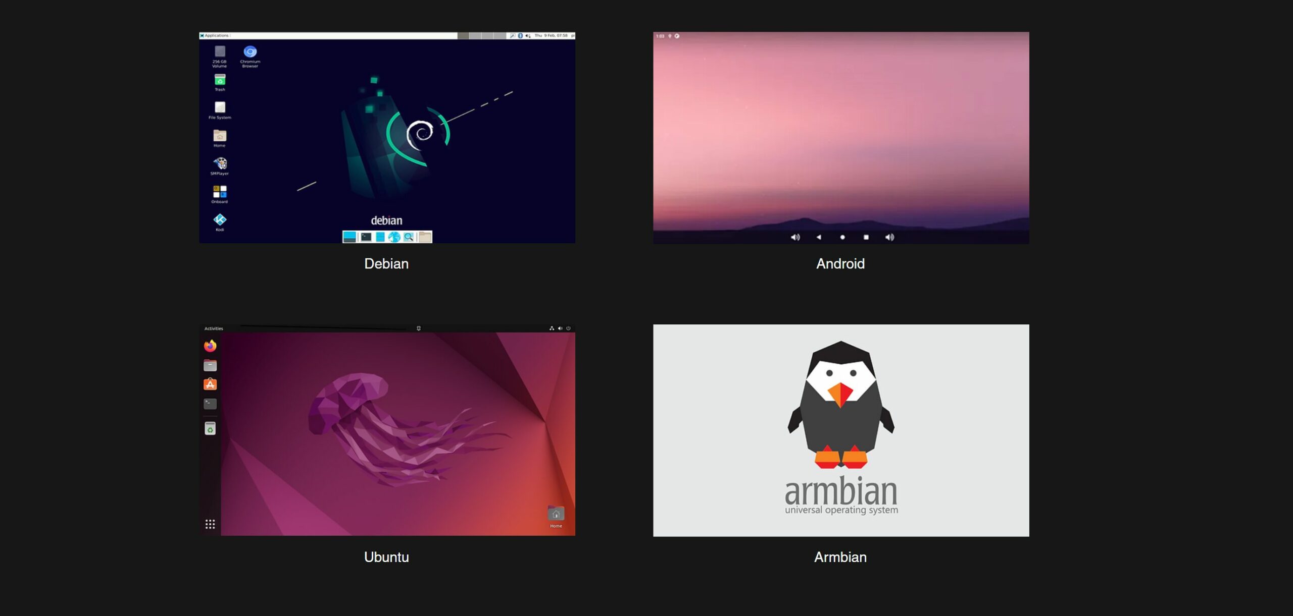

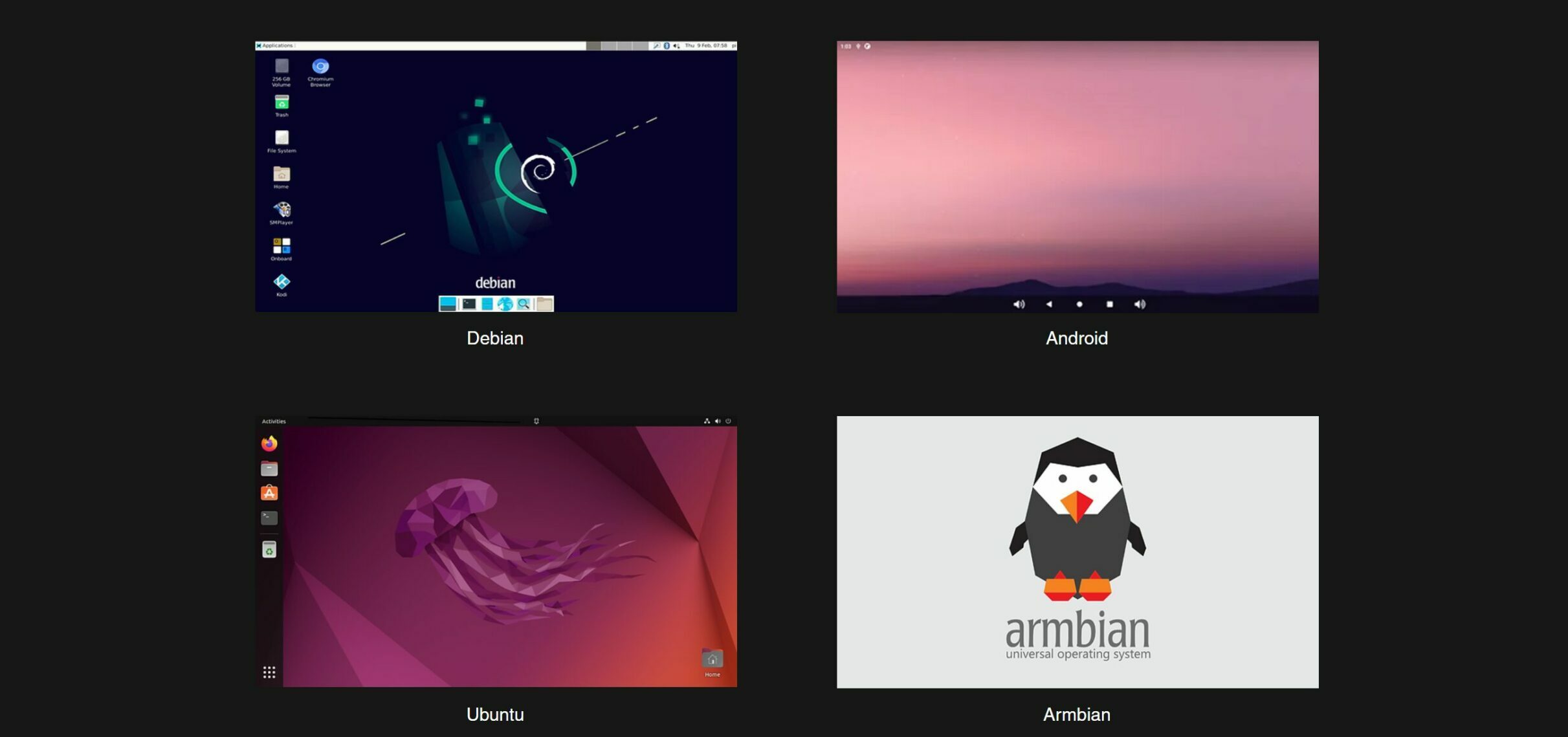

The board supports Debian 11 and Android 12, based on Linux 5.10, and is compatible with the Buildroot build system. Additionally, third-party Armbian images (Ubuntu 20.04, Ubuntu 22.04) and Kylin OS are available. The wiki currently has direct links to these images.
Update! In a recent update, the company tells electronics-lab.com that they have “successfully integrated Linux into the mainline” meaning the developers have ensured that their ArmSoM-Sige7 device will be compatible with the widest range of standard Linux distributions and software. This avoids the need to maintain custom versions of Linux. Mainline support ensures that the Sige7 will benefit from future bug fixes, security patches, and new features added to the Linux kernel over time.

Performance Results

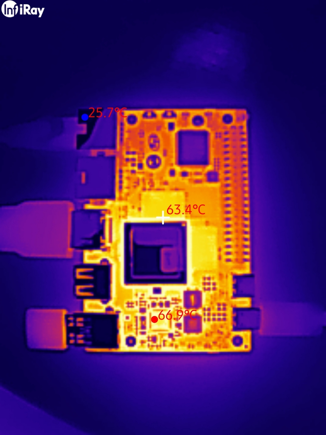

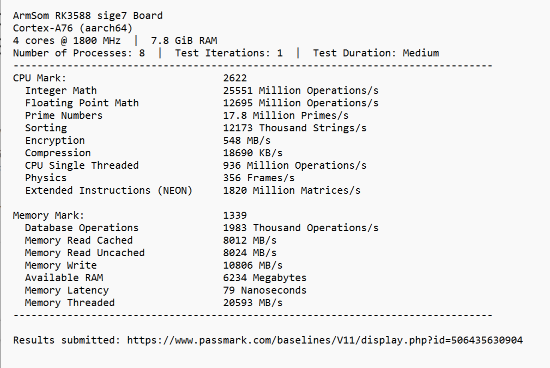

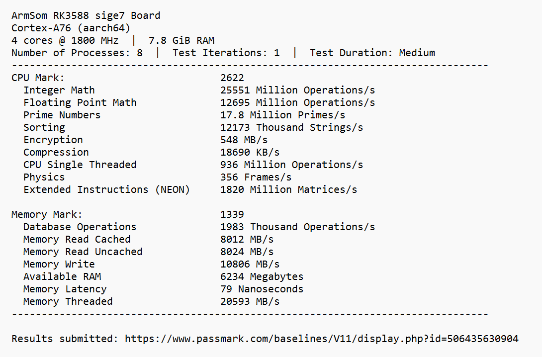

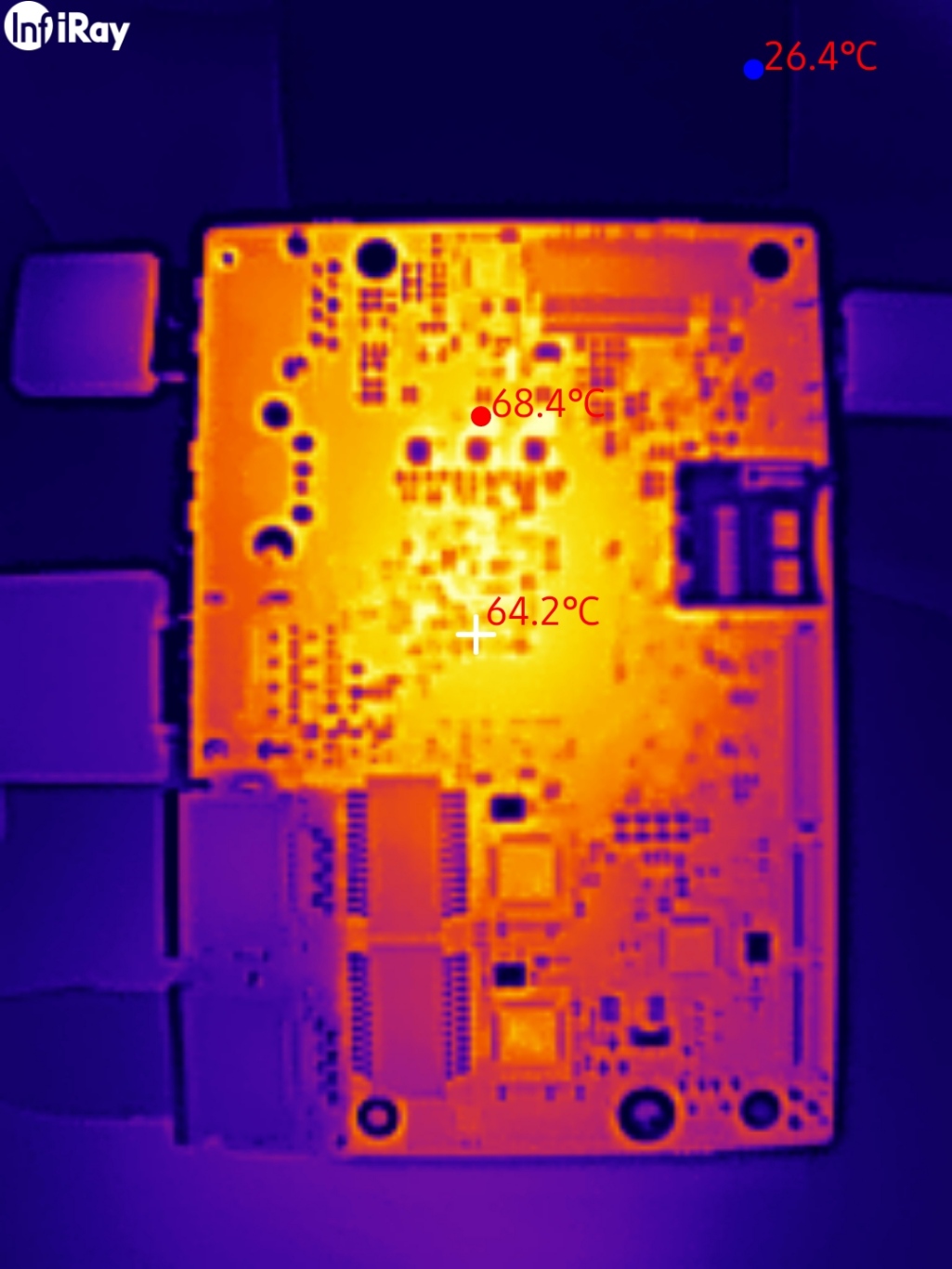

We conducted a benchmark using PassMark CPU software on Ubuntu 22.04.4 LTS. The board was identified as ArmSom RK3588 sige7 Board and the CPU as ARM Cortex-A76 4 Core 1800 MHz . As you can see on the CPU page the Average CPU Mark is 3108 and our test showed a CPU Mark of 2622 for Sige7, which is below the average performance of most implementations. This may result in numerous factors and has a high margin of error according to PassMark. During the testing phase, we also took thermal images of the board to evaluate the temperature profile of the board. You can see the thermal images below.
Results submitted: https://www.passmark.com/baselines/V11/display.php?id=506435630904
PassMark Rating
Thermal Profile

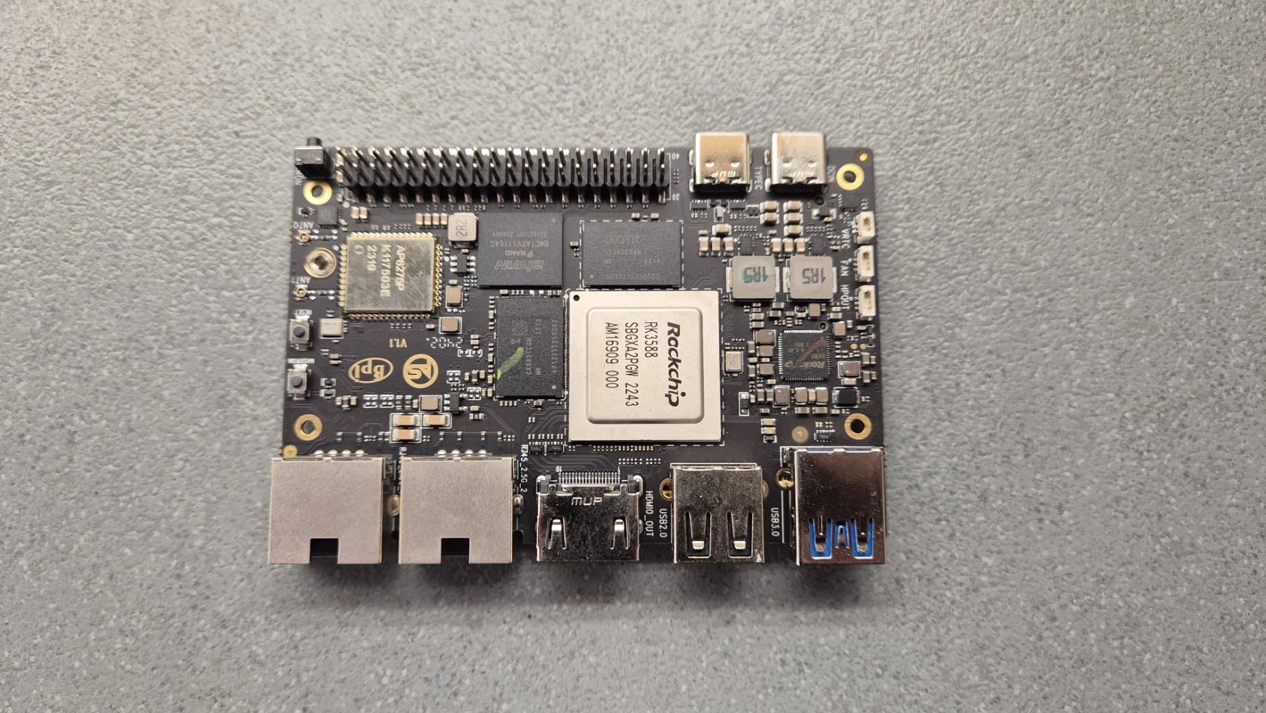

The company also offers a handy hardware description for the board, highlighting all the key components. This guide makes it easier for both developers and users to get started with the board smoothly and effectively.
