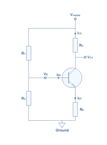

The diagram presented in Figure 1 should be by now familiar :
![](https://www.electronics-lab.com/wp-content/uploads/2019/09/AmplifierClasses.png)
In Figure 1, a BJT transistor of current gain β is biased by a voltage divider network, which consists of two parallel resistances R1 and R2 wired to the base branch. Such as we explain in the tutorial Biasing a BJT, the collector current and voltages when no AC signal is applied (IC0,VC0) sets the operating or quiescent point of the amplifier. The quiescent point is very important because its position in the output characteristic dictates the conducting angle value and therefore the class of the amplifier.
The set of values (IC0,VC0) can be adjusted with the values of the biasing resistances and emitter resistance. Indeed, the collector current IC0 is given by :
![](https://www.electronics-lab.com/wp-content/uploads/2019/08/eqIc0.png)
We can clarify two parameters in Equation 2 : 0.7 V corresponds to the voltage VBE, which is the threshold voltage of silicon-based transistors. The resistance R1//R2 is the parallel equivalent resistance of the biasing circuit and is given by the ratio (R1×R2)/(R1+R2).

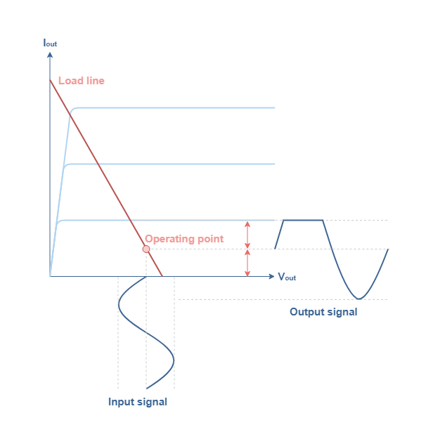

A class A amplifier is characterized by a 360° conduction angle. To achieve this feature, the quiescent point of a Class A amplifier is chosen to be in the middle of the load line such as shown in Figure 2 :
![](https://www.electronics-lab.com/wp-content/uploads/2019/09/AmplifierClasses3.png)
The quiescent point satisfies IC0=Vsupply/2RC and VC0=Vsupply/2. These formulas along with Equation 2 and Equation 3 enable to choose proper values for the biasing resistances to get a class A amplifier.
The absorbed power of a class A amplifier is a constant and equal to Pabs=Vsupply×IC0. The output power is the product of the rms output current and voltage : Pout=Vout,rms×Iout,rms. The maximal value of Pout is given when the output current reaches the upper limit IC0 and the output voltage reaches the power supply Vsupply : Pout,max=(Vsupply×IC0)/2. The maximal efficiency is therefore :

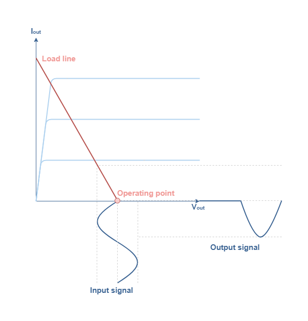

Class B amplifiers have been developed as an answer to the low efficiency of class A amplifiers. This class of amplifier is characterized by a 180° conduction angle, that is to say that they use only half of the input signal to realize the amplification process. To achieve a class B amplification, one needs to bias the circuit accordingly with Figure 3 :
![](https://www.electronics-lab.com/wp-content/uploads/2019/09/AmplifierClasses4.png)
The operating point here is located at the cutoff point and satisfies IC0=0 and VC0=Vsupply.

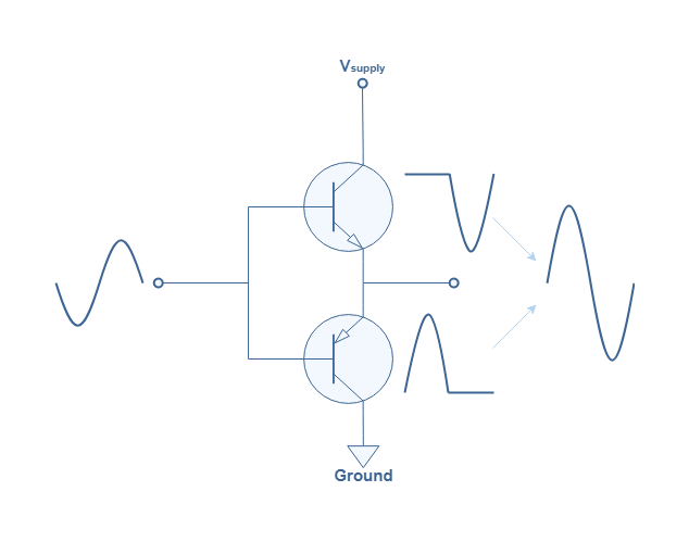

It is pretty obvious that a faithful amplification can not be achieved with a class B amplifier. To solve this problem, one of the most common solution is to use two transistors (one NPN and one PNP) in a so called “push-pull” configuration :
![](https://www.electronics-lab.com/wp-content/uploads/2019/09/AmplifierClasses5.png)
The NPN transistor takes care of amplifying the positive signal of the input and the PNP amplifies the negative signal. The combination results in an addition of the two independent amplifications that reproduce the shape of the input signal.
However, there is a phenomenon called the crossover distortion that prevents class B amplifiers, even in a push-pull configuration to give a 100 % faithful amplification. The cause is due to the threshold voltage of transistors (+0.7 V for NPN and -0.7 V for PNP) that creates an interval of 1.4 V where no amplification at all is performed from neither the NPN nor the PNP transistor. The consequence is a distortion of the signal around the 0 V point of the output signal, well known by audiophiles.

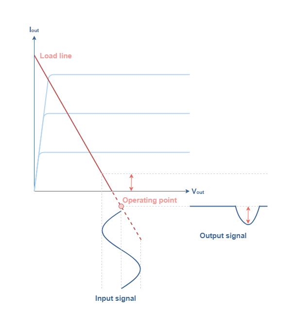

The last most common class of amplifiers is the class C. It is characterized by a small conduction angle that is in the interval ]0°;90°[. The operating point of class C is beyond the cutoff point, aligned with the load line but in the region of negative biasing currents :
![](https://www.electronics-lab.com/wp-content/uploads/2019/09/AmplifierClasses7.png)
As a matter of fact, the operating point of a class C satisfies : IC0<0 and VC0>Vsupply (which makes sense from Equation 3 if IC0<0).
The high distortion produced by class C amplifiers can be processed by a parallel resonance circuit L//C that consists of an inductance (L) and a capacitance (C). This circuit can indeed convert the output pulses into complete sine waves. For this reason, class C amplifiers are used in high frequency applications.
The biggest advantage of a class C amplifier is its efficiency that is above 78.5 % and can approach 100 % depending how far the operating point is from the cutoff point.
