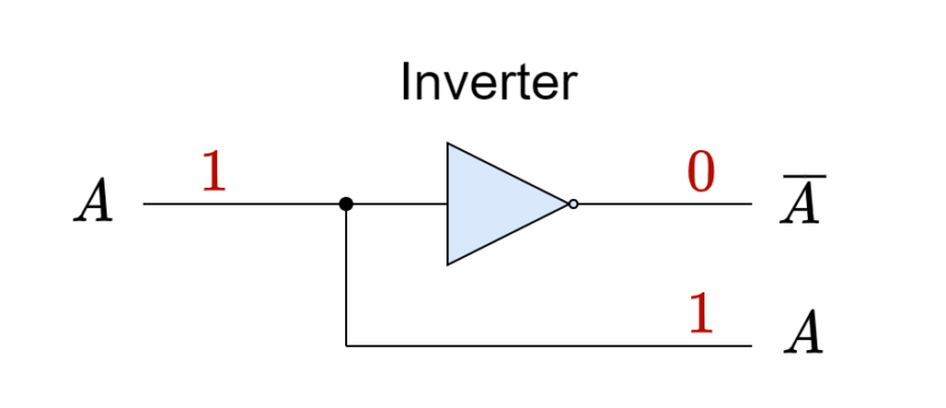

A Binary Decoder is a digital logic device that may have input binary code of 2-bit, 3-bit, or 4-bit depending on the number of input lines. In general, a decoder can be said to have n-bit code and can represent this n-bit code into an equivalent 2n possible values. The “Binary Decoder” can decode this n-bit code by setting one of 2n outputs to logic “1”. An “Inverter” can be called a 1-to-2 binary decoder as shown below in the figure. When the only input is at logic “0” then the first output is set to logic “1” and for logic “1” input, the second output turns “HIGH”. So, in any case, only one of the outputs is “HIGH” depending on the input data.

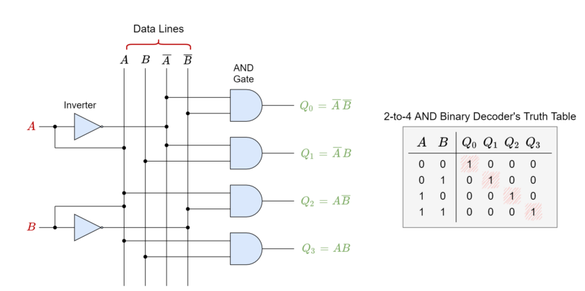

2 – to – 4 Binary Decoders
A 2 – to – 4 Binary Decoder, as the name says, has two inputs and four outputs. In the following figure, a 2 – to – 4 Binary Decoder has been shown which comprises an array of four AND gates and two inverters along with its block diagram and truth table. From the truth table, it is obvious that depending on the inputs, one of the outputs will be set to “HIGH”. For example, when both of the inputs are “LOW” then output (Q0) will be set to “HIGH”. Consequently, a “HIGH” state at one of the outputs will indicate the state of inputs or binary code present at the input and can be said to “decode” the input.

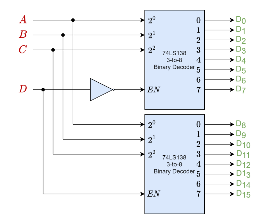

4 – to – 16 Binary Decoders
A 3 – to – 8 Binary Decoder shown above is used to implement 4 – to – 8 variants with the help of an additional input “Enable”. This configuration of the 4 – to – 16 Binary Decoder is shown in the following figure.
![](https://www.electronics-lab.com/wp-content/uploads/2023/03/4_to_16_block-2-850x718.png)
Each 3 – to – 8 Binary Decoder works the way described above except the fourth input (D) enables either of the two 3 – to – 8 Binary Decoders. Hence constituting a 4 – to – 16 Binary Decoder. Such a configuration relates to the number of inputs (AND gates) a decoder can accommodate without fan-out of gates driving them to become large. The Binary Decoders are usually constructed using AND plus NOT gates or just NAND gates. The AND gate configuration of a Binary Decoder produces a “HIGH” output when one of the inputs is “HIGH”. On the other hand, the NAND configuration yields “LOW” at the respective output when one of the inputs is “HIGH”. The NAND gate configuration is cheaper to produce as it requires fewer transistors to implement.

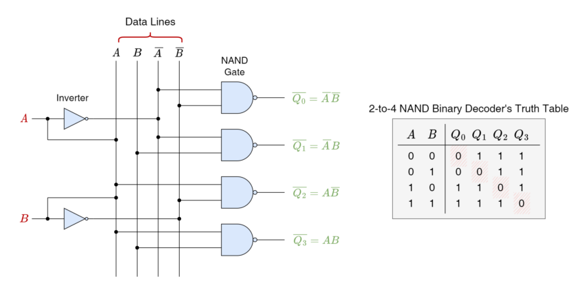

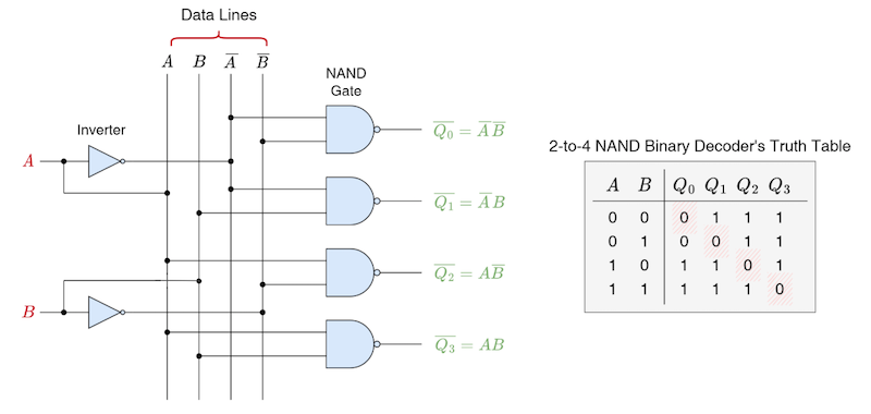

As discussed above that a Binary Decoder based on AND gates gives logic “HIGH” on one of its outputs whereas the NAND gates base Binary Decoder gives logic “LOW” on one of its outputs whilst all other outputs are set to “HIGH” logic state. In the following figure, a 2 – to – 4 Binary Decoder using NAND gates is shown.
![2-to-4 Line Binary Decoder](https://www.electronics-lab.com/wp-content/uploads/2023/03/2_to_4_nand-850x418.png)
In addition to two binary inputs, a third input “Enable” is used to “OFF” and “ON” the function of decoding by setting it to “LOW” and “HIGH” states, respectively. In NAND gate configuration, Enable = 0 sets the outputs to logic “LOW” or “0” irrespective of the states of inputs.

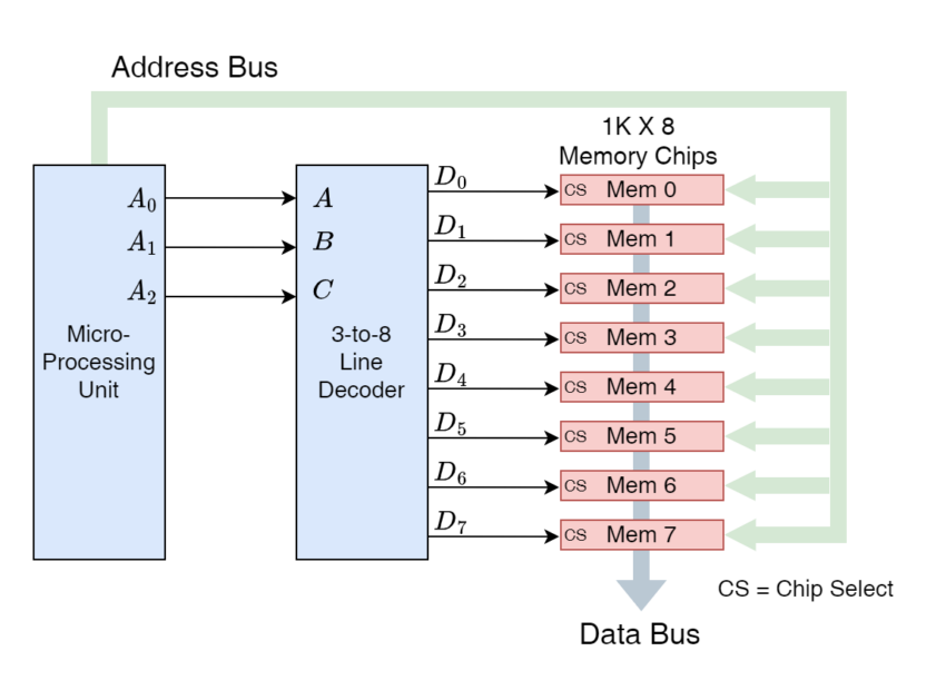

The most important application of the Binary Decoder is found in memory systems where a particular memory address is selected or decoded. This application is more profound in larger or complex memory systems where a number of memory chips are connected to a microprocessor through a single data bus. The memory chips are selected individually one at a time using the Address Decoding technique. The specific address of a memory chip is represented by coded data input and the outputs select the particular memory chip related to that address. The memory chips or storage devices have “Chip Select” or “CS” which invokes them when set to “HIGH”. The outputs of the Memory Decoder are connected to the “CS” inputs of all the memory chips.
The coded input or memory address selects or de-selects a relative memory chip through a particular output line connected to the “CS” pin of that specific memory chip. Generally, at an output line, a logic “HIGH” selects and a logic “LOW” de-selects a particular memory chip. Using this memory decoding technique, a 2 – to – 4 memory decoder can be used to select four (4) memory chips using only two (2) binary inputs.
