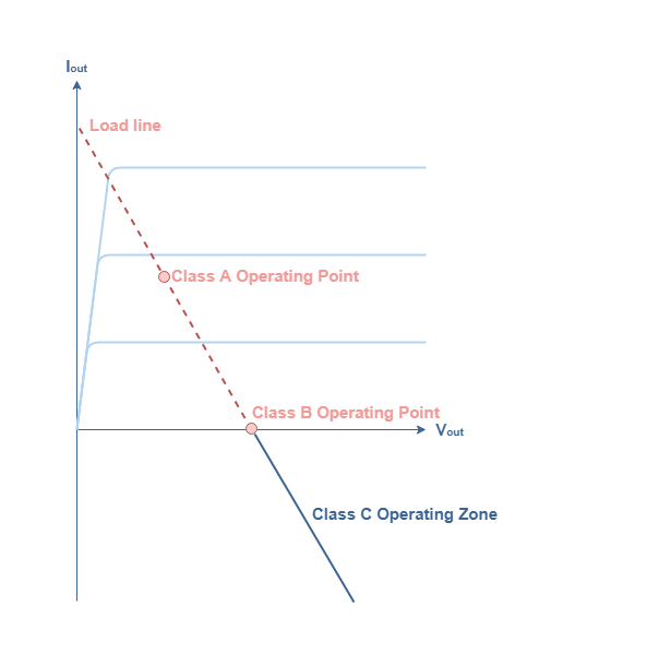

As we have seen for class AB amplifiers, class C are not defined by a single operating point but rather an operating zone. This fact is illustrated in the Figure 1 below :
![](https://www.electronics-lab.com/wp-content/uploads/2019/09/ClassC_1.png)
Since this operating zone extends beyond the class B operating point, which represents a 78.5 % efficiency and a 180° conduction angle, class C amplifiers are therefore characterized by a very high efficiency between 78.5 % and 100 % as we will detail more in the third section. Moreover, their conduction angle is very low, between 0° and 180°, which means that they conduct less than half of the signal. As we will see later on, it is precisely this fact that makes them non linear.

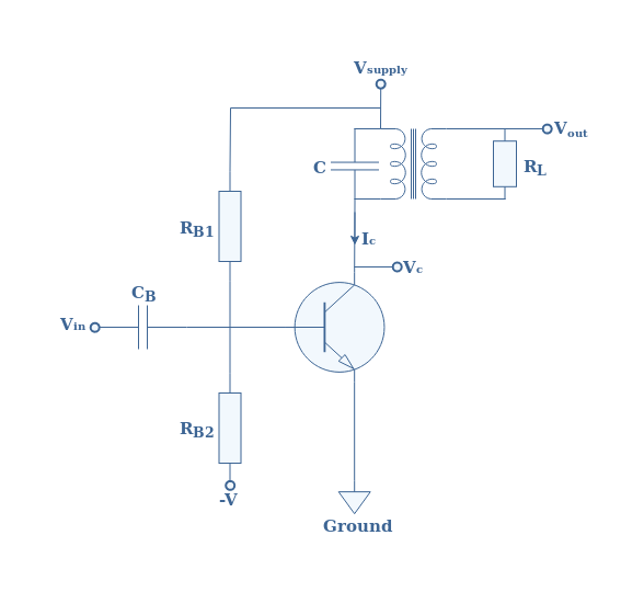

In practice, the load is coupled to the resonant circuit with a transformer as presented in Figure 3.
![](https://www.electronics-lab.com/wp-content/uploads/2019/09/ClassCp3.png)
As already presented during the class A amplifier tutorial, this transformer-coupled configuration ensures that the load is isolated from the power supply and it is also used to realize an impedance matching. Moreover, the base is biased through a voltage divider network. In the following section, we will always refer to the Figure 3 circuit.

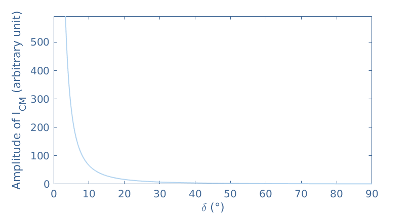

From this equation, we can understand that the conduction angle influences greatly the amplification process. The graph below represents the evolution of ICM for a conduction angle in the class C interval ]0° ; 180°[, that is to say for a δ value in the range ]0° ; 90°[.
![](https://www.electronics-lab.com/wp-content/uploads/2019/09/figmatlab-2.png)
We can clearly note a fast decrease of the maximal value of the output current when the conduction angle increases. This graph gives an overview of the efficiency of the class C configuration : the smaller the conduction angle, the higher the output current.

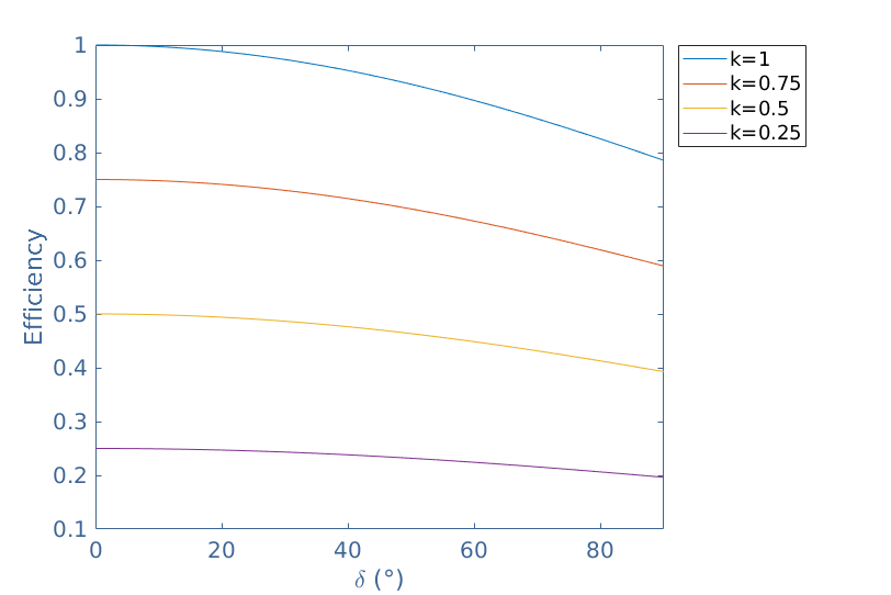

Efficiency of class C amplifiers
The method and steps to demonstrate the formula of efficiency η for class C amplifiers involves integral calculus and is not shown in this tutorial. The formula linking the efficiency to the parameters δ and k is given in the Equation 2 below :
![](https://www.electronics-lab.com/wp-content/uploads/2019/09/eqeta-2.png)
It is interesting to visualize the dependency of the efficiency on both parameters in a graph given below :
![](https://www.electronics-lab.com/wp-content/uploads/2019/09/figmatlab2.png)
Best efficiencies are achieved with an ideal transformer where k=1. Moreover, we can highlight that if k=1 and the conduction angle is 180° (δ=90°), we are in a class B configuration and we recognize the maximal efficiency of 78.5 %.
A theoretical maximal efficiency of 100 % could be reached with k=1 and a zero conduction angle. However, for such values, the useful power delivered to the load is zero and therefore such efficiency cannot be achieved.

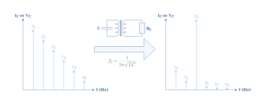

An interesting aspect of the circuit shown in Figure 3 is that the resonance circuit can be matched to the frequency of the input signal but as well to one of its harmonics. An harmonic is a multiple of the frequency f1 of the input signal of the form n×f1 with n an integer.
In order to realize this frequency match, the product L×C must satisfy the relation proposed in Equation 3 :
![](https://www.electronics-lab.com/wp-content/uploads/2019/09/eqLC-1.png)
Since the collector current, as seen in Figure 4, is a pulse signal, its frequency spectrum already includes the fundamental frequency f1 and the following harmonics f2=2×f1, f3=3×f1, … If a frequency match is established for a certain harmonic, for example f3, this particular frequency will prevail over all the others. In this case, the voltage output is a sine signal of frequency f3 and amplitude RL×IC.
The Figure 7 below summarizes this function of frequency multiplier :
![](https://www.electronics-lab.com/wp-content/uploads/2019/09/ClassCp5.png)
