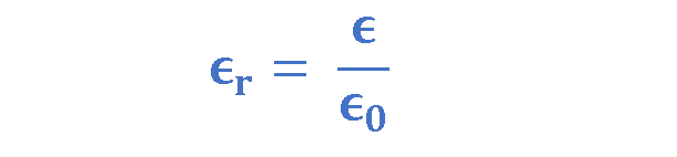

Since the permittivity of a dielectric is always greater than the permittivity of vacuum ϵ0, it is often convenient to use the relative permittivity ϵr, of the dielectric, i.e., the ratio of its absolute permittivity to that of vacuum. Equation 2 explains the definition of ϵr.
![](https://www.electronics-lab.com/wp-content/uploads/2024/07/Equation-2_Dielectrics.png)
where ϵr = relative permittivity of dielectric,
ϵ = permittivity of dielectric,
ϵ0 = permittivity of vacuum = 8.85 x 10-12 F.m-1.
Whereas ϵ and ϵ0 are expressed in Farads per meter (F/m), the relative permittivity ϵr, is a dimensionless ratio.

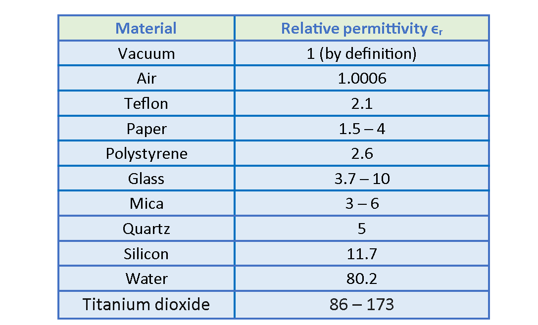

The relative permittivity of some media is shown in Table 1, where the values are for static (or low-frequency) fields and, except for vacuum or air, are approximate. The absolute permittivity of vacuum is unity by definition. Note that ϵ0, for air is so close to unity that for we can consider air equivalent to vacuum. Notice that ϵr is a constant greater than 1, for all other materials.

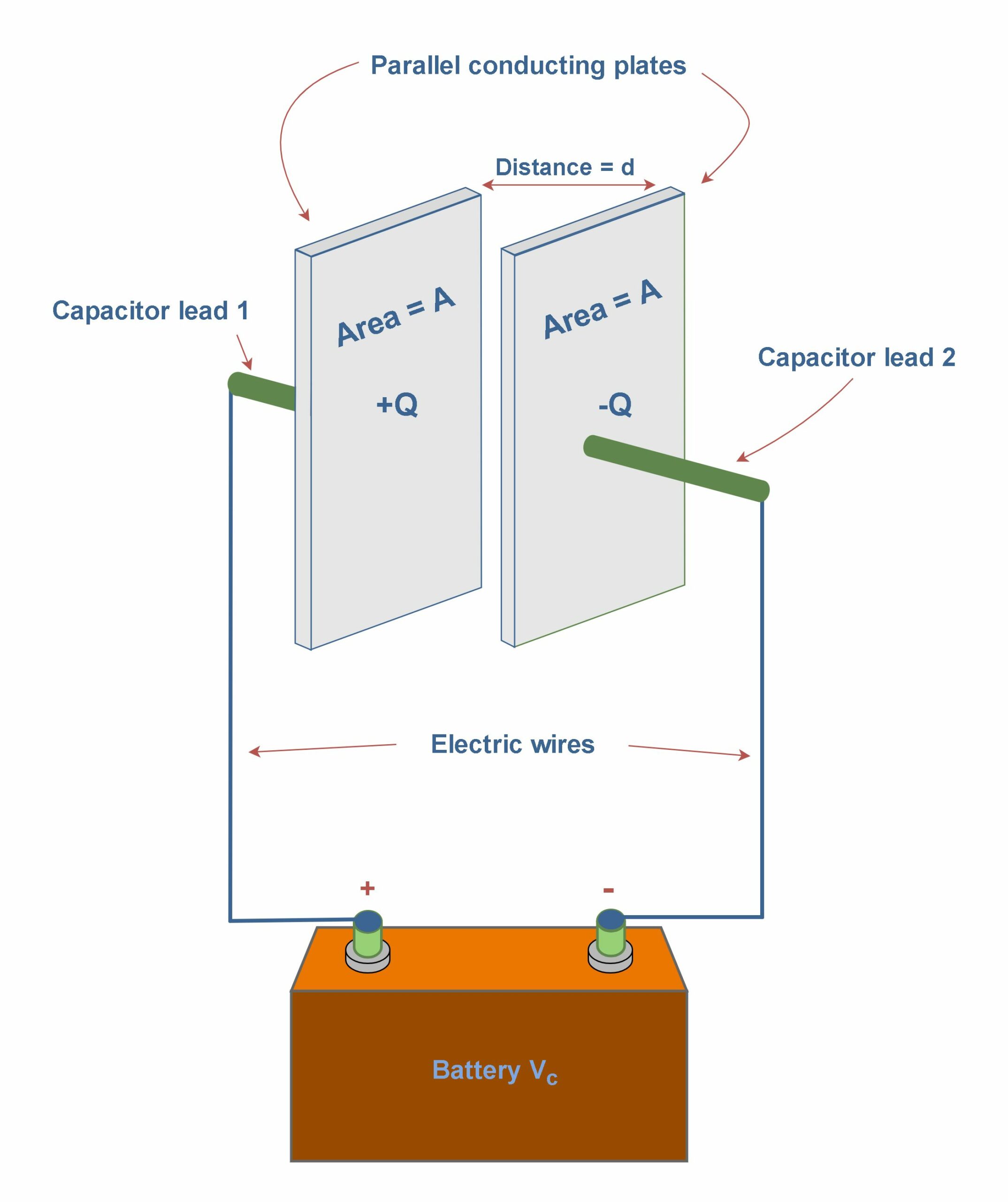

A capacitor is a device used to store electric charge. The amount of charge q a capacitor can store depends on two major factors – the voltage applied and the capacitor’s physical characteristics, such as its size and plate separation. Figure 8 shows an example of a parallel-plate capacitor that acquires charges from a battery.
![](https://www.electronics-lab.com/wp-content/uploads/2024/07/FIGURE-8_Dielectrics.drawio-scaled.jpg)
For such a parallel-plate capacitor with the air dielectric between its plates, the capacitance due to its dimensions can be written in the form of Equation 3:

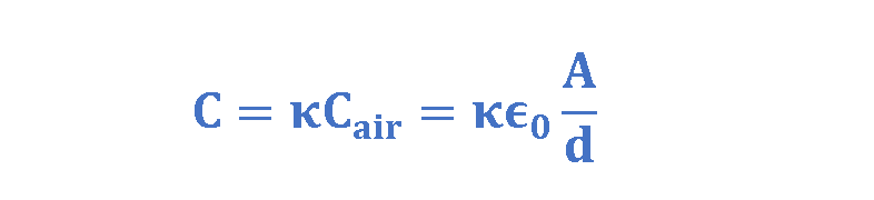

Historically, in 1837, Michael Faraday first looked into this matter, that if we fill the space between the plates of a capacitor with a dielectric, which is an insulating material such as mineral oil or plastic, what happens to the capacitance? He found that the capacitance increased by a numerical factor denoted as κ, which he called the dielectric constant of the insulating material. Today, this factor is also known as the relative permittivity εr and these names are used interchangeably.
Faraday’s discovery was that, with a dielectric completely filling the space between the plates, the capacitance of a parallel-plate capacitor is defined as in Equation 4:
![](https://www.electronics-lab.com/wp-content/uploads/2024/07/Equation-4_Dielectrics.png)
It shows that by placing a dielectric between the plates of a capacitor, the capacitance is increased by the factor κ (= ϵr). Obviously, κ and ϵr are dimensionless quantities. Even common paper can increase the capacitance of a capacitor, and some materials, such as Titanium dioxide (TiO2), can increase the capacitance more significantly.

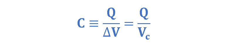

We have already defined the capacitance of this two-conductor system as the ratio of the magnitude of the total charge on either conductor to the magnitude of the potential difference between conductors, as explained in Equation 5:
![](https://www.electronics-lab.com/wp-content/uploads/2024/07/Equation-5__Dielectrics.png)
Where Q is the amount of charge (in Coulombs) on each plate and Vc is the potential difference between plates (in volts). If we rearrange the variables in Equations 4 & 5, we achieve Equation 6 which is easier to understand:

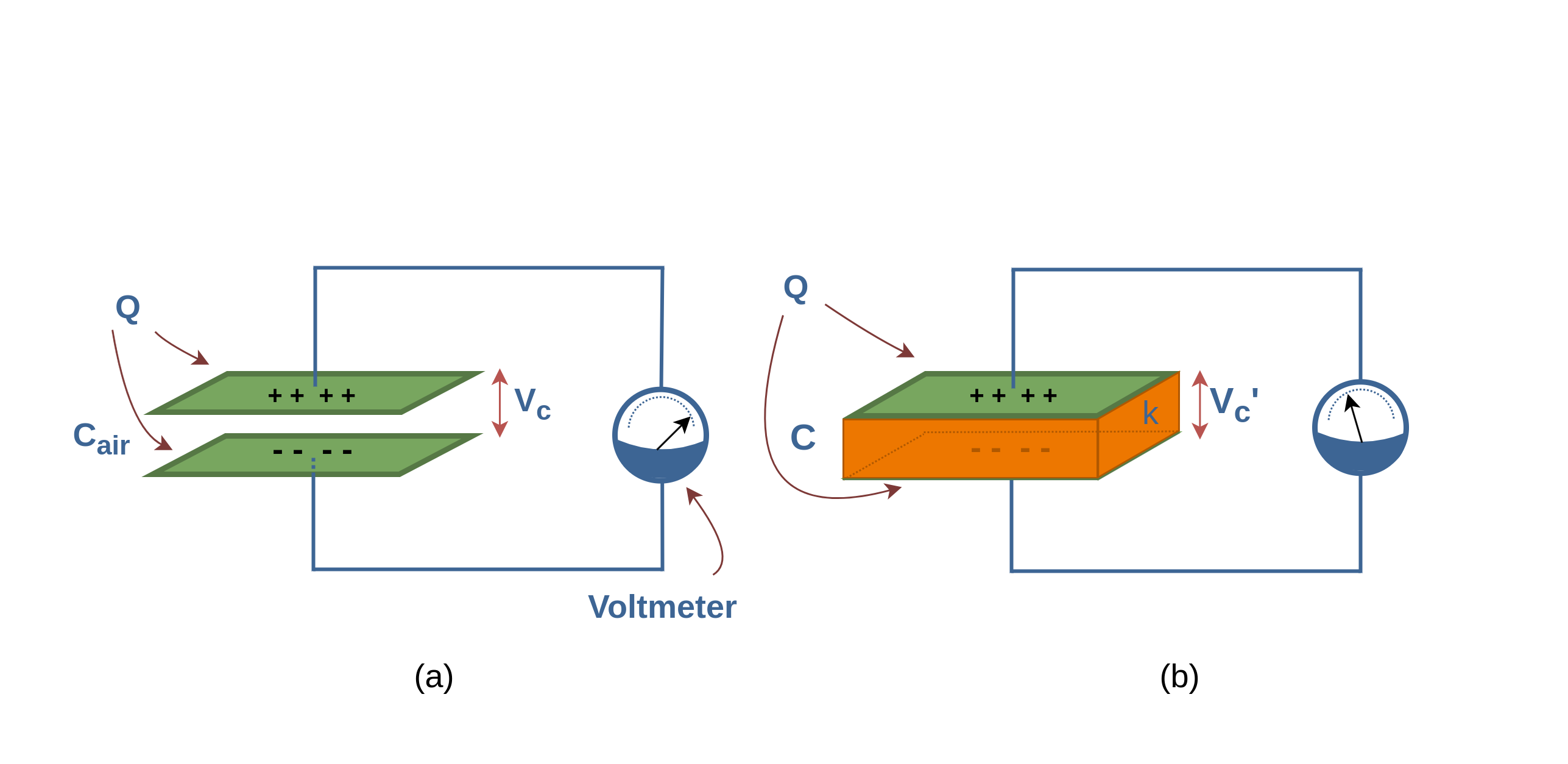

In Figure 10a the battery is replaced by a voltmeter (a device for measuring potential difference). A capacitor cannot discharge through a voltmeter. Therefore, the primary charge Q must remain constant.
![](https://www.electronics-lab.com/wp-content/uploads/2024/07/FIGURE-10_Dielectrics.drawio.png)
When a dielectric slab is inserted between the plates, as shown in Figure 10b, then the voltmeter shows that the potential difference (Vc’) between the plates reduces by a factor κ, it means that Vc’ < Vc.
Finally, both these observations, constant voltage (with battery) and constant charge (with voltmeter), are consistent with the increase in capacitance caused by the dielectric. Equation 6 confirms these results.
