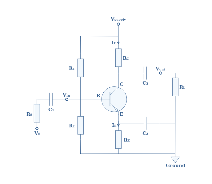

Let’s consider a Common Emitter Amplifier (CEA) which configuration is shown in Figure 2 :
![](https://www.electronics-lab.com/wp-content/uploads/2019/10/FrequencyResponsep2-1.png)
The structure around the BJT transistor consists of a voltage divider network (R1 and R2), a load (RL), coupling capacitors (C1 and C3) and a bypass capacitor C2.

At low input frequencies, the coupling capacitors will more likely block the signal, since XC1 and XC3 are higher, more voltage drop will be observed across C1 and C3. This results in a lower voltage gain.
At high input frequencies the bypass capacitor C2 shortens the emitter branch to the ground and the voltage gain of the amplifier is AV=(RC//RL)/re with re being the small diode emitter resistance. When the frequencies are lower, the resistance between the emitter and the ground is no longer only re but RE+re and therefore the voltage gain decreases to AV=(RC//RL)/(RE+re).

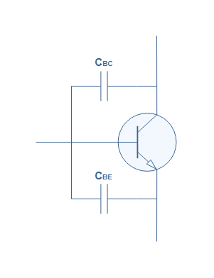

There is another type of capacitors that affect the frequency response of the amplifier and is not represented in Figure 2. They are known as internal transistor capacitors and represented in Figure 3 below :
![](https://www.electronics-lab.com/wp-content/uploads/2019/10/FrequencyResponse_3.png)
Whereas the coupling and bypass capacitors act as high-pass filter (they block low frequencies), these internal capacitors behave differently. Indeed, if the frequency is low, CBC and CBE act as an open circuit and the transistor is not affected at all. However, if the frequency increases, more signal passes through them instead of going in the base branch of the transistor, therefore decreasing the voltage gain.

Having all of this information in mind, let’s calculate and plot the low frequency response of the CEA of Figure 2 with the below given parameters :
- RS=500 Ω ; R1=80 kΩ ; R2=30 kΩ ; RC=5 kΩ ; RE=2 kΩ ; RL=6 kΩ ; re= 25 Ω
- C1=100 nF ; C2=150 μF ; C3=400 nF ; CBC=5 pF ; CBE=30 pF
- Gain of the transistor β=100 ; Vsupply=10 V
First of all we consider the input high-pass filter RinC1. As explained in previous tutorials, Rin is the total input impedance of the amplifier. In our example, it can be determined by ]
Rin=RS+(R1//R2//βRE)=20.2 kΩ.
The low cutoff frequency of the input will therefore be : fcl,in=1/(2πRinC1)=79 Hz.
The same procedure can be done for the output where the output resistance is Rout=RC//RL=2.7 kΩ. The low cutoff frequency of the output filter is : fcl,out=1/(2πRoutC3)=147 Hz.

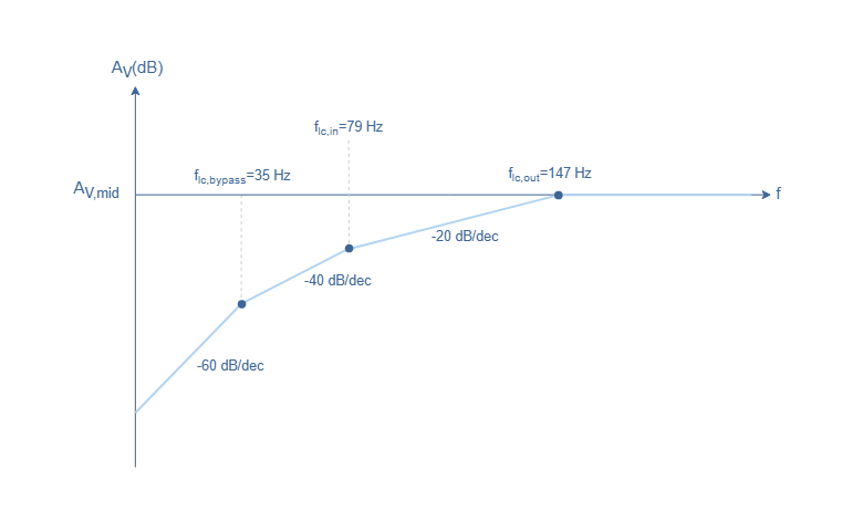

Finally, for the bypass capacitor, the resistance formula is more complex and given by Rbypass=RE//((re+(RS//βRE)/β))=30 Ω. The low cutoff frequency of the bypass structure is thus :
fcl,bypass=1/(2πRbypassC2)=35 Hz.

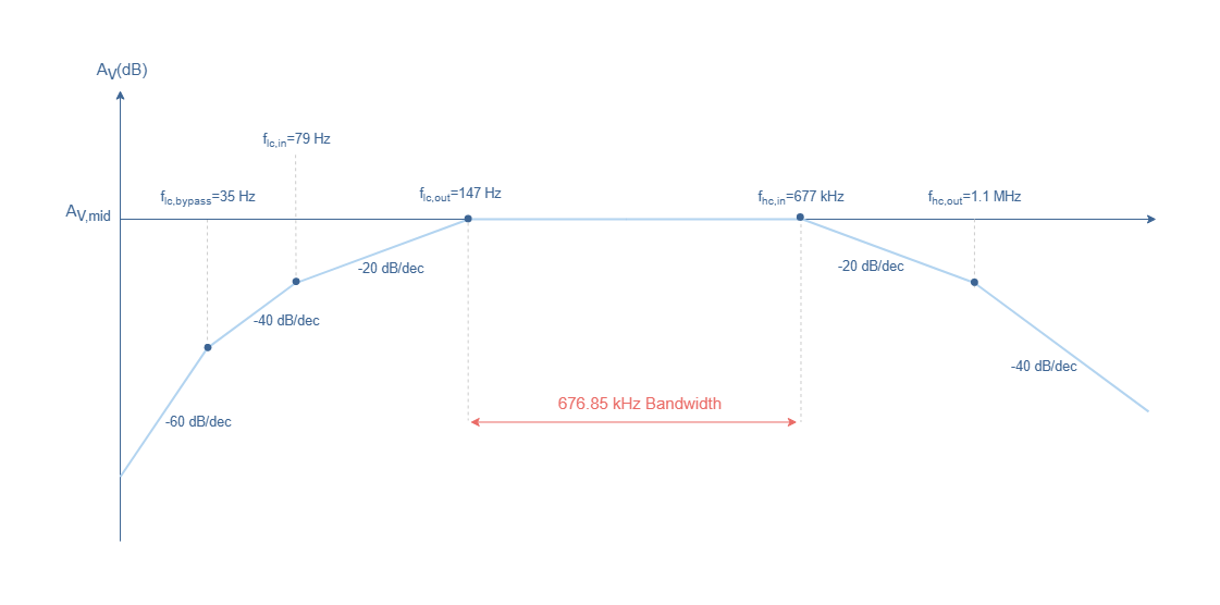

One last thing we need to understand before plotting the Bode graph is about the slope out of the midrange values. The decrease of AV,mid with the frequency is called roll-off and its value for each simple RC filter is -20 dB/decade (dB/dec). This value means for high-pass filters (resp. low-pass filters) that each time the frequency is divided by 10 (resp. multiplied by 10), a decrease of -20 dB is observed for the gain of the amplifier.
When multiple filters are blocking the same range of frequencies, the roll-off is enhanced. In our example three filters are simultaneously blocking the frequencies below 35 Hz, the roll-off is therefore 3*(-20 dB/dec)=-60 dB/dec.
This information can be synthesized in a Bode plot showing the low frequency response of the CEA in asymptotic representation :

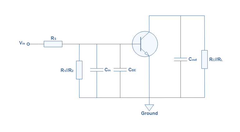

As stated previously, it is the internal transistor capacitors that will limit the gain at high frequencies acting as low-pass filters. It can be shown that the equivalent circuit of Figure 2 at high frequency can be drawn such as presented in Figure 5 :
![](https://www.electronics-lab.com/wp-content/uploads/2019/10/FrequencyResponse_5.png)
We can note that the coupling capacitors are not represented since they behave as short circuits at high frequencies. Moreover, the emitter branch is shorten to the ground for the same reason applying to the bypass capacitor.
The internal capacitor CBC is converted via Miller’s theorem into the equivalent Cin and Cout capacitors. Moreover, this theorem states that Cin=CBC(AV,mid+1) and Cout=CBC(AV,mid+1)/AV,mid.

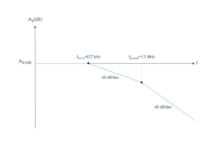

The total input capacitance of this circuit is CIN=CBE+Cin ; the total input resistance is RIN=RS//R1//R2//βre. The numerical application to our example gives AV,mid=(RC//RL)/re=108, CIN=575 pF and RIN=409 Ω. The high cutoff frequency of the input is therefore fhc,in=1/(2πRINCIN)=677 kHz.
From the output point of view, the high cutoff frequency is simply given by the filter (RC//RL)Cout with Cout=5.3 pF : fhc,out=1/(2π(RC//RL)Cout)=1.1 MHz.
The information given here is summarized in a Bode plot representing the high frequency response of the CEA in asymptotic representation :
![](https://www.electronics-lab.com/wp-content/uploads/2019/10/FrequencyResponse_6.png)
