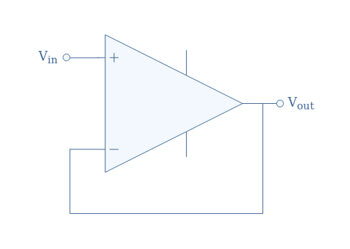

Voltage follower
The voltage follower is a buffer that does not amplify nor inverts the signal. Consequently, its gain is equal to +1. The design of the voltage follower is very simple and simply consist of a short-circuit feedback to the inverting input (-) of the op-amp:
![](https://www.electronics-lab.com/wp-content/uploads/2020/08/opampbuildingblocks-Page-1.png)

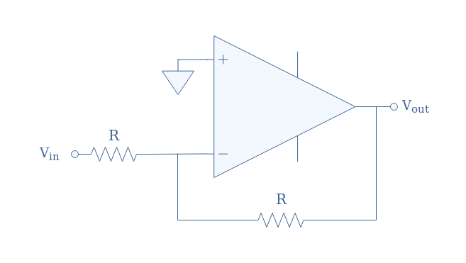

Inverting buffer
If we consider the circuit in Figure 1, add resistors in the feedback loop and inverting input, and connect the non-inverting input to the ground, we obtain a circuit known as inverting buffer:
![](https://www.electronics-lab.com/wp-content/uploads/2020/08/opampbuildingblocks-Page-4-1.png)
Assuming that the value of the resistors is strictly identical under the working condition of the op-amp, the gain of this circuit is -1. The signal is therefore not amplified but inverted: Vout=-Vin.

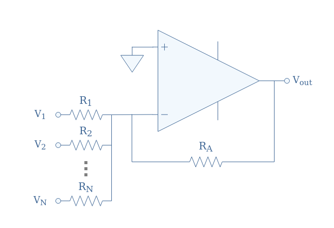

Adder/subtractor
The adder configuration takes several voltages on its inverting input connected via resistors.
![](https://www.electronics-lab.com/wp-content/uploads/2020/08/opampbuildingblocks-Page-9.png)
In the general case, the voltage Vout satisfies Equation 2:
![](https://www.electronics-lab.com/wp-content/uploads/2020/08/eqaddergeneral.png)
It is interesting to equalize all the resistances RA=R1=…=RN, which leads to a simplified formula where we can clearly see that the configuration presented in Figure 8 effectively adds the voltages:
![](https://www.electronics-lab.com/wp-content/uploads/2020/08/eqaddersimplified.png)
Note that the presence of the minus sign means that the voltage sum is inverted. In order to add the voltages without an inversion, we can simply place an inverting buffer after this stage.

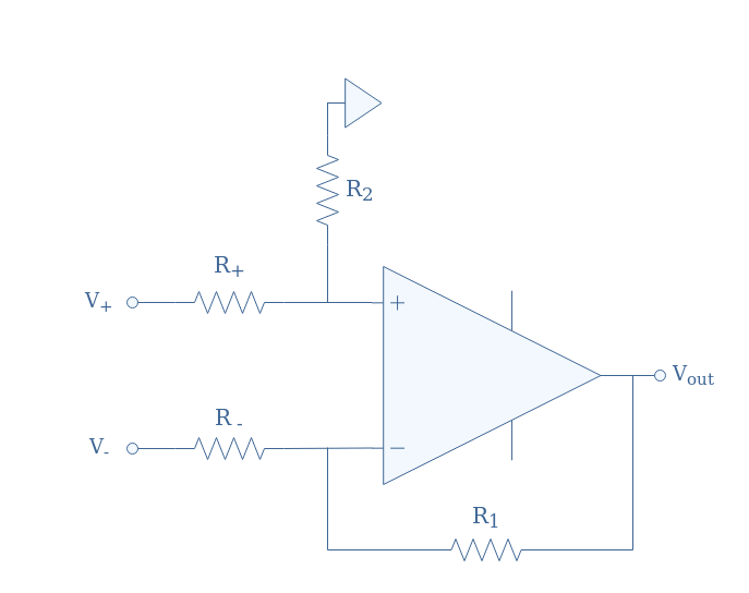

To realize a subtractor configuration, both the inverting and non-inverting output are used such as shown in Figure 9:
![](https://www.electronics-lab.com/wp-content/uploads/2020/08/opampbuildingblocks-Page-8.png)
The configurations become again interesting when the resistor values are appropriately chosen so that R–=R1 and R+=R2. In that case, the subtractor function can be performed:
![](https://www.electronics-lab.com/wp-content/uploads/2020/08/eqsub.png)

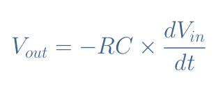

Derivator/Integrator
We start with the derivator which input is connected via a capacitor to the inverting branch, the feedback loop is connected with a resistor:
![](https://www.electronics-lab.com/wp-content/uploads/2020/08/opampbuildingblocks-Page-10.png)
The output is proportional to the variations of the input signal given by the derivative function:
![](https://www.electronics-lab.com/wp-content/uploads/2020/08/eqderiv.png)
Derivators are useful to control the variations of certain physical parameters previously transformed in an electrical signal such as the temperature, pressure…

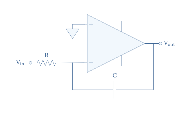

By inverting the position of the capacitor and resistor in Figure 10, we obtain the circuit of an integrator:
![](https://www.electronics-lab.com/wp-content/uploads/2020/08/opampbuildingblocks-Page-11.png)

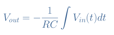

For this circuit, the output is proportional to the integral of the input:
![](https://www.electronics-lab.com/wp-content/uploads/2020/08/eqint.png)
