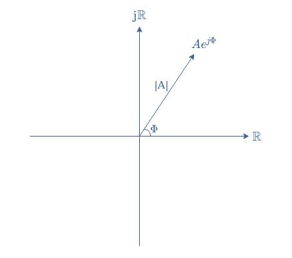

The idea of a phasor comes from the complex representation of AC signals. From Equation 2, we can indeed split the exponential term in two parts : Ae(jωt+Φ)=AejωtejΦ. We call phasor the quantity AejΦ, which is a complex number and can, therefore, be represented in the complex plane as a vector where Φ is the angle between the real numbers axis and phasor and A is the module of the vector :
![](https://www.electronics-lab.com/wp-content/uploads/2020/01/Phasorsp1-1.png)
Sometimes, AejωtejΦ can refer to the phasor, in this case, the vector rotates anticlockwise at an angular velocity of ω.
There is no real point in representing a single signal as a phasor, however, phasor diagrams become appreciated to solve some problems with two or more AC signals in an easier way than with algebra as we will present in the next section.

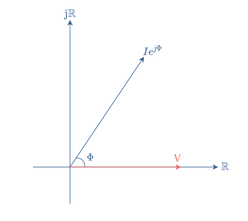

A phasor diagram consists of the same figure as presented above but with two or more vectors. Consider for example an AC signal which voltage and current are phase-shifted of Φ: V(t)=Vsin(ωt); I(t)=Isin(ωt+Φ). In this case, we represent V(t) as a reference phasor aligned with the real number axis and I(t) with an angle Φ oriented in the anticlockwise direction :
![](https://www.electronics-lab.com/wp-content/uploads/2020/01/Phasors-Page-2-1.png)
In this particular case, the current is leading the voltage or we can also say that the voltage is lagging the current. More information about this fact can be found in the tutorial of Phase Splitter.

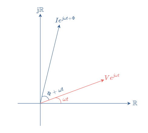

We note that since phasors represent the state of a signal at a particular period of time, an infinity of a diagram is available if we take t≠0. For this reason, the following diagram presented in Figure 3 is strictly similar to the one in Figure 2.
![](https://www.electronics-lab.com/wp-content/uploads/2020/01/Phasors-Page-3-1.png)
However, we mostly prefer to draw the diagram such as presented in Figure 2 since it establishes a reference and because the angle ωt is not relevant.

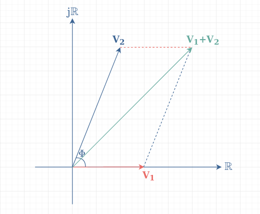

Consider two voltages signals of same frequency phase-shifted of Φ radians: V1(t)=v1sin(ωt) and V2(t)=v2sin(ωt+Φ). Figure 4 shows the procedure to add these two phasors :
![](https://www.electronics-lab.com/wp-content/uploads/2020/01/Phasorsp4.png)
Since the addition is a commutative operation, two ways of proceeding will lead to the same result: from V1 we add V2 (dashed blue line) or from V2 we add V1 (dashed red line).
If we consider the grid of Figure 4 to represent 1 V for each division, we can then determine the new amplitude and phase of V1+V2. We can see that V1+V2 can be written as a complex number of 5+5j. The amplitude of the output is, therefore √(52+52) = √50 ≈ 7 V and the phase is 45° or π/4 radians. Finally, we can say that V1+V2=7×sin(ωt+π/4).

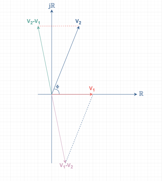

The procedure to subtract these two signals is the same, however, the subtraction is not commutative. This means that the result of V1-V2 or V2-V1 is different, as we are used to for real numbers :
![](https://www.electronics-lab.com/wp-content/uploads/2020/01/Phasorsp5.png)
The amplitude of V1-V2 or V2-V1 is identical and in our example would be equal to √(52+12) = √26 ≈ 5.1 V. The phase of V1-V2 is equal to atan(-5/1) ≈ -79° and the phase of V2-V1 is -79+180°=101°.

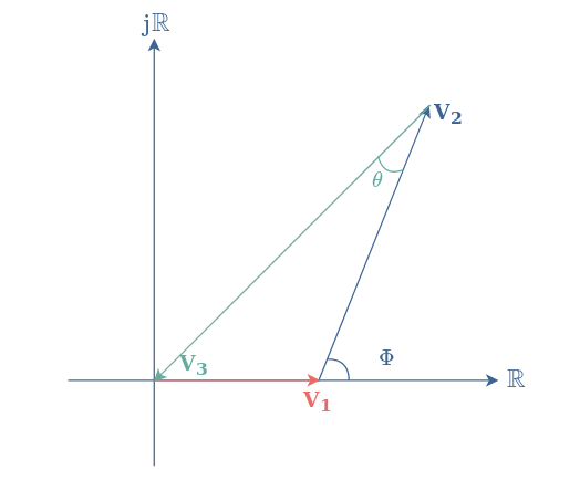

The phasor diagram is particularly helpful for some specific problems. Indeed, consider two signals of the same frequency V1 and V2 that are phase-shifted of an angle Φ, such as in Figure 4.
The problem is: which phase and amplitude are needed for a third signal V3 that results in destructive interference such as V1+V2+V3=0 ?
The phase diagram quickly and intuitively solves this problem :
![](https://www.electronics-lab.com/wp-content/uploads/2020/01/figdestructive.png)

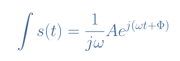

The integration of s(t) is given by the expression in Equation 5 :
![](https://www.electronics-lab.com/wp-content/uploads/2020/01/eqintegration.png)

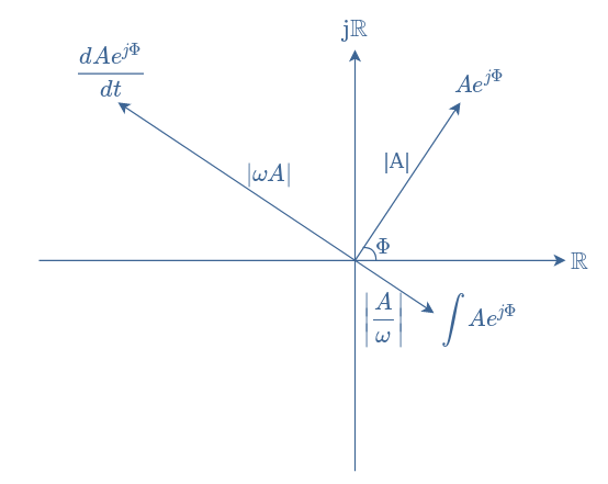

The imaginary unit j can be rewritten ejπ/2, therefore the differentiation operation is similar to multiplying the phasor by ω and proceed to a rotation of +π/2 rad or +90°. The integration is similar to multiplying the phasor by 1/ω and proceed to a rotation of -π/2 rad or -90° such as illustrated in Figure 7 :

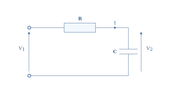

Consider an RC series circuit in which input voltage is the sine reference V1=v1ejωt and the output voltage is the unknown V2.
![](https://www.electronics-lab.com/wp-content/uploads/2020/01/Phasors-Page-7.png)

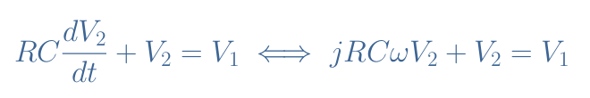

The voltages are linked by the following differential equation, which can be written in the classical form (left of the equivalence symbol) or with the phasor notation (right) thanks to the formula of derivation :

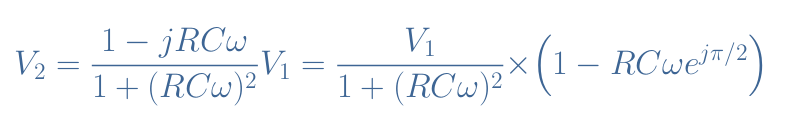

From this equation, we can express the unknown V2 as a function of the reference voltage :
Which can be rewritten by multiplying the numerator and denominator with the complex conjugate :
![](https://www.electronics-lab.com/wp-content/uploads/2020/01/eqfinal.png)

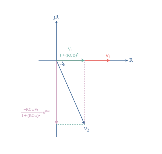

From this expression, we can represent the phasors of the RC circuit in a phase diagram in Figure 9 and proceed to the addition of two phasors in order to draw V2 :
![](https://www.electronics-lab.com/wp-content/uploads/2020/01/Phasorsp8.png)
Both the amplitude and phase of V2 can be measured from this phase diagram with the same procedure that has previously been explained.
