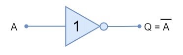

The Logic NOT Gate
The logic “NOT” gate, produces the inverse (NOT) of the input signal. It complements the input and produces it at the output. It does not perform any logical decision like AND & OR gates. It is denoted by a triangle having an “Inversion Bubble” at the output side. The “Inversion Bubble” represents an inversion, complement, or opposite of the incoming signal. It has a single input and single output. The cascading of another “NOT” gate will revert the signal to the original input. This double inversion constitutes a Digital Buffer that is used to amplify the input signal and/ or to isolate input and output circuits.

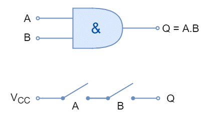

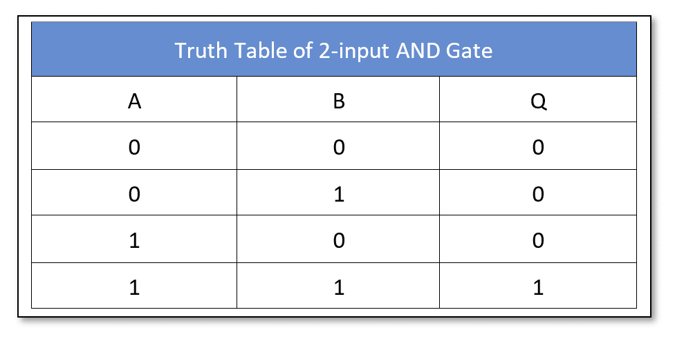

The Logic AND Gate
The logic “AND” gate performs multiplication on the digital inputs. The output of the logical “AND” gate represents the product (multiplication) of its digital inputs just like a mathematical multiplication. It is represented by a dot (.) between operands (inputs). It has two inputs and one output. The inputs of the “AND” gate can be extended by cascading the “AND” gates.

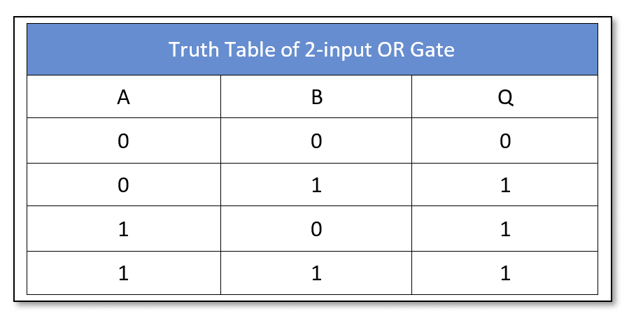

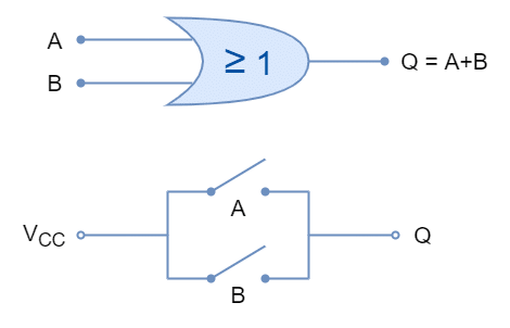

The Logical OR Gate
The Logical “OR” gate performs the addition of digital inputs. The output of the logical “OR” gate represents the summation (addition) of its inputs just lie a mathematical addition. It is represented by a plus (+) sign between the operands (inputs). It has two inputs and one output. The inputs of the “OR” gate can be extended by cascading the “OR” gates.

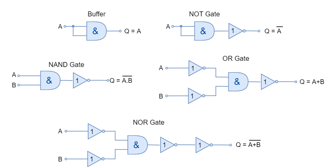

Using AND & NOT Complete Set
In the following figure, the basic logic gates are constructed using only AND & NOT gates. The gates constructed are equivalent of AND/ NOT set equivalent.

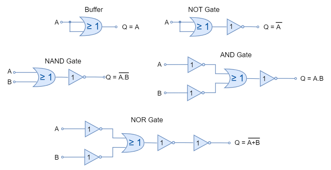

Using OR & NOT Complete Set
In the following figure, the basic logic gates are constructed using only OR & NOT gates. The gates constructed are equivalent of OR/ NOT set equivalent.

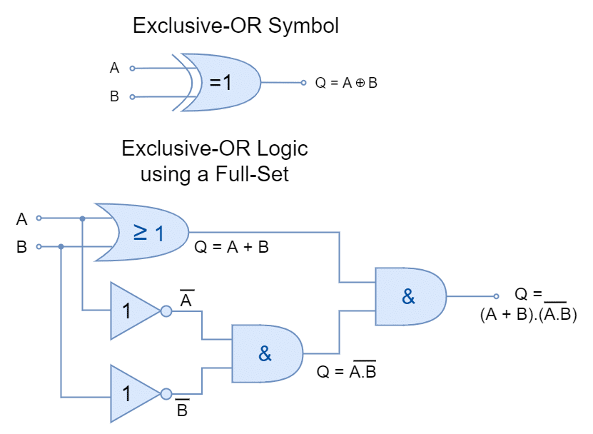

It is eminent from previous lectures that using AND, OR, and NOT (Full Set), any logic function and Boolean expression can be constructed. In the following figure, an exclusive-OR (XOR) logic gate is constructed using gates from Full Set.

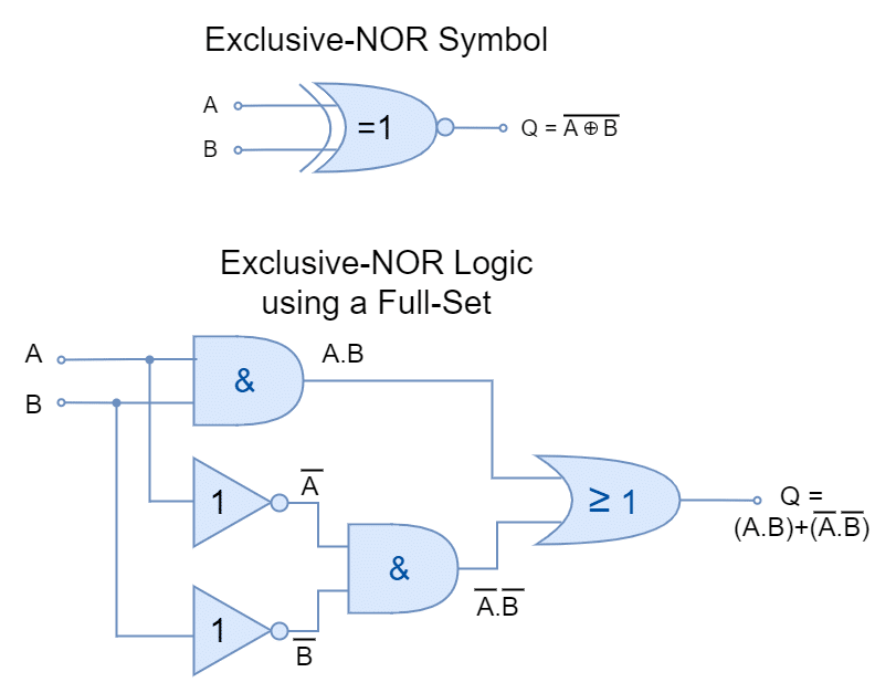

Likewise, using a Full Set, an exclusive-NOR (XNOR) logic gate is constructed in the following figure.

It is pertinent to mention here that the aforementioned Exclusive-OR and Exclusive-NOR gates are not classified as Universal Gates because they cannot produce other logic or Boolean functions.

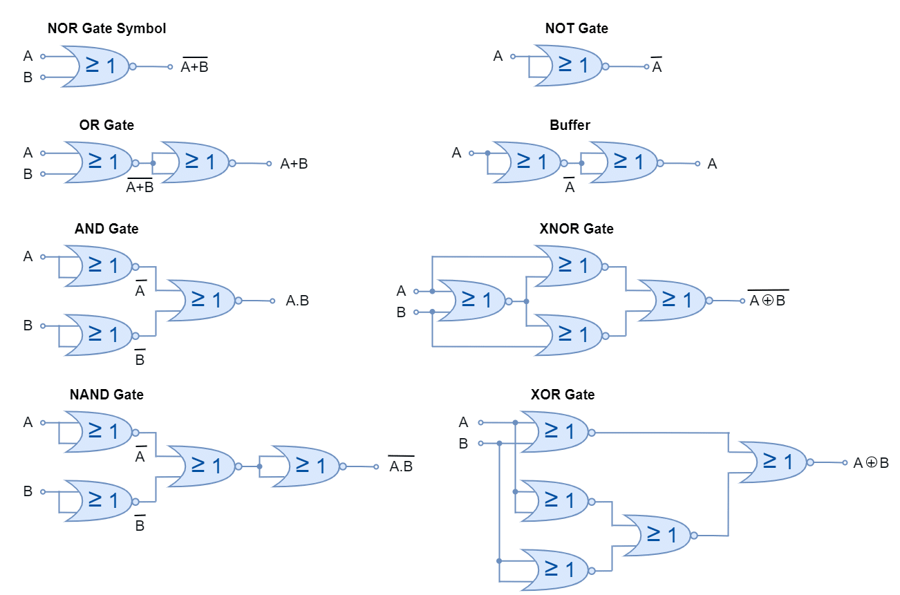

Using NOR Gates
In the following figure, other logic functions are constructed using only NOR gates. The commercially available 7402 TTL (74LS02 or 74HC02) quad 2-input NOR IC package contains four individual NOR gates. The four NOR gates of the 74LS02 IC package are used to produce all other logic functions.
![](https://www.electronics-lab.com/wp-content/uploads/2021/10/NOR-all-gates.png)
It is clear from the above figures that the construction of Exclusive-OR gate requires four (04) NAND or five (05) NOR gates. The Exclusive-OR (XOR) gate produced from NAND gates is more efficient compared to the one constructed from NOR gates.
