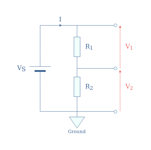

Presentation
![](https://www.electronics-lab.com/wp-content/uploads/2020/06/voltagedividersp1-1.png)
In Figure 1, we present the most common and simple configuration for a resistive voltage divider:
In the following, we will label this configuration “R1-R2“.

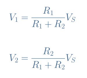

We can first of all note that according to Kirchoff’s Voltage Law, V1+V2=VS. This relation can be rewritten thanks to Ohm’s law into VS=(R1+R2)×I.
Since V1=R1×I, V2=R2×I, and I=VS/(R1+R2), we obtain in Equation 1 the following voltage divider formulas:
![](https://www.electronics-lab.com/wp-content/uploads/2020/06/eqVDR.png)
It is interesting to note that both dimensionless factors for V1 and V2 in Equation 1 can range from 0 to 1. As a consequence, both signals V1 and V2 can range from 0V up to the source value VS.

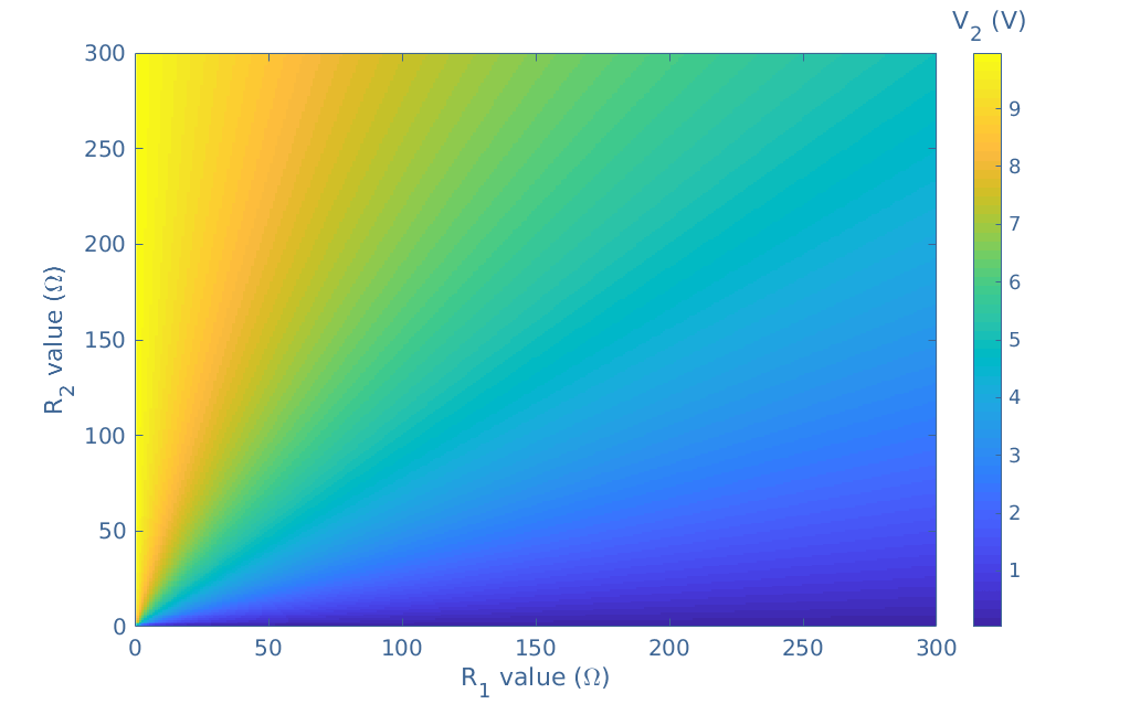

With a data program, it is possible to plot every possible value that V1 or V2 can take depending on R1 and R2 such as shown in Figure 2. For this example, we chose to plot V2 with VS=10 V and R1,R2=[0;300] Ω.

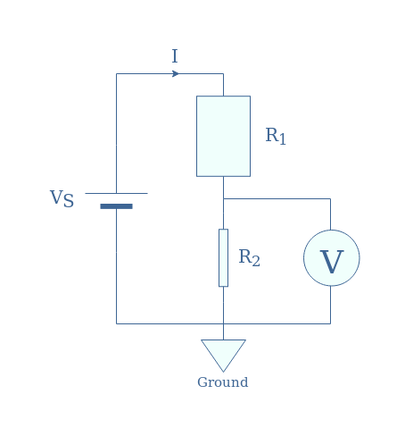

Another application in which resistive voltage dividers are suitable is the measure of high DC voltages. We illustrate this approach in Figure 3:
![](https://www.electronics-lab.com/wp-content/uploads/2020/06/voltagedividers-Page-4.png)
Note that the shape of the resistors is voluntarily modified to reflect the ratio R1/R2.
In order to protect the voltmeter (and its user) from measuring directly the high voltage VS, only a small fraction is measured by the voltmeter corresponding to R2/(R1+R2)×VS. The display is then corrected by multiplying the measurement by the same value that the high voltage was divided with.
For example, if R1/R2=99, the voltmeter measures only 1% of VS. The voltmeter will then display on the screen the exact value of VS by multiplying the measurement by 100.

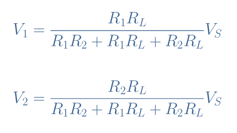

We will demonstrate the expression of V2. First of all, we express the equivalent resistance Req of the R2//RL parallel association:
We then apply the formula of the voltage divider (Equation 1) to the voltage divider R1-Req:
If we develop and rearrange this expression, we obtain V2 as a function of R1, R2, RL, and VS. Moreover, if the output load is instead connected to the terminals of R1, we can also write the expression of V1 similarly to obtain both formulas for the load voltage divider:
![](https://www.electronics-lab.com/wp-content/uploads/2020/06/eqload.png)

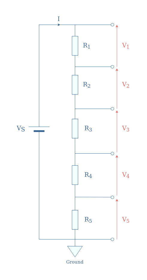

Voltage divider network
A voltage divider network is the association of three or more resistors in series that act as a voltage divider. In the following Figure 5, we illustrate a voltage divider network with five resistors:
![](https://www.electronics-lab.com/wp-content/uploads/2020/06/voltagedividers-Page-3.png)
If we note Rseries=R1+R2+R3+R4+R5 the equivalent resistance for the series association of resistors, each voltage is given by Equation 3:
![](https://www.electronics-lab.com/wp-content/uploads/2020/06/eqnetwork.png)
For a voltage divider network with N resistors, Equation 3 remains valid with Rseries=R1+R2+…+RN.

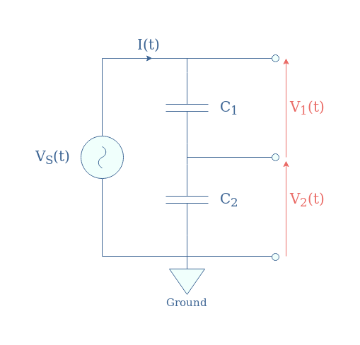

Capacitive voltage dividers are based on the same architecture as presented previously in Figure 1 by replacing the resistors with capacitors. Since the reactance of capacitors is given by 1/Cω, capacitive voltage dividers only work in the AC regime.
The advantage of using capacitors is that they present much lower power losses at high frequencies than a resistor. Indeed, we have seen in the dedicated tutorial about AC Resistance that the AC impedance tends to become much higher than the DC impedance for high frequencies due to the skin effect.
Moreover, capacitive voltage dividers are usually used for voltages above 100 kV in RMS value. The reason why is that resistive voltage dividers dissipate too much heat for high voltages, while ideal or near-ideal capacitors store the energy in the form of an electric field and release it in the circuit.
![](https://www.electronics-lab.com/wp-content/uploads/2020/06/voltagedividers-Page-5.png)

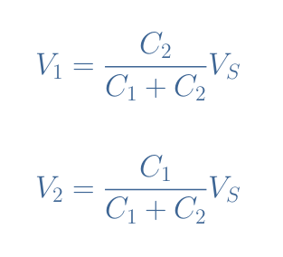

If we label V1, V2, and VS the RMS values of the voltages, it is easy to demonstrate again that they follow similar relations as presented in Equation 1. However, since the impedance here is proportional to 1/C, the subscripts of the numerator change:
![](https://www.electronics-lab.com/wp-content/uploads/2020/06/eqVDC-1.png)

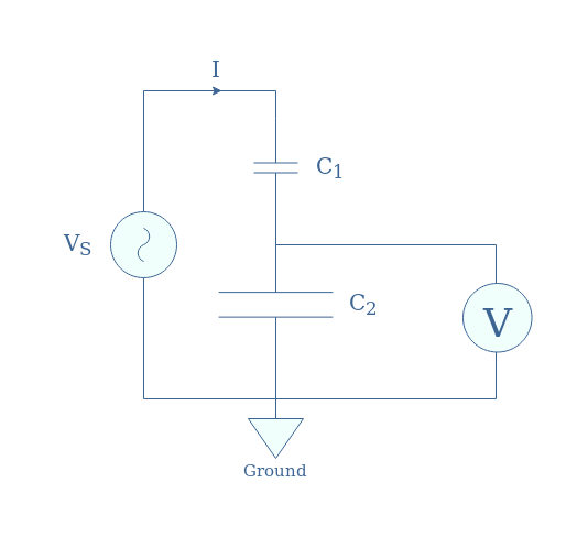

A similar circuit of Figure 3 by replacing the resistors with capacitors is suitable to measure high AC voltages. Since the voltage drop in a capacitor is proportional to 1/C, a large voltage drop will occur in the small capacitor C1:
![](https://www.electronics-lab.com/wp-content/uploads/2020/06/voltagedividers-Page-6.png)

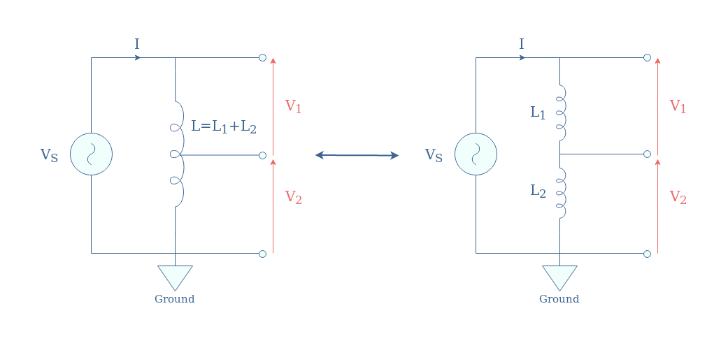

We do not encounter in the literature the term “inductive voltage divider” but we rather refer to this circuit as an autotransformer. An autotransformer is a single inductor with multiple tapping points, which can be seen as multiples inductors connected in series.
In Figure 8, we present an autotransformer with one intermediary tapping point, which corresponds to the simpler design and is equivalent to two inductances in series:
![](https://www.electronics-lab.com/wp-content/uploads/2020/06/voltagedividers-Page-7.png)
If we note N1 and N2 the number of windings in L1 and L2, the ratio of voltages is simply given by V2/V1=N2/N1.
Similarly to capacitive voltage dividers, an autotransformer is suitable for high-power applications since the inductors store the energy in the form of a magnetic field and release it to the circuit, producing no heat dissipation.
When drawn as an equivalent “inductive voltage divider”, the voltage formulas of the autotransformer are given by Equation 5:

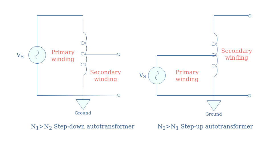

Usually, autotransformers are most found in high-power transmission lines to step-down or up voltages. Step-down and step-up autotransformers are easy to recognize by the proportion of their primary and secondary winding:
![](https://www.electronics-lab.com/wp-content/uploads/2020/06/voltagedividers-Page-8.png)
