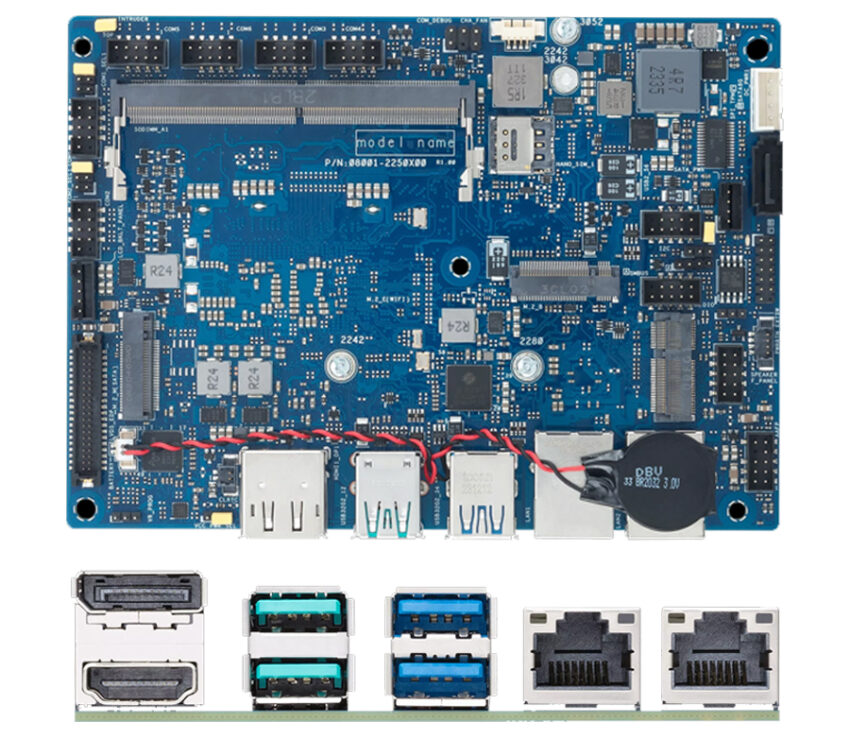

ASUS has recently launched a 3.5-inch SBC (Single Board Computer) with an Intel Atom X7433RE processor, which is a compact, low-power computing solution designed for industrial and embedded applications. Powered by the Intel Amston Lake SoC, it offers efficient performance with a TDP of just 9W and supports DDR5 SO-DIMM memory up to 16GB. It provides a flexible display configuration with HDMI, DisplayPort, and eDP/LVDS interface support, allowing for up to 3 simultaneous displays at 4K resolution. The SBC has integrated Intel UHD Graphics, multiple connectivity options including dual LAN (1G and 2.5G), 6 COM ports (RS-232/422/485), and several USB ports, making it suitable for IoT, industrial automation, and edge computing tasks.
It also includes M.2 slots for Wi-Fi, 4G/5G, storage expansions, a wide voltage range (9-36V), and an operating temperature range of -20°C to 70°C. Additionally, it has Intel Deep Learning Boost for AI acceleration, TPM for security, and compatibility with both Windows and Linux OS. The compact board (146 x 105 mm) is ideal for industrial, automation, and IoT applications due to its durability and certifications.

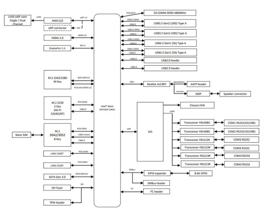

Intel Atom X7433RE Block Diagram
As described in the datasheet, the ASUS 3.5-inch SBC with Intel Atom X7433RE processor is a versatile and power-efficient solution designed for demanding industrial and embedded applications. The board’s triple display, multiple high-speed connections, and built-in AI, these features make it ideal for IoT, automation, and edge computing. With support for wide temperature ranges, dual LAN, and extensive expansion options, this SBC is well-suited for rugged environments and applications requiring reliable, low-power performance. You can easily integrate with its compact form factor, and genuine operating system (OS) support, which ensures flexibility and easy integration into various systems.
