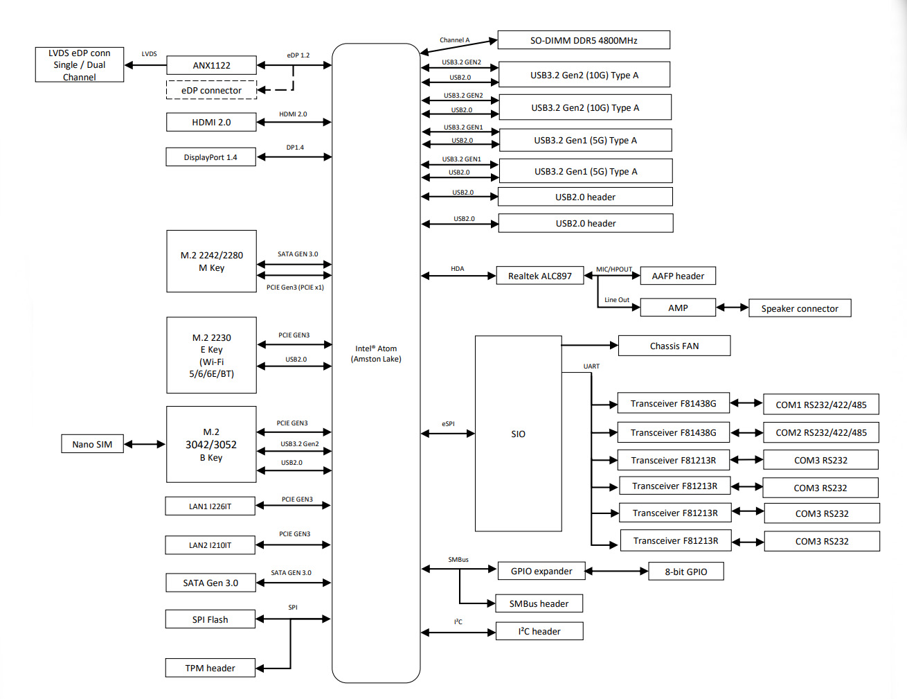

The X7433RE-IM-A 3.5-inch industrial SBC is designed for use in embedded systems and IoT edge devices. It features an Intel Atom X7433RE quad-core processor with integrated Intel UHD Graphics, supporting up to 16GB of DDR5 RAM and three 4K displays via HDMI, DisplayPort, and LVDS/eDP interfaces. Key features include dual Ethernet (2.5GbE and 1GbE), M.2 sockets for expansion with WiFi/Bluetooth, 4G/5G cellular, and SATA storage. It also offers robust security features like TPM, Intel Boot Guard, and Intel OS Guard. These features make this device suitable for applications requiring AI processing, industrial automation, edge computing, and networking solutions due to its compact size, processing power, and diverse connectivity options.

X7433RE-IM-A 3.5-inch industrial SBC Specification
  • Processor: Intel Atom x7433RE (Amston Lake)
    • 4 cores, 1.5 GHz base frequency, up to 3.4 GHz Turbo frequency
    • 9W TDP
  • Memory:
    • DDR5-4800 SO-DIMM with In-Band ECC (IBECC)
    • Maximum 16GB
  • Graphics:
    • Integrated Intel® UHD Graphics
    • Triple display support: HDMI 2.0 (4K @ 60Hz) + DisplayPort 1.4 (4096×2304 @ 60Hz) + LVDS/eDP (1920×1080 @ 60Hz)
  • Storage:
    • 1 x SATA 3.0 (6Gb/s) port
    • M.2 slots:
      • 1 x M.2 Socket 1 (E key, 2230) for Wi-Fi/Bluetooth
      • 1 x M.2 Socket 3 (M key, 2242/2280) for SATA SSDs
      • 1 x M.2 Socket 2 (B key, 3042/3052) for 4G/5G modules
  • Networking:
    • 2 x Gigabit Ethernet (Intel® i210IT, supports WOL/PXE)
    • 1 x 2.5 Gigabit Ethernet (Intel® i226IT, supports WOL/PXE)
  • Audio:
    • Realtek® ALC897 codec
    • 3W amplifier
  • Rear I/O:
    • 1 x HDMI 2.0
    • 1 x DisplayPort 1.4
    • 2 x USB 3.2 Gen 2 (10Gbps)
    • 2 x USB 3.2 Gen 1 (5Gbps)
    • 2 x RJ-45 (1GbE and 2.5GbE)
  • Internal Connectors:
    • 6 x Serial ports (2 x RS-232/422/485, 4 x RS-232)
    • 2 x USB 2.0
    • Chassis fan header (PWM/DC)
    • Chassis intrusion header
    • Front panel audio header
    • System panel header
    • Clear CMOS jumper
    • SATA power header
    • SMBus header
    • I²C header
    • 8-bit GPIO header
  • Security:
    • TPM header (SPI)
    • Intel® Platform Trust Technology (PTT)
    • Intel® OS Guard
    • Intel® Boot Guard
  • Power:
    • 9V-36V DC input
    • 4-pin power connector
  • Operating System Support:
    • Windows 10 (64-bit) / Windows 10 IoT Enterprise / Windows 11 IoT Enterprise
    • Linux distributions (Ubuntu, Red Hat Enterprise, Fedora Workstation)
  • Environmental:
    • Operating Temperature: -20°C to 70°C
    • Storage Temperature: -40°C to 85°C
    • Relative Humidity: 10% to 95%
  • Dimensions:
    • 146 mm x 105 mm (3.5-inch form factor)
  • Certifications:
    • Safety: CB, BSMI, CE-LVD
    • EMC: CE, FCC, VCCI, BSMI, RCM
    • Environmental: RoHS-compliant
