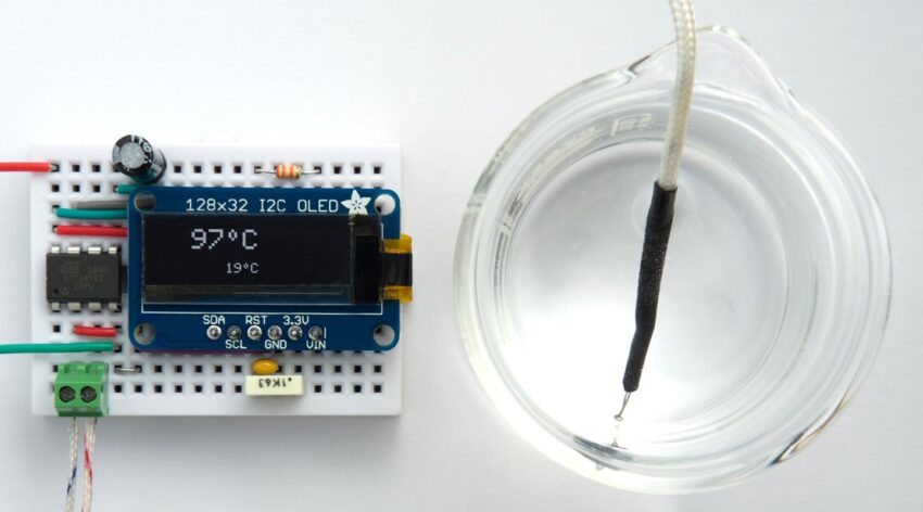

ATtiny85 Thermocouple Thermometer measures up to +1350°C
This project describes a thermocouple thermometer, capable of measuring temperatures up to +1350°C, using just an ATtiny85 and an OLED display. by David Johnson-Davies @ technoblogy.com It uses the ATtiny85's analogue-to-digital converter with a x20 gain option to measure the thermocouple voltag... Read More
