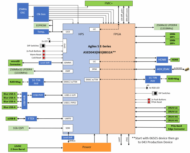

AXE5-EAGLE-ES: Block Diagram
AXE5-EAGLE-ES: a competent FPGA
One thing to highlight about this is the enhanced DSP with AI Tensor block. These specs allow the SoC FPGA to handle AI tasks and Digital Signal Processing (DSP) efficiently. This feature makes it perfect for machine learning, image processing, and other AI-related work.
The AXE5-EAGLE-ES has the first asymmetric processor system that merges 2 high-performance Arm Cortex-A76 cores with 2 energy-efficient Cortex A-55 cores. This feature permits ultimate performance and power efficiency which makes it easier to handle different types of workloads.  It has better speed and flexibility due to the use of Intel’s second-generation Hyperflex FPGA architecture. They provide high-speed data transfer transceivers reaching up to 28.1Gbps, and PCle 4.0×8 is used for fast connectivity. Both DDR4 and LPDDR4/5 work on this board because of its built-in memory controllers. It also contains general-purpose I/O pins that operate at voltages ranging from 1.05V to 3.3V.

The LPDDR4 helps in the storage because of the storage options like microSD card and SPI Flash and offers maximum connectivity including HDMI, USB 3. x, two Ethernet ports, PCle 4.0, and 10Gb Ethernet via SFP+ connectors. It is suitable for projects that require speed, performance, and expandability, as well as easy programming and error-solving processes due to its power of 12V.
Arrow’s AXE5-Eagle-ES Devkit is a robust solution for developers interested in exploring the Agilex 5 E FPGA’s features and accelerating their project timelines. Equipped with FMC and CRUVI LS/HS connectors, this devkit enables seamless integration with various adapter boards, broadening its application potential. Arrow also offers Linux support to streamline development on the platform. For programming and debugging, the kit includes the Arrow USB Programmer2, further simplifying the setup.
