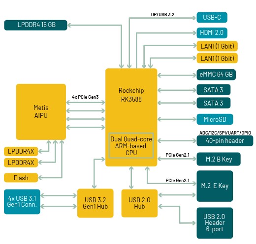

Axelera AI has introduced the Metis Compute Board, a compact SBC designed for edge AI applications. It features the Rockchip RK3588 processor, combining Cortex-A76 cores for high performance and Cortex-A55 cores for power efficiency.
The board integrates the Metis AI accelerator with a four-lane PCIe connection to the CPU, enabling high-speed AI inference. With 16GB of LPDDR4 memory, it supports multi-stream and multi-model workloads, making it suitable for computationally intensive AI tasks at the edge.

Metis Compute Board with Metis AI accelerator block diagram
The Metis Compute Board is designed for energy-efficient operation and offers multiple connectivity options. It features 64GB of onboard eMMC storage, two SATA ports, and a microSD slot for expanded storage. Networking is handled by two Gigabit Ethernet ports, while peripheral connectivity includes four USB 3.1 Gen1 ports, one USB-C port, and three USB 2.0 headers. Additional interfaces such as UART, I2C, and GPIOs enable easy integration with sensors and other peripherals.

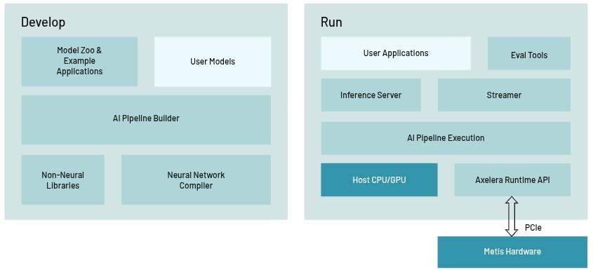

The Metis Compute Board is a complete AI acceleration system featuring the Voyager SDK, which streamlines application development. The SDK includes tools for AI model deployment and inference optimization, with support for TensorFlow, PyTorch, and ONNX. It also offers compiler features for automatic quantization and graph optimization to improve performance.

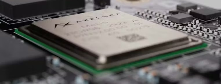

Built on a RISC-V-based architecture with D-IMC (digital in-memory compute), the Metis platform is designed for efficient AI processing. Axelera AI provides a model zoo with pre-trained models for image classification, object detection, segmentation, and pose estimation, enabling support for complex neural networks.
