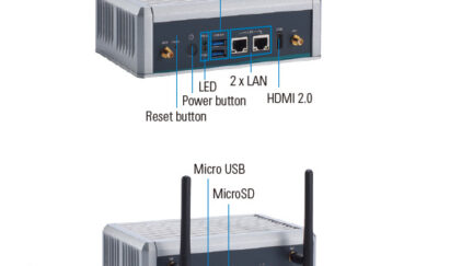

Axiomtek’s AIE100-903-FL has rich I/O interfaces, including one USB 3.0 port, one USB 2.0 port, one Micro USB port, one GbE LAN, one GbE PoE and one HDMI 2.0 with 4K2K supported. It also has one recovery switch, one reset button, one power button, one 12 VDC power input and two SMA-type antenna openings. Users can use the recovery switch and Micro USB to flash the image without opening the chassis. The AIE100-903-FL has a 16GB eMMC onboard via the Jetson Nano. It is also equipped with one M.2 Key M 2280 slot and one Micro SD slot for massive data processing. Besides, this reliable embedded system has one full-size PCI Express Mini Card slot and one SIM slot for 3G/4G, GPS, Wi-Fi and Bluetooth connections.
