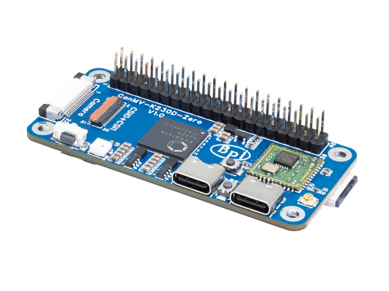

Banana Pi has launched the BPI-CanMV-K230D-Zero, a compact single-board computer with a Raspberry Pi Zero footprint, tailored for low-power machine learning and AI applications at the edge. It is powered by the Kendryte K230D dual-core RISC-V processor, featuring a 1.6GHz primary core and an 800MHz secondary core. The SoC integrates a third-generation Knowledge Process Unit (KPU) that supports AI inference with INT8 and INT16 data types, enabling compatibility with neural networks such as ResNet50, MobileNet_V2, and YOLOv5s.
The board is equipped with 128MB of LPDDR4 RAM running at 2666Mbps to support efficient local AI computation. It features dual MIPI-CSI camera inputs with 4K resolution capabilities, making it well-suited for computer vision and AI-based image processing tasks. Designed for embedded systems and DIY projects, the BPI-CanMV-K230D-Zero provides a lightweight and efficient solution for localized AI inference.

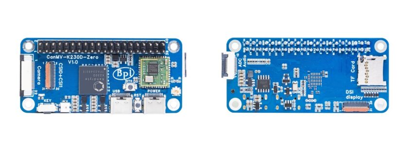

Banana Pi BPI-CanMV-K230D-Zero front and back

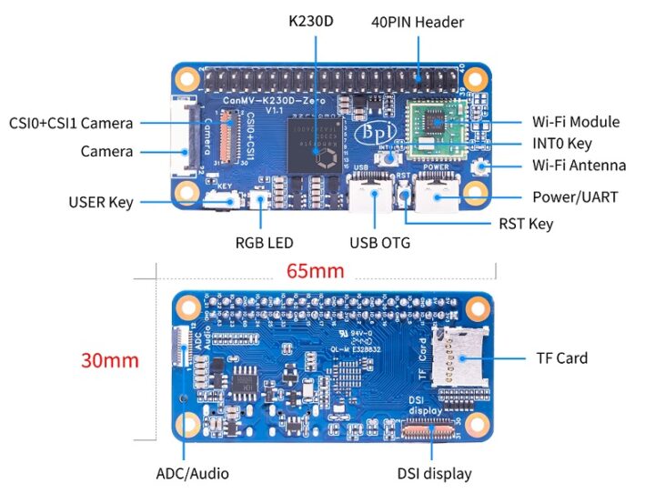

Banana Pi BPI-CanMV-K230D-Zero Specifications:
  • SoC: Kendryte K230D
  • CPU:
  • CPU1: 64-bit RISC-V processor @ 1.6GHz with RVV 1.0 support
  • CPU2: 64-bit RISC-V processor @ 800MHz
  • System Memory: 128MB LPDDR4 RAM @ 2666Mbps
  • Storage: MicroSD card slot, supports up to 1TB
  • KPU: Third-generation KPU, supports various data types such as INT8/INT16; Typical network performance: Restnet50>=85fp@INT8, Mobilenet_V2>=670fps@INT8; YoloV5s >= 38fps@INT8
  • DPU: Built-in 3D structured light depth engine, maximum up to 1920×1080
  • VPU: Video encoding/decoding for H.264/H.265 hardware encoder/decoder
  • Camera: 1x 2-lane MIPI-CSI connector, 1x 4-lane MIPI-CSI connector; max resolution up to 4K
  • Display: MIPI DSI interface up to 1080p
  • Audio: ADC/Audio FPC connector
  • USB: USB 2.0 OTG Type-C port
  • Networking: Supports 2.4GHz Wi-Fi (1x Wi-Fi Antenna)
  • Debugging: USB Type-C port for serial console (and power)
  • Expansion: 40-pin GPIO header which supports I2C/UART/I2S/SPI/PWM/ADC/JTAG
  • Misc: 1x USER Key, 1x Reset button, 1x RGB LED, 1x Power/UART Button, 1x INT0 Key
  • Power Supply: USB Type-C 5V@2A
  • Dimensions (L x W x H): 65 mm x 30 mm x 7 mm

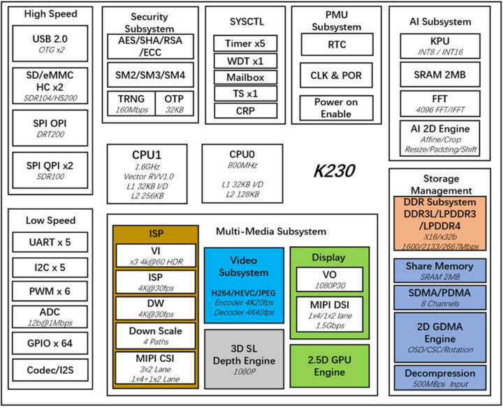

K230 block diagram
Kendryte K230 block diagram
